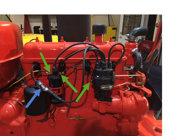

Guys, I need a little help please. I re-wired my D10 during restoration and now I have no spark and I don't really understand how the coil works. Looking at the pic below I have juice to all the green arrows when I turn the ignition on but I get no spark on the in-line tester (yes it's working) at the blue arrow. Am I missing something or does anyone have any advice?
BTW - Should I see voltage coming out the top of the coil? I currently don't see any with my cheap light tester.

Just make sure you haven't overlooked something. Rotary button, points and condenser.HTH Tracy

'points' are NOT closing. Wrong gap( too wide) or insulating corrosion on points. To prove this ,turn ign on, take a wire and connect it to distributor points wire( last green arrow) and touch to ground.This 'mimics' what happens when the engine rotates and opens and closes the points. Each time you 'ground' you should get a spark from the high voltage center terminal of the coil.Simply take center lead of coil and place near engine metal about 1/4". Bright blue spark should happen every time you ground the coil.
if you have an ammeter, it should read about 4 amps when the points close.

Post Options Post Options   Thanks (0) Thanks(0)   Quote CTuckerNWIL Quote  Post ReplyReply Direct Link To This Post Posted: 25 Sep 2016 at 8:06pm
Is there voltage to those 3 points when the ignition switch is turned to the start position?

Did you change anything with new? Like the coil and especially the condenser. Doubt it could be the points, but you could put the old ones back in if it still doesn't fire. Let us know how it turns out so that we are able to help others. By the way, did you put the coil back on the right way?

I just checked and there is indeed power in and out of the coil while turning it over. I opened up the distributor and I see a white film type substance on the points. I am no genius at this but I am betting those things are supposed to be a shiny surface to allow electricity to pass through them four times every rotation. It looks very much like a ceramic coating on the surfaces. The tractor ran 1 year ago before I started the restoration so that isn't much time to corrode but I guess it's possible. I will replace the condenser and point but does anyone know of a good way to clean these without removing them? I would like to know this is the issue.

A test with the tester while cranking with the test light on either end of the wire between the coil and the distributor is that as the engine cranks that light must blink on and off. If it stays on the points are not making contact either from corrosion or the point gap being set wrong. When the points open and close there will be way too much voltage on the top of the coil for your tester.
Changing the point gap also changes the ignition timing so set the gap first then the timing.

Gerald after reading your message I am almost certain that it is the points. I know the light on my tester does not blink when attached to the last green arrow and it is turning over. I set the initial timing by reading the instructions on the manual (getting it close). I was kind of figuring on rotating the distributor a little by hand until it sounded right. What is the correct way to establish timing?

Guys, I cleaned my points with a soft and tiny wire brush on the end of my Dremel and all is well. My electric light flashed when turning it over (with the tester on the lead) and then I put it together and there was indeed a spark in the wire.
I will go and test point gap per the manual but I am quite pleased with getting a spark.

Actually, the bestest points cleaner is TV tuner cleaner or Brakekleen. Taking a file to the points just removes the cad plating that's on the points to protect them from corrosion. Once the Cad plating is removed, the points will oxidize much faster, and cleaning them will become a common thing unless changed out with new. Either cleaner will remove the oxidation and ozone from the contacts without hurting the Cad plating, and wiping a corner of a rag through the contacts after a little spritz is all that's needed to get current flowing again. A file has been a bad idea right from jump street ages ago... HTH

What Steve said. Also, do you still have voltage at the points when they are closed and the ignition is on? If not, then your problem is not with your points. If you do not have voltage when the points are open your problem could be the condenser, the coil, or a connection anywhere in the circuit.
