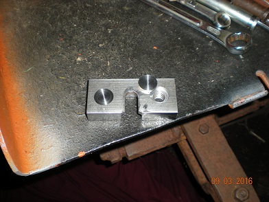

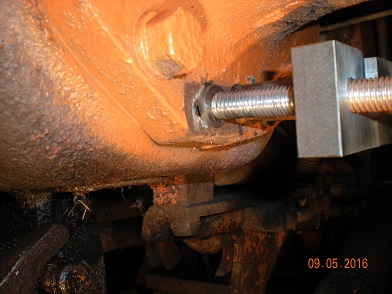

   Any way I would say they would work I didn't buy one but made my own.
I recently did the brakes on my WD,

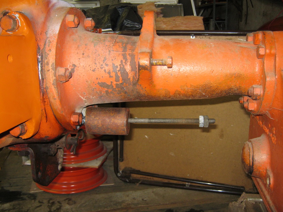

I just pulled one brake pin out, w/ a puller I made. Took me about 2 hours to get it out. I quickly found after slamming the weight , I couldn't move the brake shoes. So I moved them both back and forth. Then slam the weight 3 or 4 times, then loosen brakes again. I just kept doing that till it came out. I did use a torch w/ mapp gas at first. There is a lot of steel around that pin. So I don't know how effective that was.  I have $18.00 in the puller.

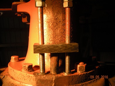

What I did on mine was weld a 1/2" grade 8 bolt about as long as the pin to the head of the pin. Next a piece of pipe slipped over the bolt with an old harmonic damper bolt washer, my lug nut installing thrust bearing and pulled them quickly and easily. As much pressure as it took to pull them, I'm certain it would have been quite a battle any other way.
