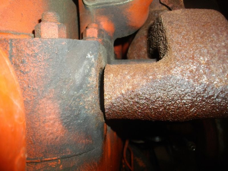

Here's a couple'a pictures of it... this is a pretty big gap...

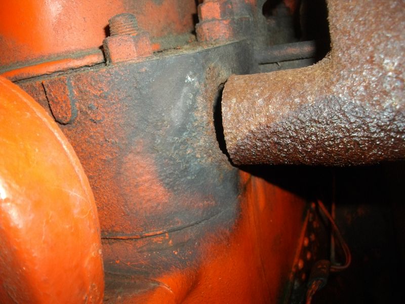

and here:

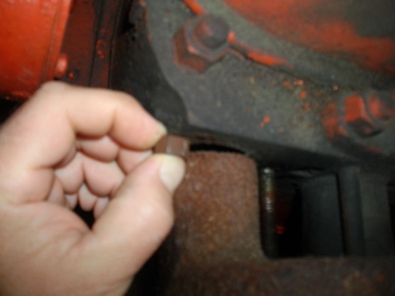

And for perspective... this is one of the manifold nuts...

Mine looked that bad also. The reason it looks so bad is because the gaskets are awfully thick. You won't need as much fill as you think. I just used the wire feed to speck in a couple of bad pits and then sanded a little. Not 100 percent right but it was what worked at the time. Mine was the same port.

I can't contribute to this discussion but have a question. Is there supposed to be a built-up ridge on the head where the manifold opening meets the head? Or is the side of the head flat? Thanks.

I'd still plane the manifold. Did you lay a straight edge across the manifold? I bet that would close the gap up some. Then build the head up with weld and plane it smooth. That worked for me.

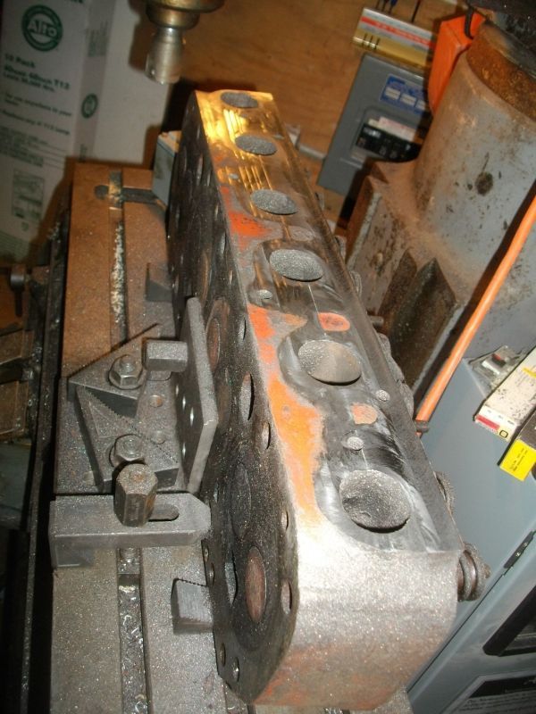

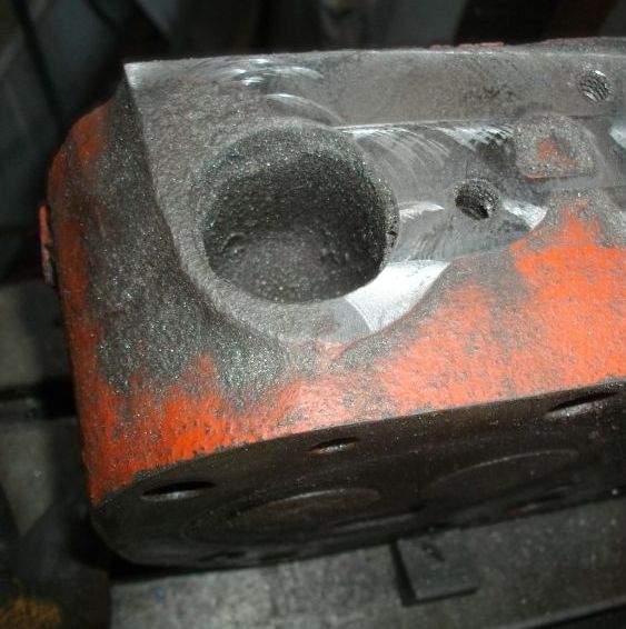

Since then, I've cleaned it off, milled the manifold face flat (took off a whole lot!), scrubbed it again, dropped, cleaned, lapped, and reinstalled each valve, and then took a pair of vise-grips and more penetrant to the studs... got most of 'em out, then spun/wire brushed 'em clean, reinserted.
Gotta make a new pair'a gaskets for the water neck, and reassemble... tomorrow's a busy day already, so probably figure on lighting it up on Wednesday or so. Here's a few pix:
Yeah, this flycutter is a bit small for making this pass... and I'm slightly out-of-tram. I made this flycutter about ten years ago, and I should make a few more, probably about 4" diameter would be right... but the lines you see constitute less than a thou... probably more due to deflection (spindle and knee) than tram error.

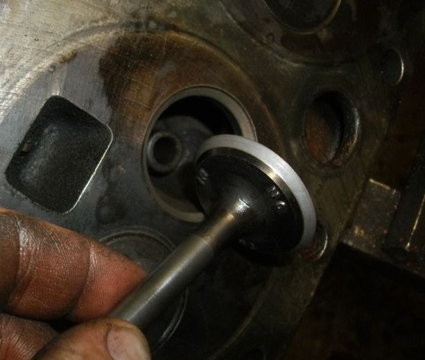

And a few more:

Valve grind looks good! You certainly are having fun.......

Yes- these valves were in really good shape- what you see there is simply a few minutes with some lapping compound and a sucker-stick.   These ex valves don't have rotators- wish I had four, I'd've put 'em on, but they can be done later.
When I get this job done, I'm gonna start scouting for materials to make a larger flycutter... I could've easily cut the milling-time in half or less with a one-pass tool.
