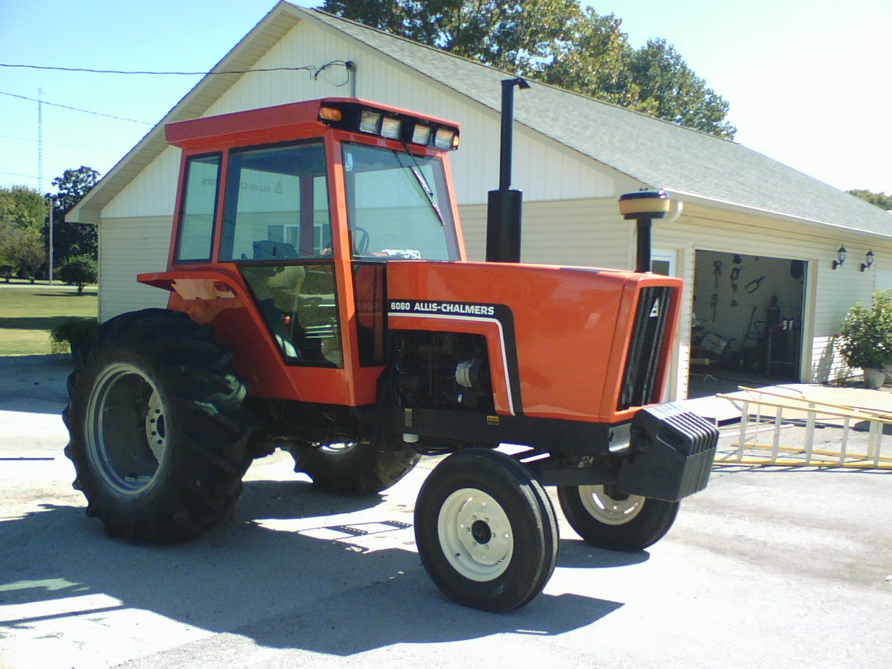

Post Options Post Options   Thanks (0) Thanks(0)   Quote Charlie175 Quote  Post ReplyReply Direct Link To This Post Posted: 24 Jun 2016 at 9:04am
Pic for reference
Charlie
