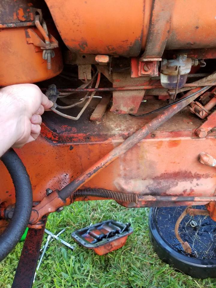

I am trying to troubleshoot my lift system when I found this arm. There is no linkage hooked to it. I removed the round cover on the side of the case and the arm definitely does engage a gear. What does it do and should it be hooked up? Thanks.

The lever engages the belt pulley if equip'd.  The round cover is where the belt pulley mounts.

Yes lever to engage the belt pulley.  There would be a rod and handle coming through the dash at the lower right. Looks like your having some issues with a cover off the underside?

What went wrong with the lift? Inside the cover you have at the bottom of that photo is the piston pump. They are know to get plugged up with gunk you will want to clean it up good before you reinstall it.
How is the oil in the transmission? There is a hose that runs through the rearend that can go bad and will overfill the transmission with the hydraulic oil from your lift system it is the supply line to the cylinder.
There could also be something up with the Draft control system but before anyone can give advice on that we would really need to know what was the original issue.
