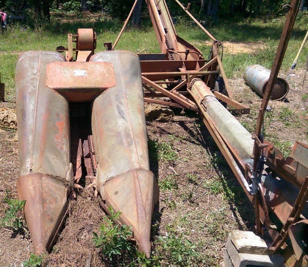

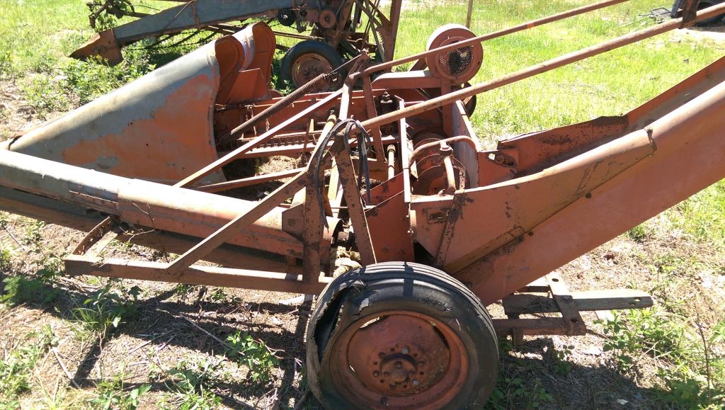

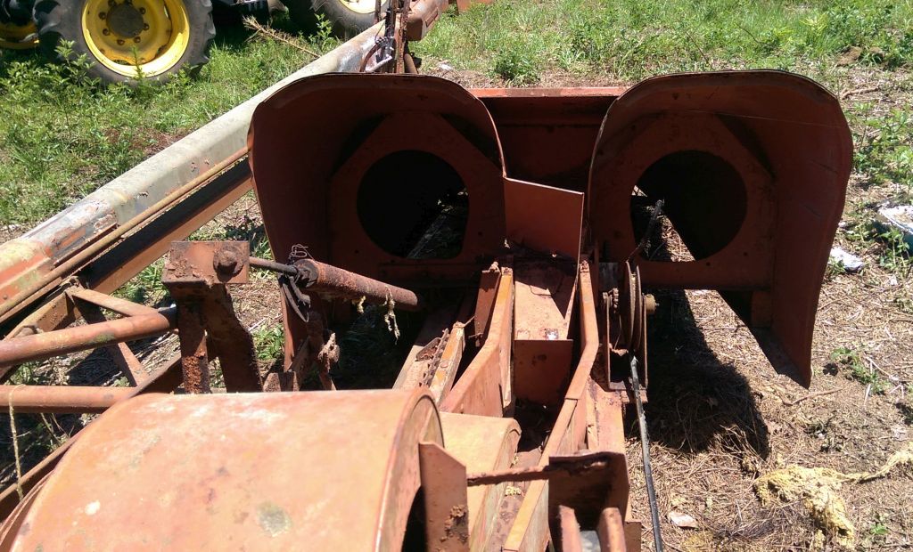

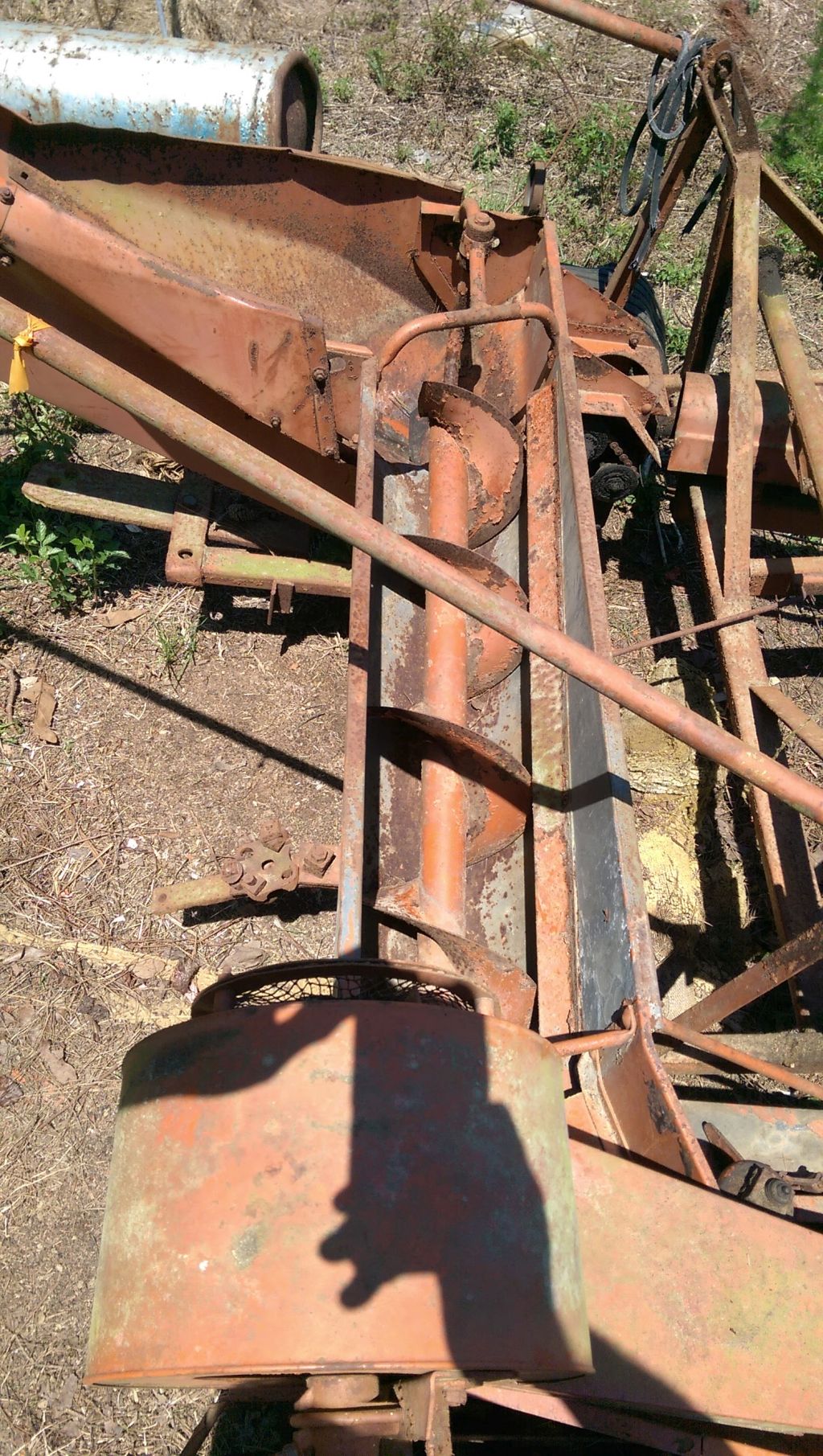

I have a AC Corn Harvester 35 that has spent the last 35 or so years under an open side pole barn on my fathers property. For some reason he thought is worthwhile to shield from the elements while other equipment that he used was left to the full force of Mother Natures sun and rain. Tires are past dry rotted and belts are shot but otherwise unit seems complete. Any advice on what can be done to check it further ?

looks like it's in pretty good condition, wonder how hard it would be to find the belts that could/would run it?

I see a blower but I don't see any husking rolls. Are they located just behind the snapping rolls or doesn't it have husking rolls?

appears it uses the larger flat gathering chains like on the older corn heads. they are stil available. appears there are also snapping rolls on it also! I've never seen one of these before, i'm guessing not many around! DON'T SCRAP IT! it's rare!

i'm with Doug on the husking rolls too! and maybe a chain missing that carries the ears back to the cross auger? that is one neat machine!

the extra hitch behind, must have pulled something to knock the stalks down behind?

The hitch on back is for pulling a wagon, SHAMELESS. The wagon is then pulled to the crib where it is unloaded via an Armstrong wagon unloader.

that appears to be just a snapper, not a husker. Dads old case had a hitch centered like that, it was used to pull the wagon down the road, that way you did not take up the whole road. That hitchs shorter than the one on dads, if you put a wagon behind it I wonder if the elevator would clear the wagon when turning?

Tom is right  It's a snapper, not a husker.

I didn't think about wagon transport hitch, I saw the main hitch for field use.

None of these had husking beds on them. They were both snapper and husker models, but even the huskers only had 2 rolls that the corn rode up and back on it's way to the cross auger. From what I"ve seen, they really didn't husk much. Now that the rubber is all hard and dry, I bet the husk even less. They are not very big and would be trailerable.

 The snapping rolls are the husking rolls. Some had little rubber plugs to help husk.

These did have somewhat of a husking capability. There are a bunch of rubber buttons in the snapping rolls. I had one of these at one time but have since sold it. I had collected enough NOS rubber plugs to restore the husking ability. It looked to be quite a project to take the rolls apart and replace the plugs. All the picker NOS parts I had went to the new owner. I will look to see if I still may have a parts book.

Jim, Please excuse my ignorance but I'm not sure if the rolls you are referring to are actually part of the Harvester or if they are separate.  If they are part of the unit point me in the right direction and I'll get pictures. If they are add on I'm pretty sure I don't have have them.

 The rolls are on the machine now. The front half snapped the ear off the stalk and the back half did what little husking it could depending on if it had the rubber buttons or not.
The spring loaded door between the front and back was to hold the ear down against the rolls so it could husk a bit. The problem with that area in corn today, is when you have 10 foot tall stalks and the stalk breaks off above the ear and doesn't get pull down by the snapping rolls. It will jam up in that little 4 inch square hole it has to get thru.
 Some later pickers had a set of fingers in the middle of the rolls ( kinda like chicken plucker fingers) to pull any stalk and leaves thru so it can be ejected out the back.
