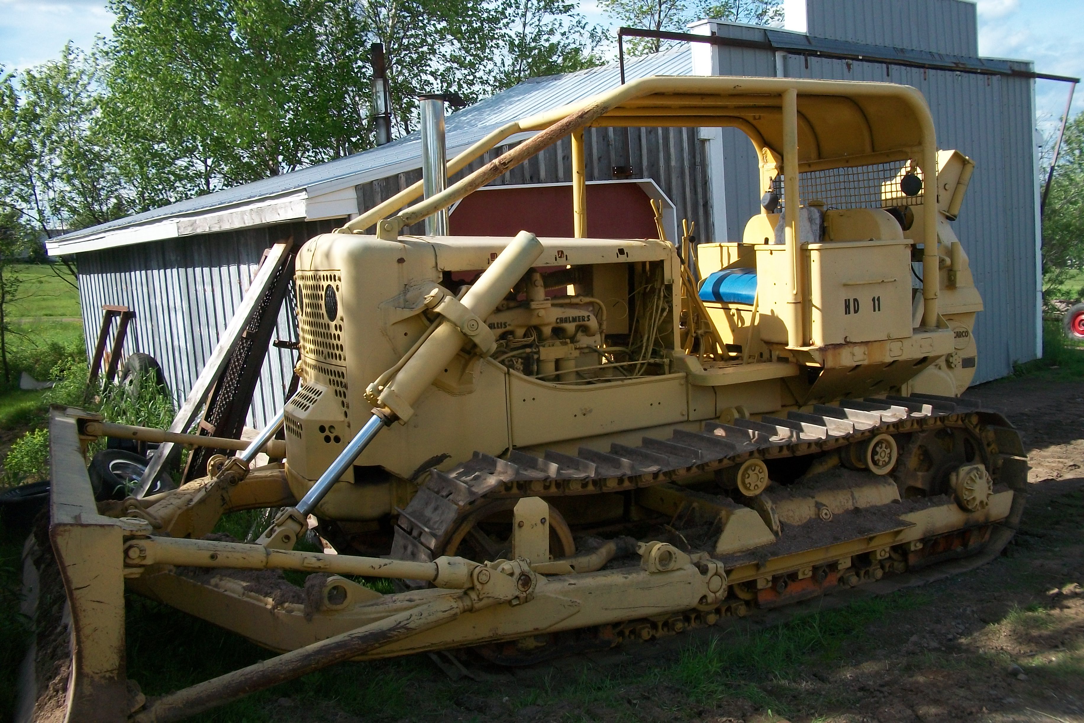

I HAVE AN HD11F. THE TRACTOR HAS AN 11000 ENGINE IN IT. IT HAS AN AMERICAN BOSH INJECTION PUMP. FUEL IS LEAKING INTO BASE OF ENGINE. ANYONE ELSE HAD THIS PROBLEM AND HOW TO FIX. THANKS.

transfer pump seal is bad, leaking fuel into lubed side of pump and going back to engine?  or leaking onto the outside?

Post Options Post Options   Thanks (0) Thanks(0)   Quote R.KYLE Quote  Post ReplyReply Direct Link To This Post Posted: 30 Nov 2015 at 8:38pm
LEAKING INSIDE. DOES PUMP HAVE TO BE REMOVED?

transfer pump bolts to outside of psb pump  i had a 7000 engine that was doing this

THIS IS NOT COVERED IN THE BOOK I HAVE BUT I DO HAVE A DIGIRAM OF PUMP. IT LOOKS LIKE THE SUPLY PUMP CAN BE TAKEN OFF WITHOUT REMOVING INJECTION PUMP FROM ENGINE AND GETTING INTO PUMP TIMING. ALSO WONDERING WHERE TO ORDER SEALS. ANY HELP THANKS.

Been here with an AC 45 grader.
You can take the transfer pump off without removing the injection pump.  And the seal on the transfer pump shaft ours was just a standard industrial seal.

JUST AN UPDATE. GOT A NEW PUMP FROM JOBBERSINC .COM. TRACTOR IS RUNNING AGAIN AND WORKING FINE. THANKS EVERY ONE FOR HELP.
