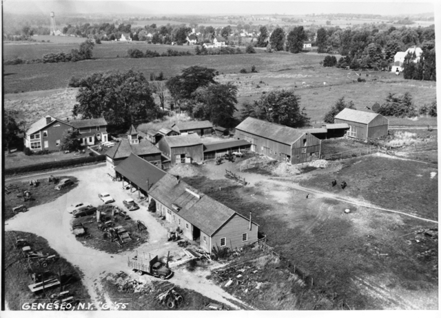

Bill, your description of how the rotobaler came from the factory reminded me of seeing them that way at my families AC dealership.
Here is an an arial photo of the business dated 1955 and their is one sitting in the oval area in front of the shop.

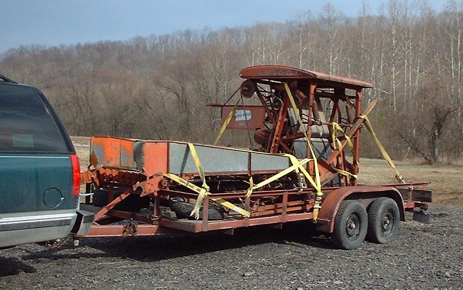

Chuck, I did this a few years ago.  A guy was supposed to show up with a backhoe to help load, but never showed up.  Like the others had mentioned, I studied the way Allis shipped them broken down on rail cars.  Two people, standard tools, two floor jacks, one dog (I don't know what the hell for) and 2 1/2 hours work.  Knowing how, you can knock an hour off that.  I did a photo journal of the stages if you want, I can email it to you.  Or use this link
http://public.fotki.com/dave994/roto-baler/

Dave, thank you so much for sending me the information.   It gives me a good idea of what I am looking at.   This guy has two of them, but I think I am going to have my hands full just getting one home.  How much does a rotobaler weigh complete?
Post Options Post Options   Thanks (0) Thanks(0)   Quote CTuckerNWIL Quote  Post ReplyReply Direct Link To This Post Posted: 26 Apr 2010 at 6:45pm
Dave, Great pictorial.
