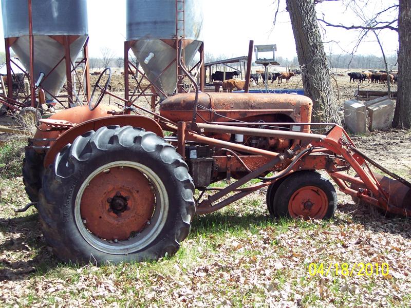

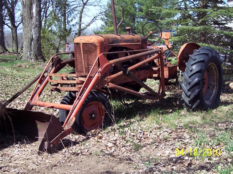

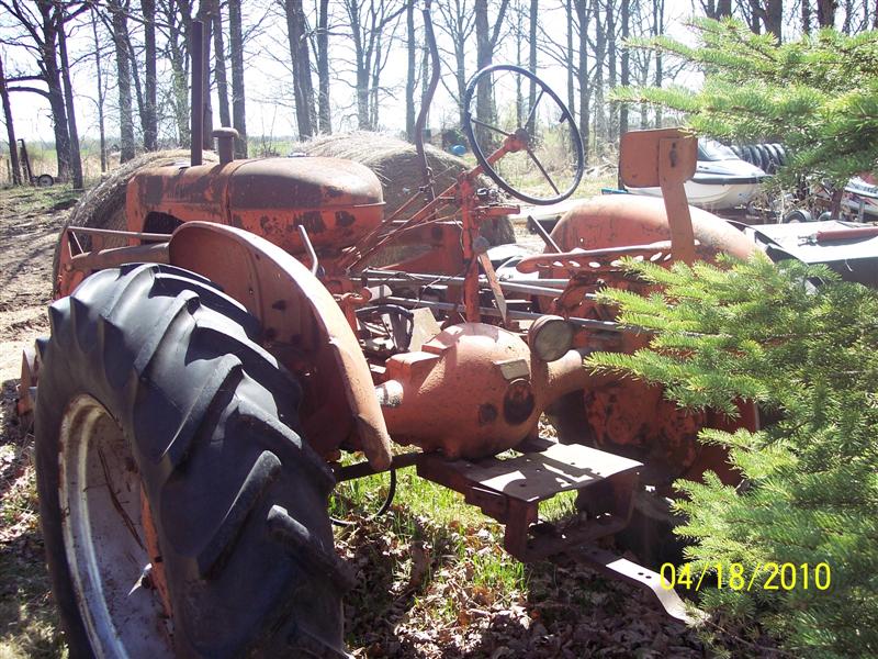

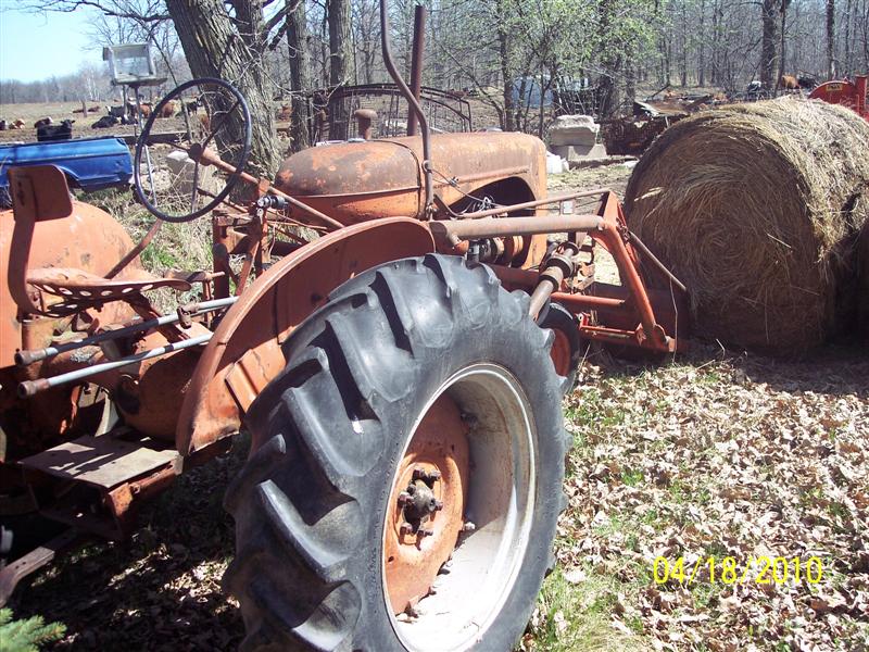

Hi all!
The deal is done, and Dad is on his way home with my latest addition to the barn!  A 1941 styled WC.  Serial number WC 103706
I "bought" it last weekend, but didn't want to say anything until in was in my possession.  Just in case the deal went south.
Her story:
Guy got it on trade for some feed, used it a little, but not really.  Needs some TLC like most antique tractors do, so it was put up for sale last fall/winter.  Guy drove it outside, because he needed room in the barn, parked it where it sets.  Buyer never showed, winter came and went.  Guy put it up for sale again, I call and ask about it last weekend, and the rest is history.
Currently doesn't run, but hopefully will.  Not stuck, Dad and his buddy rocked it back and forth and the fan spun.  bad news is it has a cracked block behind the carb Dad says (guy didn't even know, he didn't really know anything about the tractor).  Holds water though, someone must have put some type of leak stop in it.
Two of the rims are rough, a front and a rear.
Original mag and generator have been converted to distributor and alternator.
Normal dings and dents, but overall complete.
Has a WD 9 loader on it, which I will probably take off and put on my WD, since this is an actual Allis loader, and the one that is on the WD is not an Alllis one.
Here are the 4 pics I have so far:
Dad used the negatives of it to dicker him down to 350$, which I was happy to hear!  He was asking 500$.
Anyone know anything about the front mounted hydrolic pump and guard?
Oh, and we're calling this one "Molly", no reason really, my sister just asked if this one was a boy or a girl and if it had a name.  I said I didn't know yet.  She said how about Molly?  Why Molly I asked?  That's just the first name I thought of she replied!  OK then, Molly it is....  LOL!
I'll keep you all updated, all comments welcome!

It looks like it has a 2N/8N/9N Ford grille guard in the front. Necessity is the mother of invention. That's an interesting installation, but it fills the need.

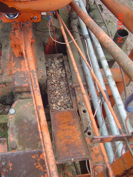

This is where you hide your nuts! LOL!  What bolted to the two holes in the right frame rail top next to the toolbox lid in this pic?  There was a shim there.

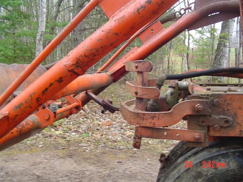

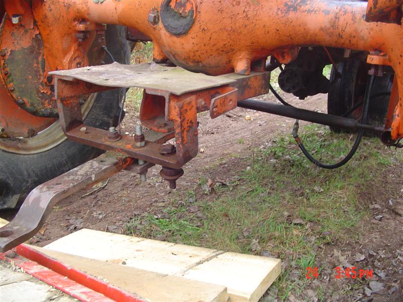

Notice the handy-dandy flip up bracket to hold the loader up when the tractor doesn't run....

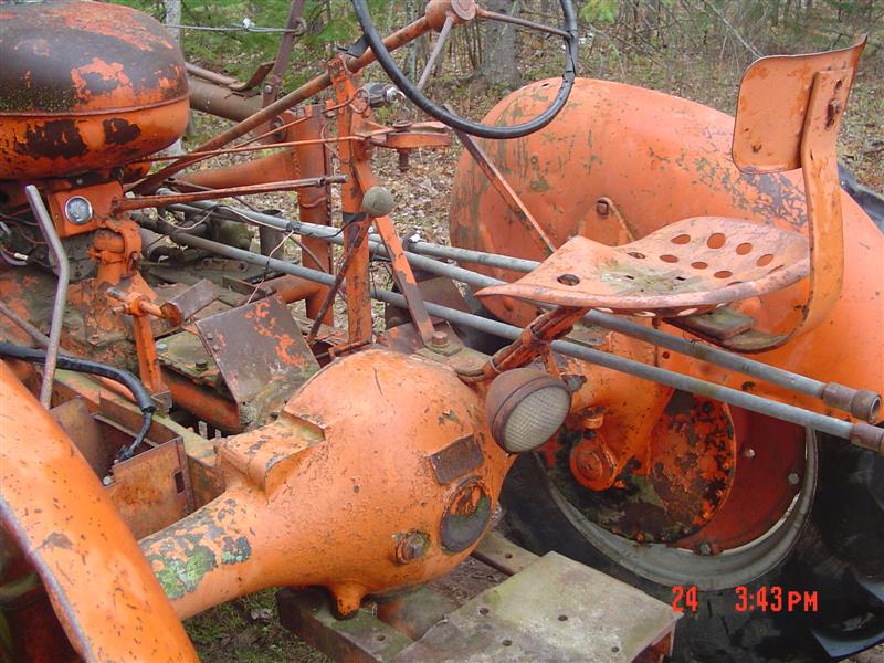

Are the brackets around the base of the shift lever where it goes into the shift tower normal?  I guess I never noticed this before, I have a lot to learn about WC's though...

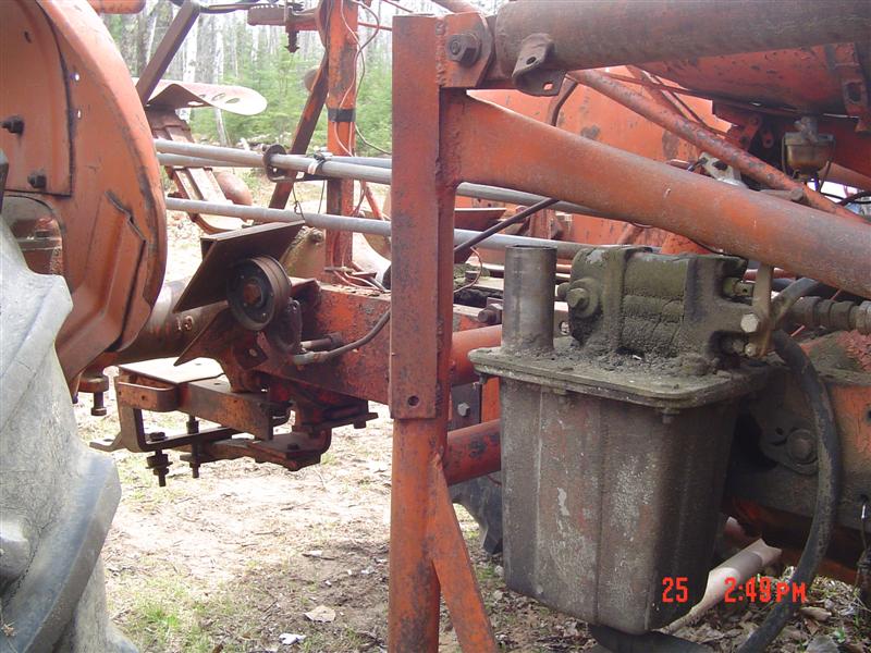

What is supposed to be what in this area?  How should the PTO be?

The two holes in the right frame rail are to mount the outer support for the power lift which installed on the rear end disconnect box in the driveline just to the left of the two holes.
PTO shaft runs from the PTO through a support bearing which mounts on the two bolt holes on the rear platform.

The pice on the gearshift leaver and tower is a Tractor Supply addon to repaire the warn out leaver and make it easyer to shiht gears.

I thought the two holes in the frame might be for the power lift after I got to thinking about it, so this tractor must have had one, that got robbed at one point in the not so distant past.

Ah, a worn out shifter-fixer, OK!  I thought that looked out of place for an Allis.  I'll have to pull the shift tower and see whats what in there.  Having done that on Wayne, we ain't a skert to tackle that project now, LOL!

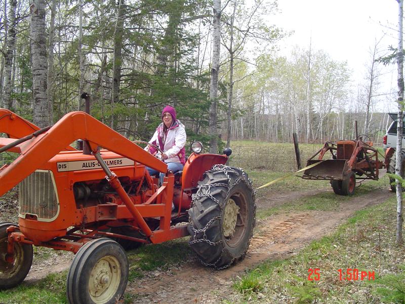

Hi all,
Yet a couple more pics from this afternoon.  Mom and Dad had some fun towing Molly back to the barn with Albert.  Mom needs some practice running the tractor I guess, LOL!  I'll spare you the details....
But Molly is back with the others, though not without hesitation.  She dropped her loader a couple of times along the way (remember the loader holder-upper bracket? well, it flips down sometimes....).  Seems this is a recurring theme with the last few tractor, they are stubborn to meet their new friends.

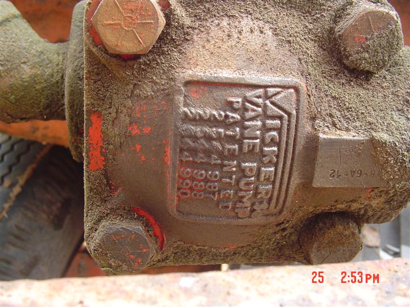

And here is a pic of the front pump.  Anyone know anything about it?
