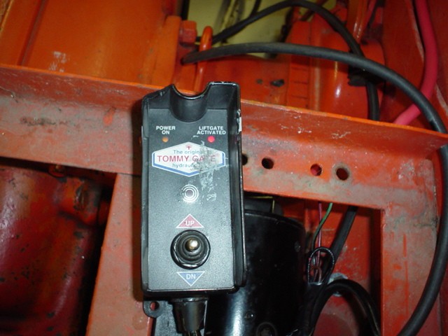

Well since I have an alternator devoted to only charging the battery for the starter I decided to install "Live" electric hydraulics on my C. I found a used Tommy Gate pump and controller and made a bracket for it and put it under the seat.
Works great but I had one problem at first. The electric switch is either full up or full return. It raised fast and dropped even faster. I though I was going to ruin my deck the first time it slammed down. I couldn"t ease into it like a normal spool valve. So I installed a needle valve flow restrictor that restricts both ways and now it works perfectly and the flow rate is adjustable too.
