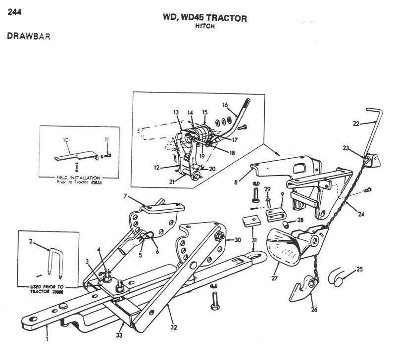

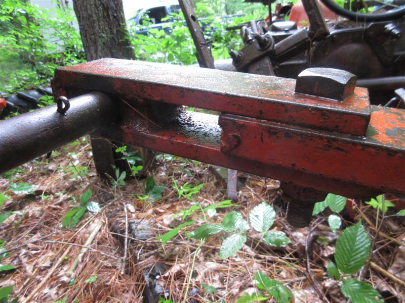

The drawbar and clevis Fred pictures is slightly different than the WD.
The original is a very simple loop of heavy strap iron.
My Dad's WD came with out a drawbar and he fashinoned his own
Not having a torch, he welded up one.
Altho it never gave us a problem, his loop should have been shorter.

The WD didn't come with a snap coupler hitch. It was equipped with the pin hitch as previously illustrated. You could easily fabricate an adapter to bolt to the front of your draw bar as also shown. All you would need then is a bail to bolt the draw bar the the rear bar on your hitch. This would keep the draw bar from sliding around. LOL Bob

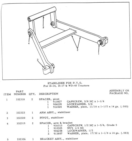

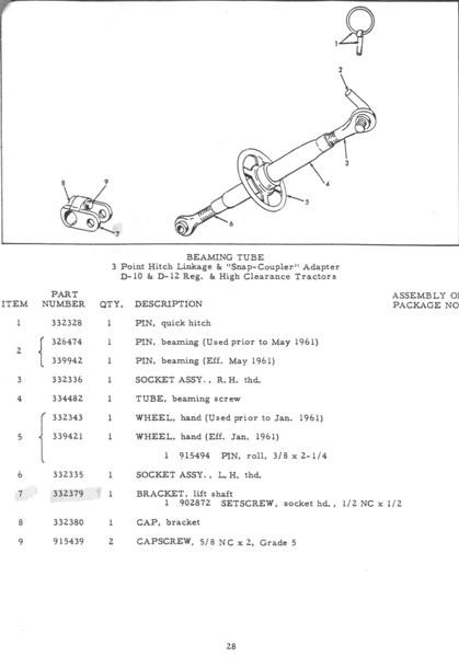

I went back and looked at your pictures.....amazingly, you do have an original top link bracket attached to the rocker shaft. A valuable item.
The one thing you don't appear to have is the top-link itself which has a wheel to turn it
rather than a pin like most after market top links.
The other thing you apparently don't have is the stabilizer.
Here are some pics of those items.

Man, it would have been cool to have all the original equipment. Are the stabilizers hard to find? Kinda hard to tell scale from that diagram.
