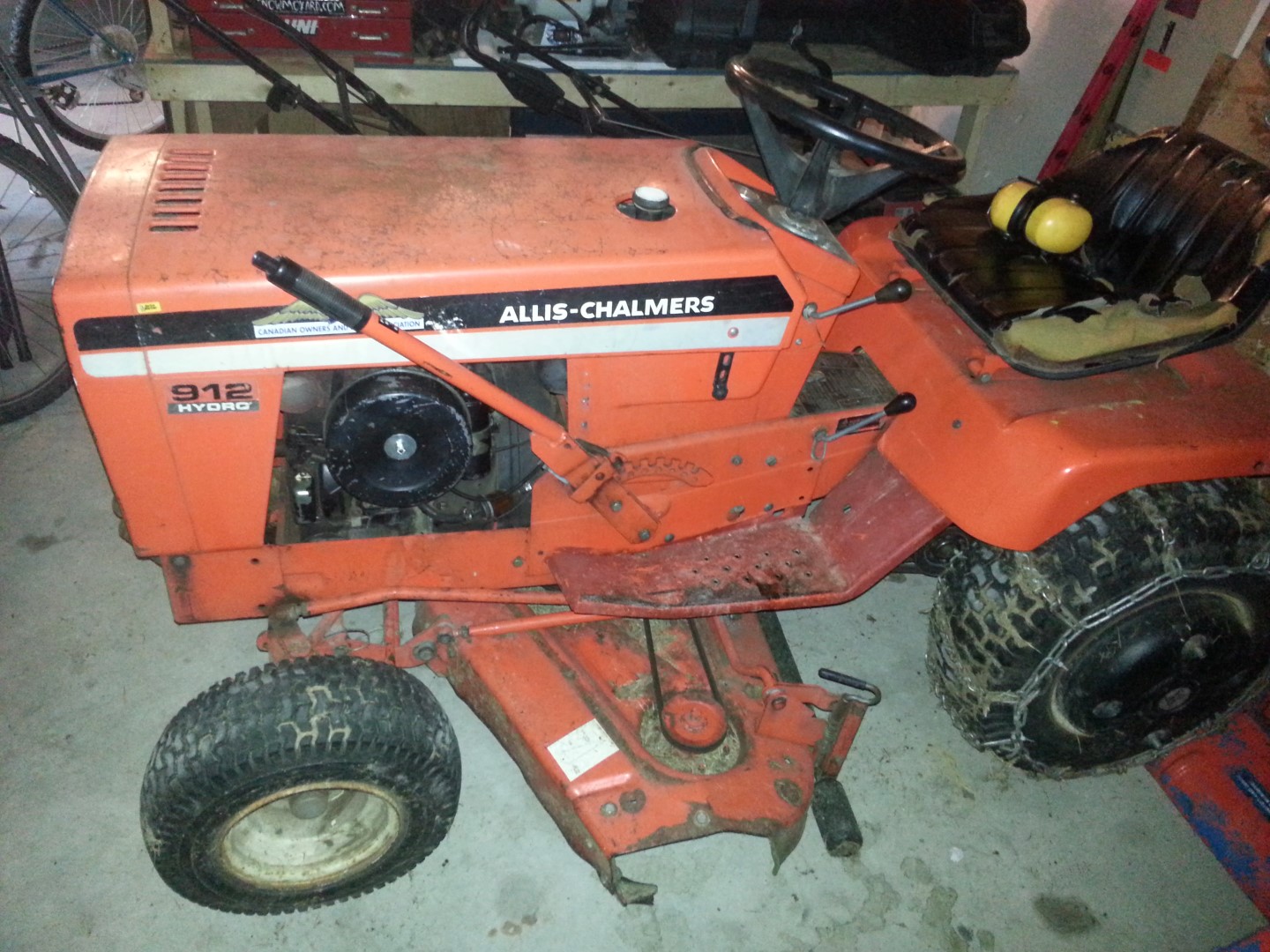

I have had the tractor for about 20 years, it has always run well.
I ran it this winter using the snow-blower about 20 hours and was cutting grass for about 2 hours this weekend (at full throttle the grass was wet and high)... when suddenly it began back firing through the carb and won't tolerate any load at all.
I limped back to the garage  and thinking I got a bit of garbage in the carb took it apart and cleaned it. I reset the idle and high speed screws at 2 turns out each but there was no improvement. The fuel is new, the plug is new....
When started from cold it idles nicely for about thirty seconds and then starts to burp and back fire, it can't take the load of moving without bucking and sounding awful.
I have done what I can....any ideas?
