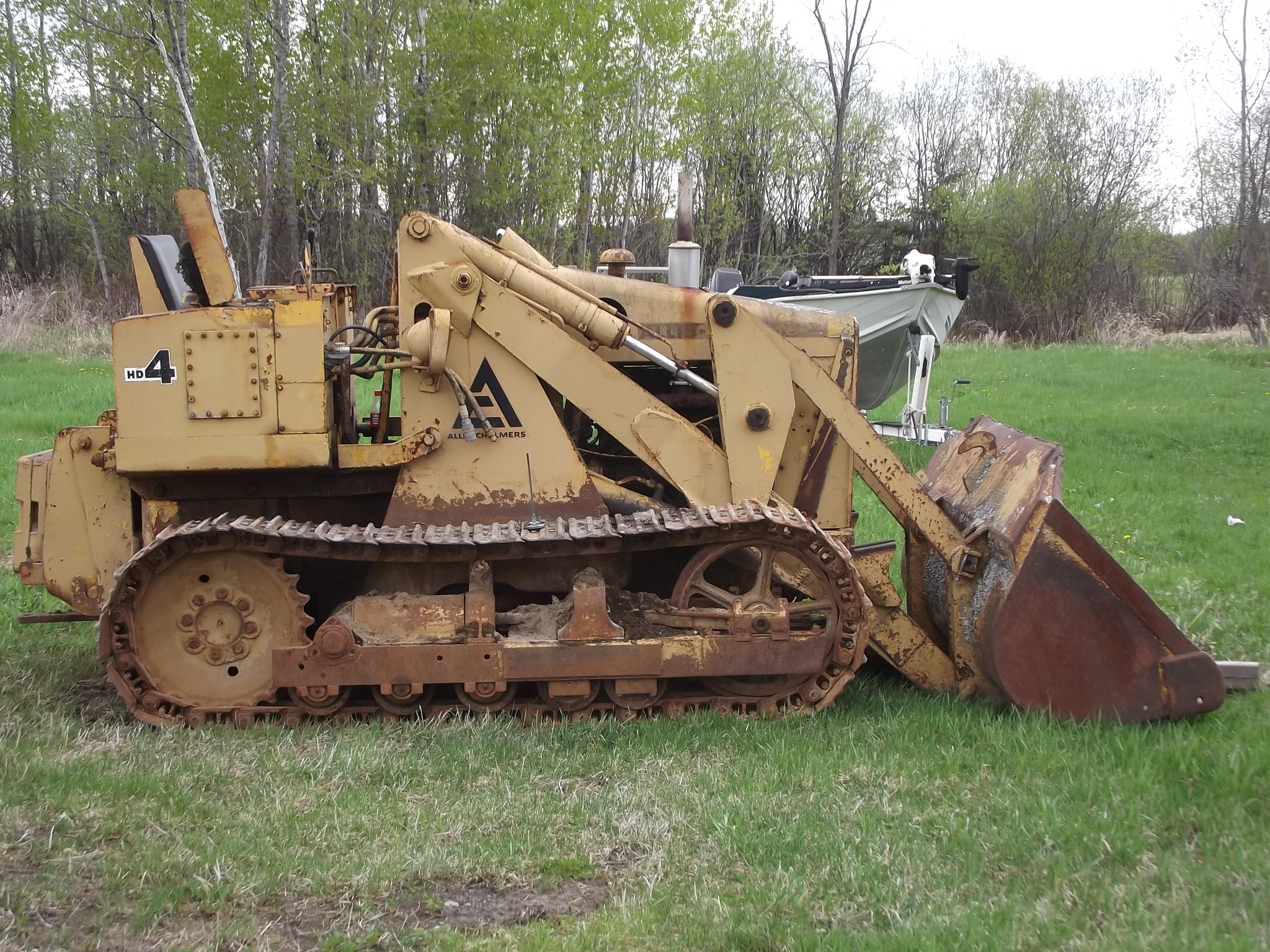

I have just picked up a AC hd4 and found when loading that when I first started the machine moved fine but as it warmed up a little bit it didn't want to move anymore. I could let it idle for a minute and put it back in gear and would go another 40 feet. Any ideas how to test so I can repair. Also what fluids go where? ATF under right foot is what it looks like, what about the shuttle is that the dipstick under seat? What does it take? I put 46 weight in the hydraulics. I really like this machine and am willing to put some money into it if I can figure out what it needs and any help would be appreciated.

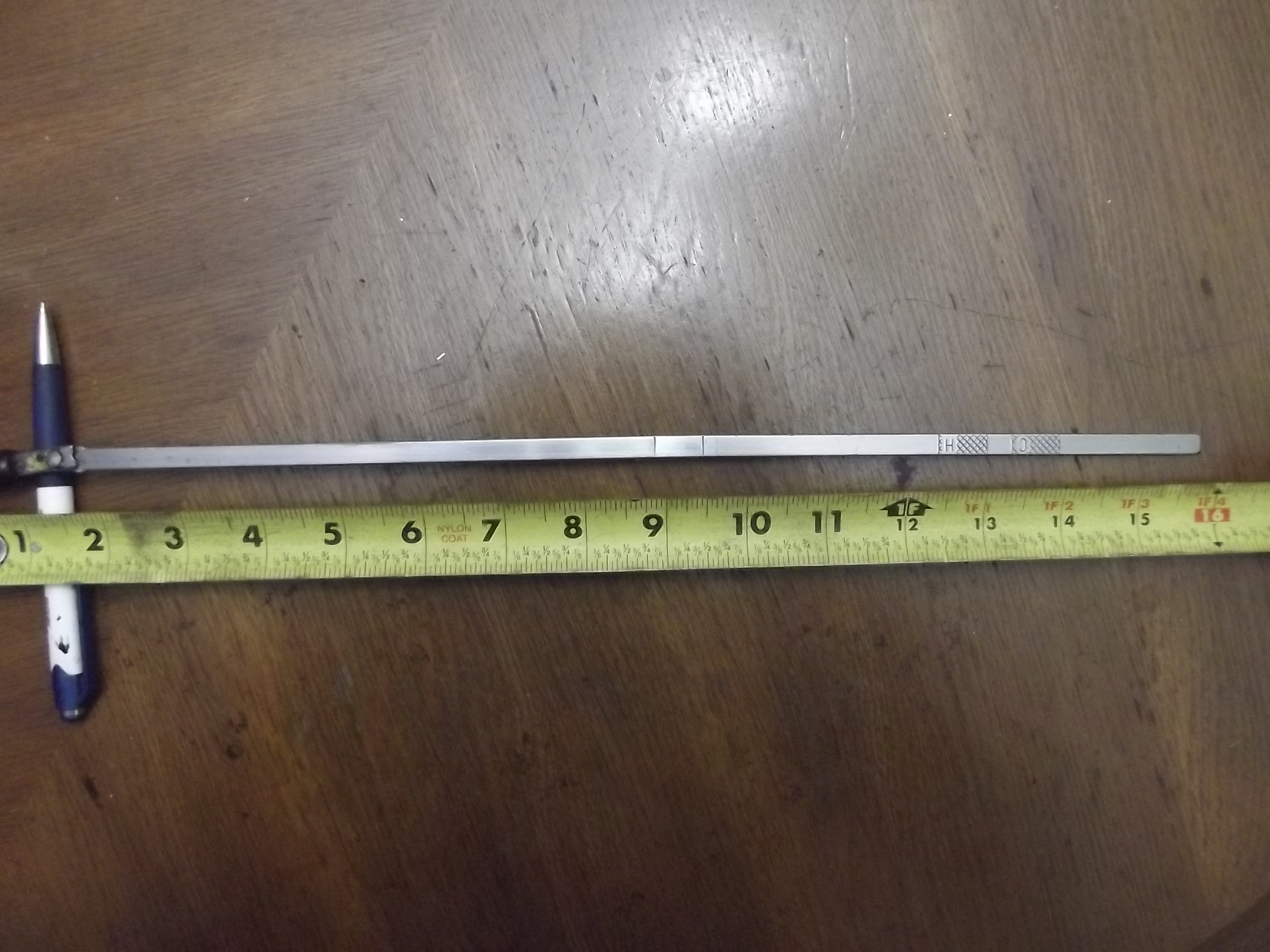

Thanks for the reply, I have check the torque fluid but noticed the dipstick is modified with another set of marks. How long should this dipstick be and how far up are the true marks. This is the one under right foot I'm talking about. Also what are the two levers by your heels one on each side. I can't seem to find the serial number either, should be up front under grill but mine shows nothing there. Can it be found anywhere else on machine?

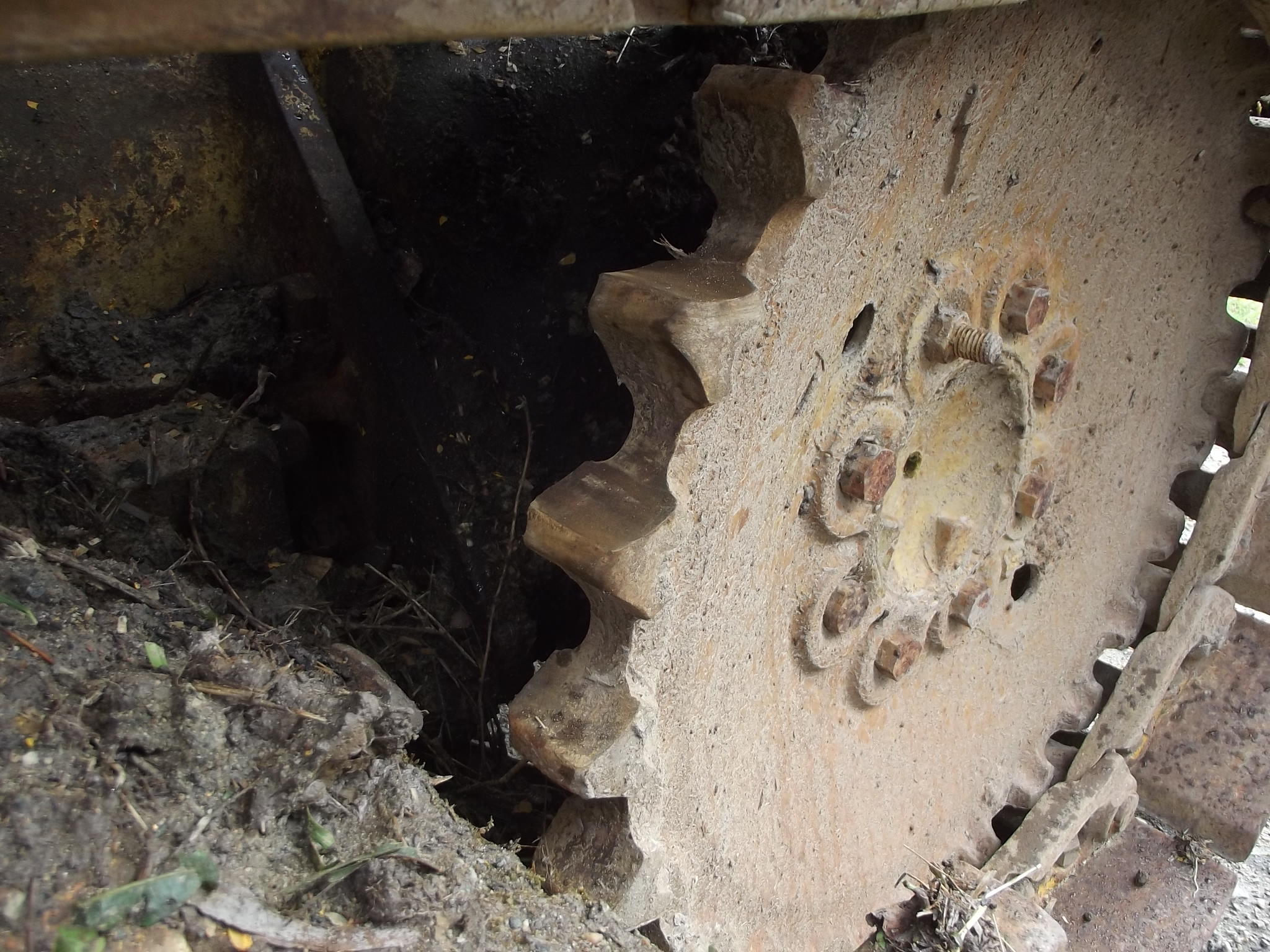

 looking at upper center track idler - cant tell if it's there

Thanks for all the replies, yes it is missing support roller. I might just make something for it since it wont see many hours around the yard. I found the number 1649 on the torque housing. I also picked up a pail of ATF for the shuttle, I will fill to proper level and report back with the results. If it still acts up then maybe I can do some pressure tests and narrow the problem.

Are clutches available? And quite honestly with the extra marks on my dipstick I'm still not 100% sure its not a fluid level issue. Here is a pic  does this look like the correct stick. I will also try some lucas trans fix while I'm waiting on reply about dipstick

A hot and cold mark for fluid - running or engine off .
