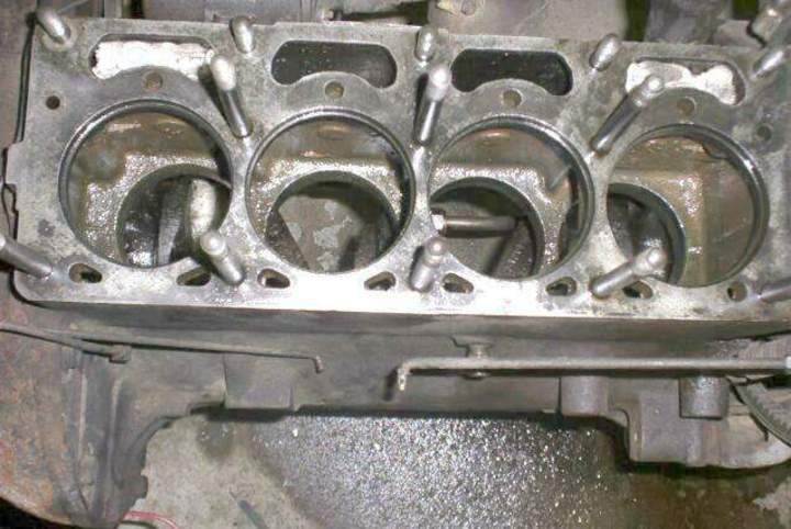

A engine is either straight cast iron with bore being part of the block - that is machined to size for pistons to run on the cast iron forming the full block casting .
 Wet sleeve engine has block casting machined so a sleeve (liner) forms the bore for the piston to run in . These are a separate casting or steel sleeve that is fit to block - generally sealed top and bottom by head gasket and o- rings on bottom .
 Now this sleeve can be cooled by water surrounding sleeve or in some cases the sleeve is dry and no water touches it but contact with cast iron block is used for heat transfer
 Now in some engines the pistons are cooled by oil spray from rod onto piston and sleeve bore .
Points: 93378
Post Options Post Options   Thanks (0) Thanks(0)   Quote steve(ill) Quote  Post ReplyReply Direct Link To This Post Posted: 25 May 2017 at 5:50pm
4 cylinder motor with wet sleeves removed.  What you see inside is the water jacket open to the backside of each sleeve.
