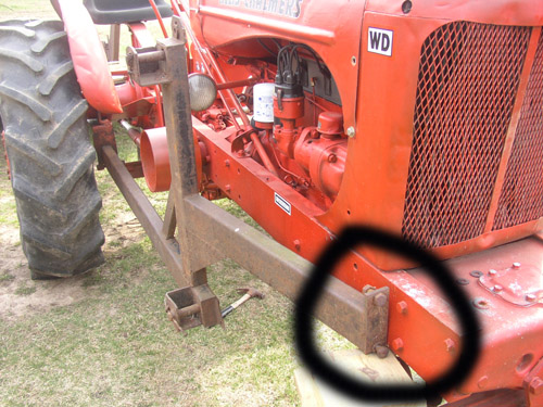

Here is a pic of what I am trying to do. It is a Kelly Loader. I am visioning some angle iron, unless Allis made a special bracket that will make this work.

Welcome to the forum! Not the foremost authority on the loaders, just wanted to say hi. I think you may be on the right track with the angle iron. Others will know for sure.

Yep, a heavy piece of angle will do the job for you. Also, I suspect that there was a cross cbrace at the bottom of the towers that I cannot see in the pic
