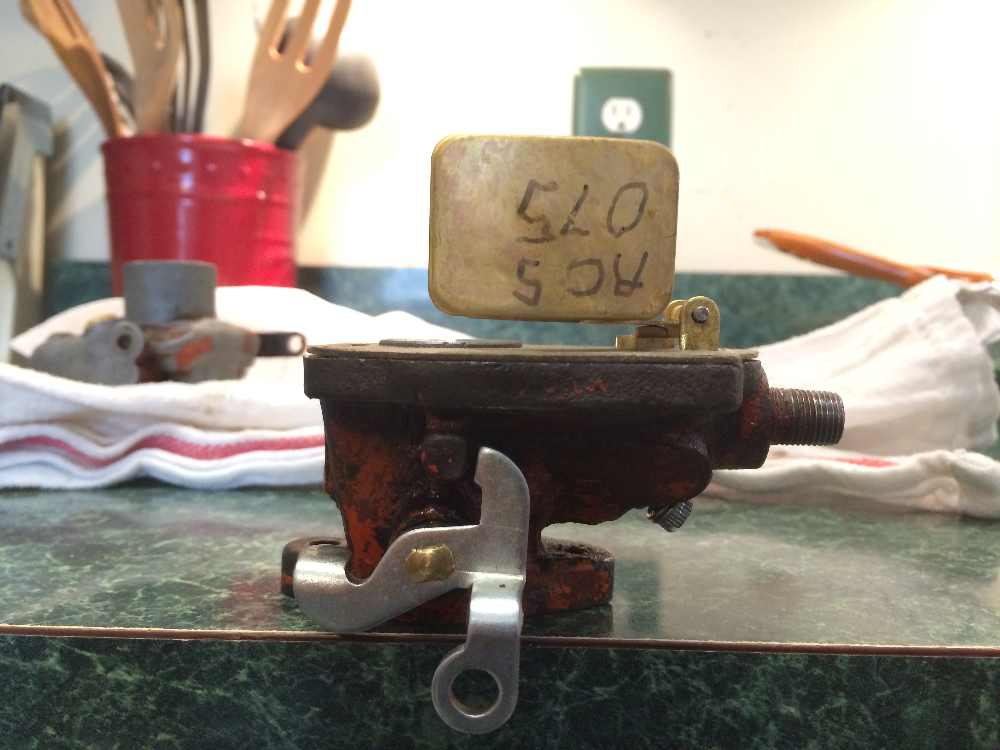

If you are talking about the float setting, turn the carb top upside down and hold level. The float should be level with the gasket surface of the casting.
 Here is where you need to use your lung power to check the needle and seat. Blow into the inlet, not with an air hose, while holding the carb top upside down. No air should pass by the needle with gravity holding the seat closed. Then the thing most people don't do, is turn the carb over and measure the drop of the float. Compare that to the depth of the bowl. Floats CAN drop too far and wedge in the bottom of the bowl causing flooding.

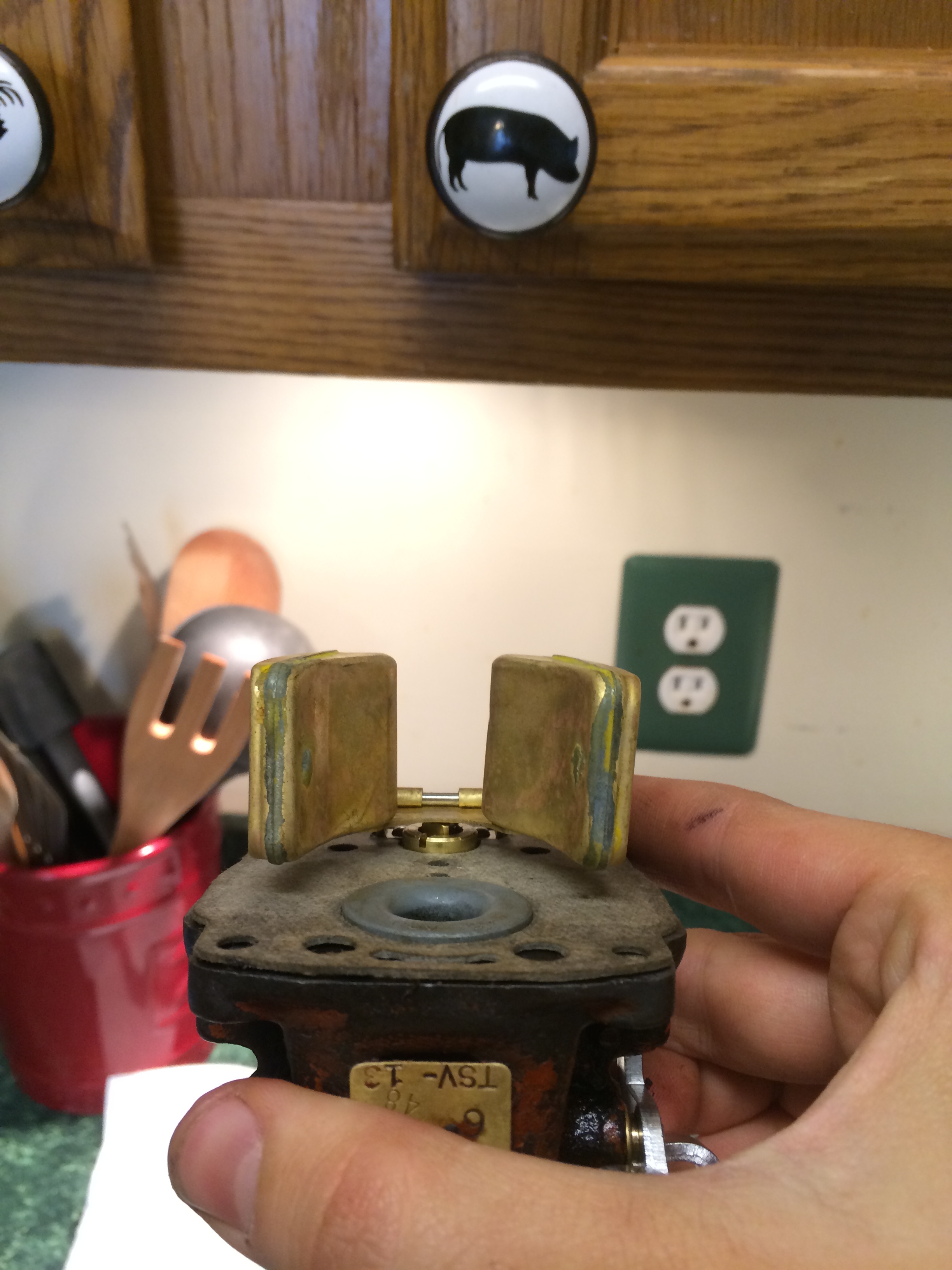

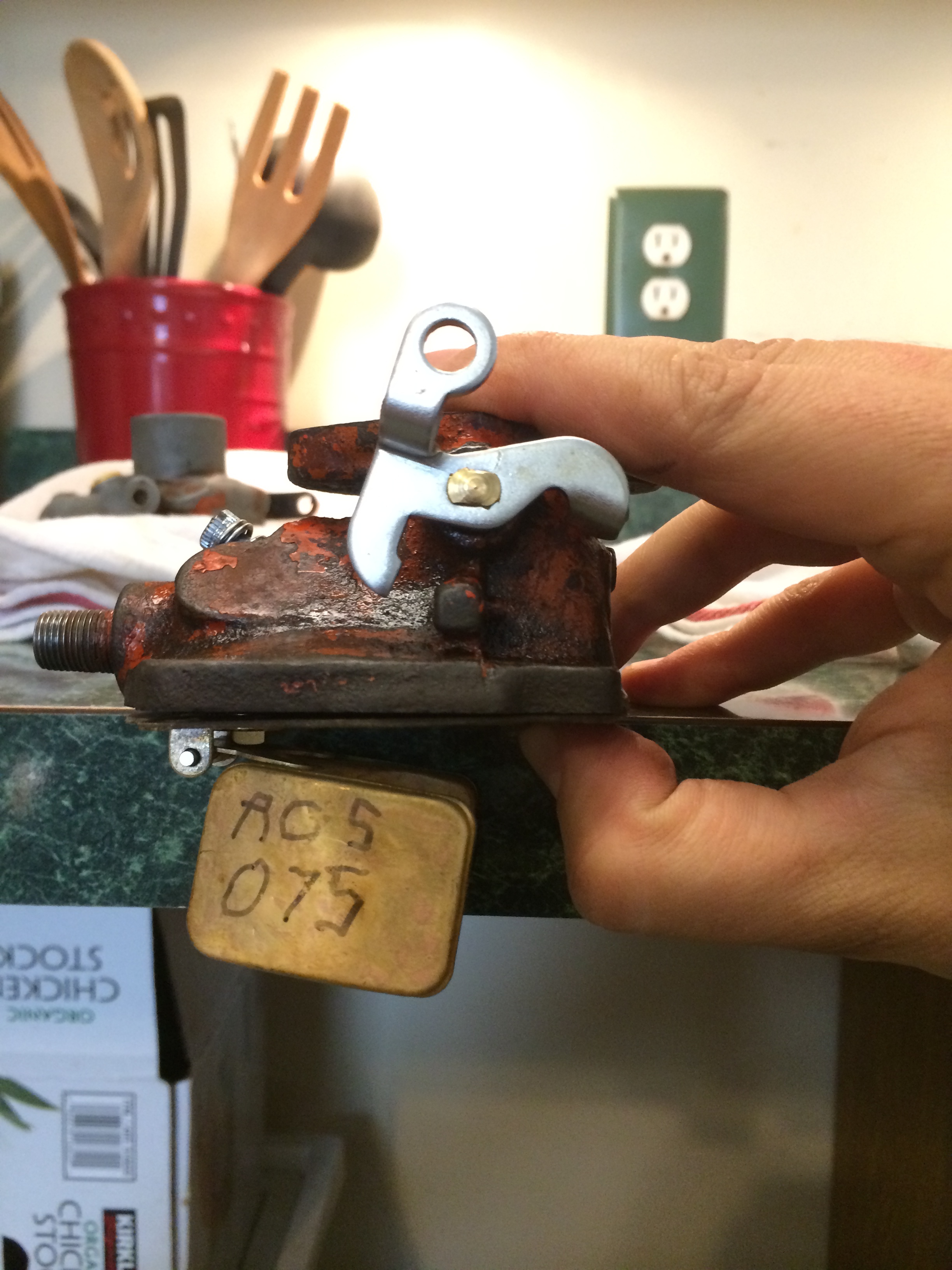

Ok carb removed and here is what the float setting looks like. Any advice? Also I'm noticing the Float Valve needle gets stuck occasionally when I turn the top of the carb upside down - to right side up. The float valve is new - any ideas on keeping that from sticking?

Post Options Post Options   Thanks (0) Thanks(0)   Quote rdm1301 Quote  Post ReplyReply Direct Link To This Post Posted: 15 Feb 2015 at 1:59pm
One more image:

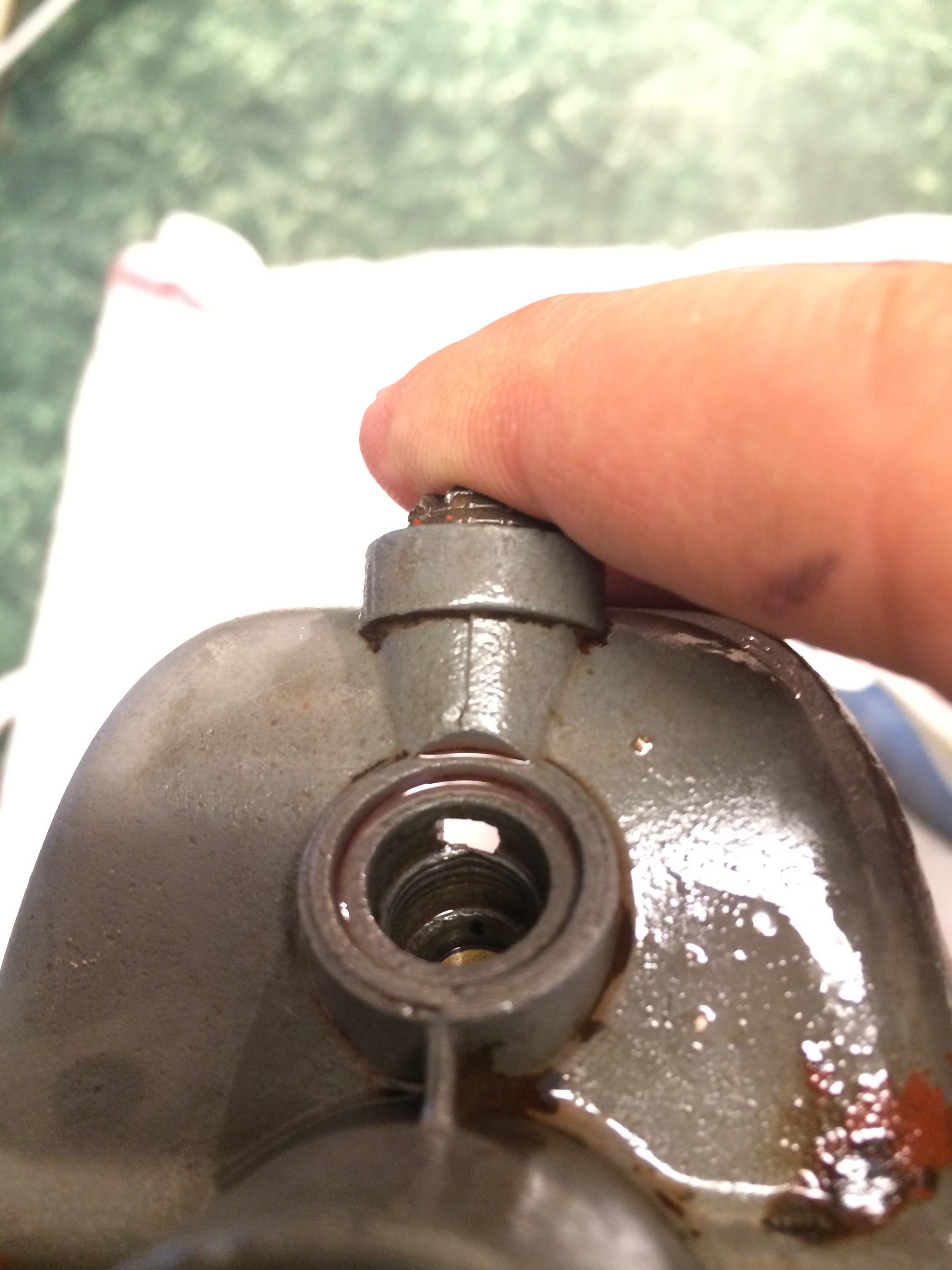

Also can anyone confirm whether or not this square-hole (where the metering jet goes) is intentional or a flaw?
Thanks again for all of your help.
