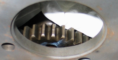

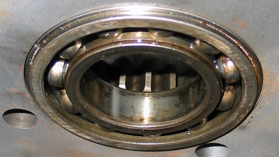

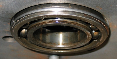

The replacement bearing number is 6210 ZZ NR and comes with a snap ring that is too large to fit in the counter bore so you will need to use the snap ring from the old bearing.  The snap ring is necessary to hold the bearing in place front to back.  Here are pictures of this on a RC transmission but it is the same part number as the WD45 and its purpose is the same.  I had to use the snap ring from the old bearing when I put my WD45D together too, or you can't get the housings all the way together.  The first picture is just the housing showing the counter bore:
Then with the bearing half way in:
Then with the bearing seated:

Jeff Z. NY View Drop Down
Points: 7326
Post Options Post Options   Thanks (0) Thanks(0)   Quote Jeff  Z.  NY Quote  Post ReplyReply Direct Link To This Post Posted: 28 Mar 2010 at 10:39am
Thanks for the pictures.
Picture are good. They tell the story without words.
That should explain it very good.
