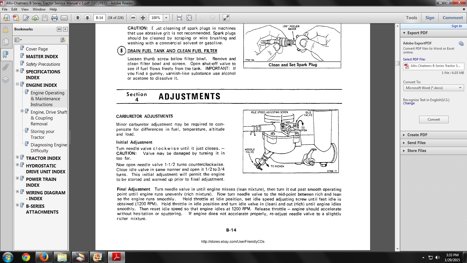

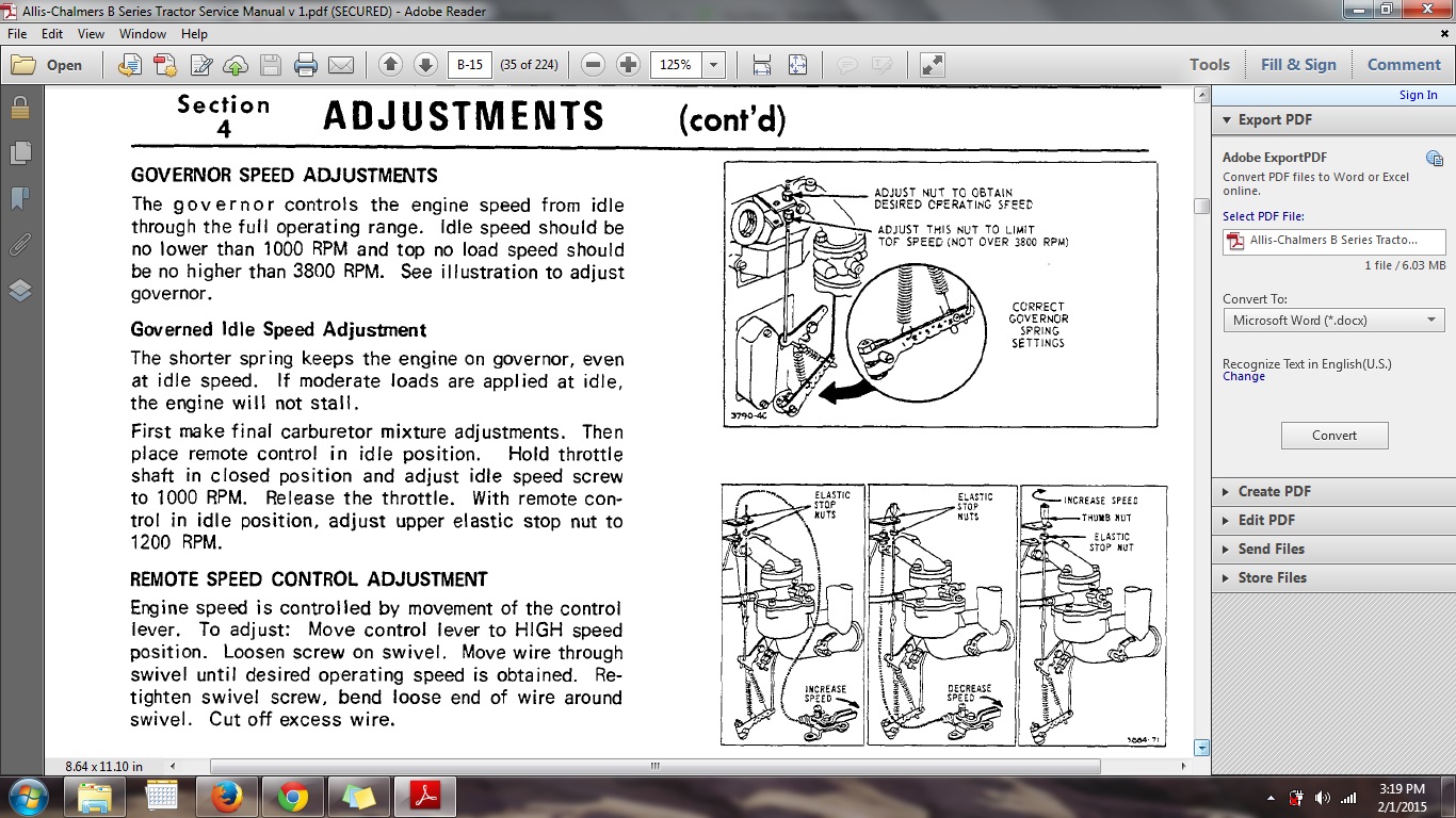

Couple shots from my B110 manual.  One on carb adjustment, one on setting the gov.  It's possible when you put the carb back on you missed some linkage attachments or something.  You can get a manual rpm gauge to set the RPM.  any parts store should have one.  I have a dial type that you hold on the end of the front of the crankshaft.

more than likly ether it is hooked back up wrong or the gov shaft has been moved on arm loosen arm hold carb linkage at WOT turn shaft counter clockwise tighten arm 35in lbs. check  linckage for any binding  set springs top no load 3600rpms

ststic govenor adjustment is done before any of the other adjustments are made then never [rarly] touched agian
