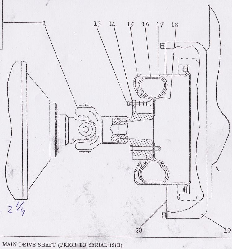

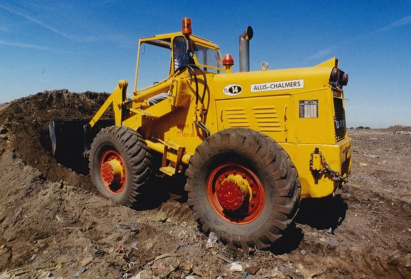

A member of our old construction machine group has this Allis-Chalmers TL14 wheel loader with a problem.
The inner and outer tire  from the main drive shaft are damaged so we have no more drive and can not use the loader !
Can someone help us at a new parts 16-17 of the drawing.
Goodyears smooth implement
16: Outer tire Allis-Chalmers part no 27979
16: 300-7-?-6 ( al we can see on the old tire )
17: Inner tire  Allis-Chalmers part no 27978
17: 12 1/2 x  2 1/4
We have tray everything here in Europ but can't get the good parts.
Thanks in advance
