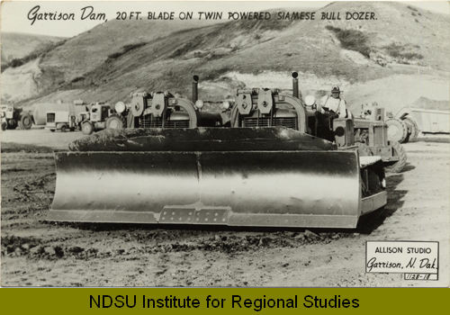

Allis-Chalmers made for the building of the Garrison dam a special dozer named the "Siamese" It was made from two HD-19's together and it as the type of HD38.
But does this unique dozer still exist? Or can tell someone more about this unique machine? Did this thing work wel?

Said it was built by one of the construction companies - I noticed it only had 2 tracks - outside units on each machine - they must have coupled the axles inside the unit together to keep power equal to both machines and tracks.

With an older steering clutch style machine, wouldn't one side still be driving if the other wasn't there? Basically 100% of the power would go through the bevel gear and into the 1 final drive.
Actually, that way a guy could steer with power to both tracks just by adjusting the throttles.
Or am I over-thinking this??

The idea I have is if you coupled the axles of the machines together - your HP to each track would be double - As steering clutches were lever controlled it would be hooking the lever from left (main operator ) to machine on right .
 As the unit has a torque converter the power output would equal out by the linked inside axles . Otherwise it seems to get the machine to synchronize output would be a real problem.

Seemed to work well in the video, the Prime Contractor was Morrison-Knutson, if memory serves Me, with Sweeney Bros being the Dealership. This Mod was done by the Contractor, undercarriage wear must have been something else. I haven't spoken with Larry Sweeney in some years, His Family ran an awesome Dealership in Fargo, Bismark and Minot during My Youth. Loved going to see the lineup of Crawler. I remember especially an HD-5 next to an HD-20 in Their Showroom at one time in the early "50's. My Father used Them as Our Dealer.

You sure wouldn't want to go near a mud hole with that Siamese Dozer!
