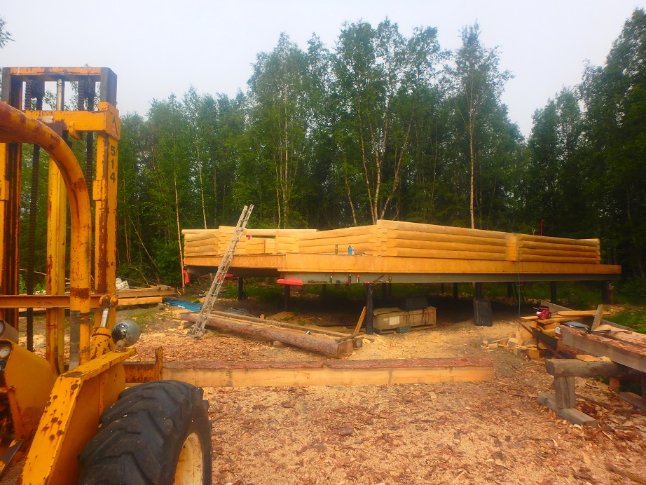

I ran home to check these mssgs,will grab the computer and run back to the building site with it,and check it periodically.

Yessir,i'm at the site now,and that case is absolutely blind.
On the bottom left there's a round indent in the casting where i'd imaging the drain was meant to be bored and tapped et c.,but it's blank on this one.
I'm not sure i'm up to drilling into it and tapping it,not at present,these logs Must go up and get tin on them before the winter,i'm kinda in a slow-motion race here with this...
I'm failing to access that side inspection or whatever plate also,the floor plate there holds the rocker shift and has a number of 1 1/4" bolts pretty frozen,and barely room to get at them...
The plate itself is held on by these funky large straight slot machine screws,i tried a couple and it'd take an air-impact,and a Very carefully sized bit to not ruin the slot...I can see the damage to the slots where someone powered them In,so i think i'll forego this idea,as tempting as it is to Really get in there to clean things out Good.
So douching the gears with diesel it must be,i'm just waiting for the hyd.system filter element that should be on the flight coming in,then the rig will be operational and i can run it to mix the sludge with the diesel.
