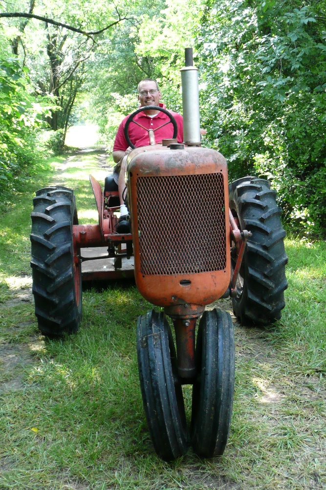

Nice pic, Miles - looks like you are having fun mowing.  When I mow with the C, use my D17 or G, I have to concentrate on not grinning too much as I still have my better half fooled into thinking I am working and not having fun.

My C does have the hole in the upper part of the pedestal, under the crank hole - it is just open, no plug.
There is no hole or plug in the lower part of the pedestal - I can see it pretty clearly in the pic of Miles C above.  Mine doesn't have anything there at all.  There is what appears to be a plug on the backside of the pedestal, off to the right side, facing backwards.  There must have been a couple different iterations of the pedestal.....?

The top hole below the crank hole is for filling the pedestal with lub.  The lower hole in the pedestal is for draining the lub.  Seems like someone turned your pedestal around to face backwards.  To my knowledge it should face forward.  The upper seal is right below the drain plug, the lower seal is on the bottom under the roller bearing.  Thomas is correct if the seals are bad the 140W will just leak out.  Gun grease will work ok in the summer, pretty stiff in the winter.  Can be a job removing the pedestal to replace the seals and lower bearing but might be worth it if it's a decent tractor.  Good luck on your C.  They are a real handy little tractor!
