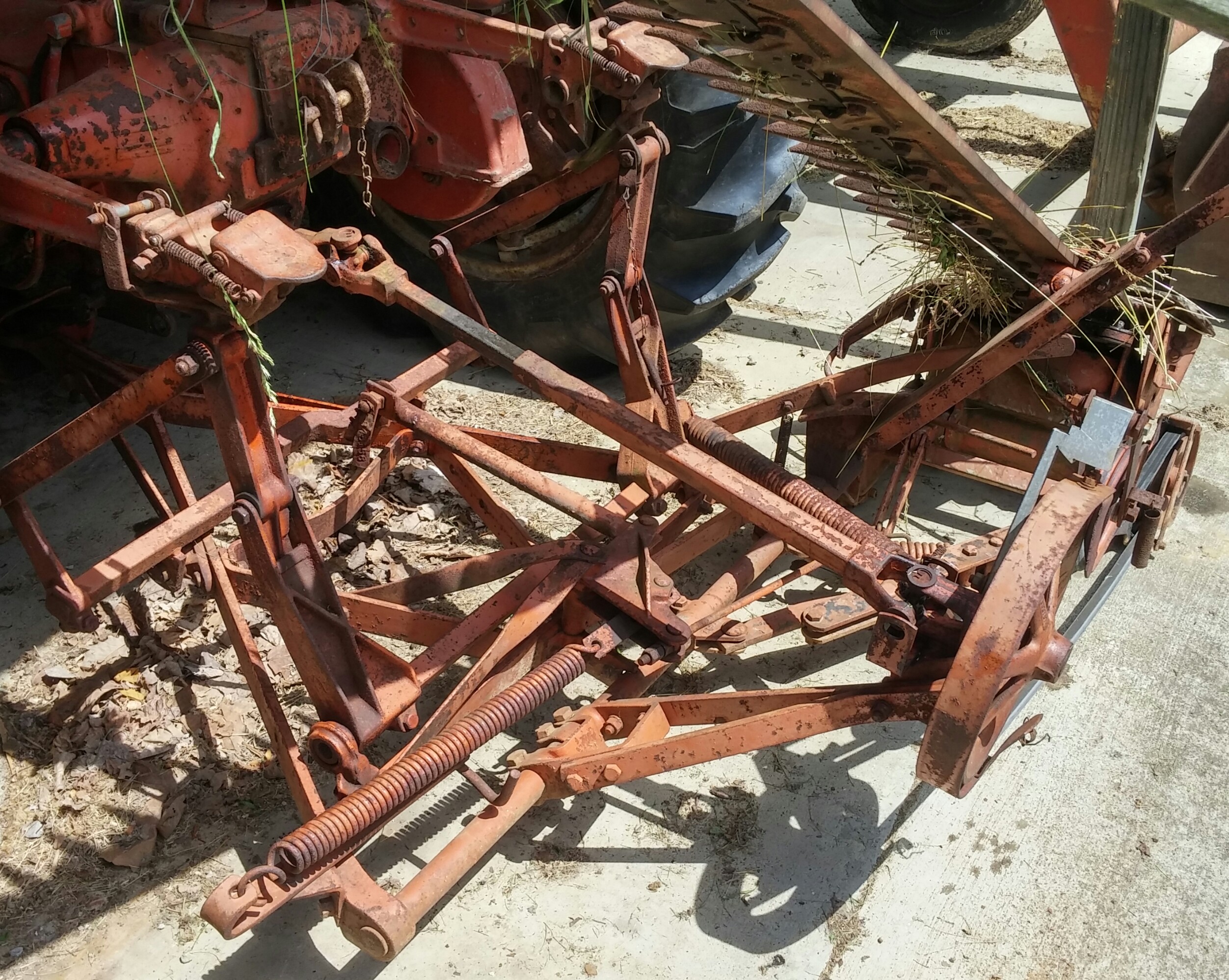

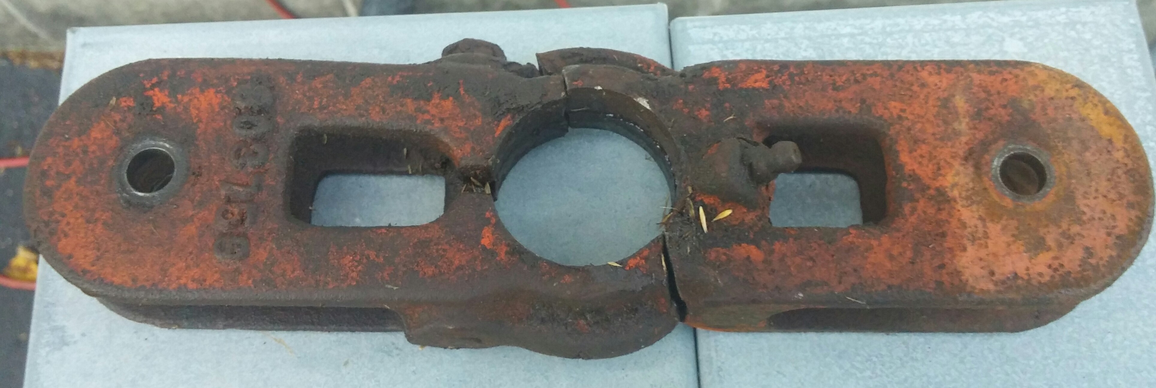

My father bought this snap coupler mower a few months ago and while he was using it a few weeks ago what looks like a pitman arm broke. I am hoping that I can find this part for him as he really enjoys using it. I will attach a few pictures of the mower and the broken part to hopefully find parts.

Twin wheel drive arm.  Bolts to blade. I'm guessing a #7 rear mount mower.  Others will chime in, if I am wrong.  Hard part to find, unfortunately...

Yes. I have been told that it is a number 7 twin wheel mower, but I didn't know if anyone on here might have a part or be able to point me in the right direction of one. I want to thank all of you in advance for any and all help.

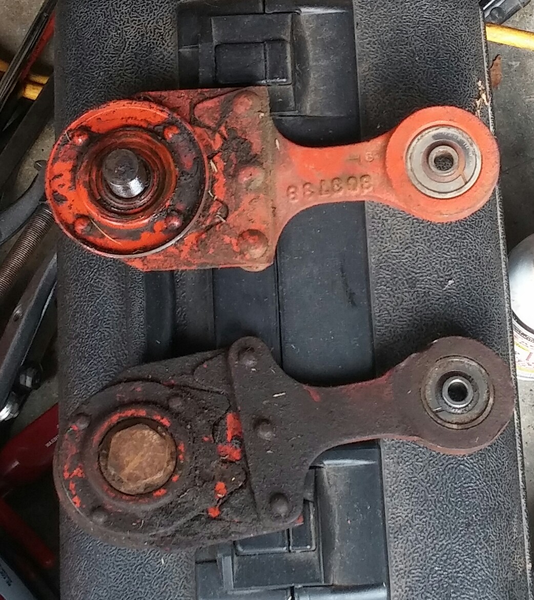

We finally got it torn down and figured out that it needs some new bearings. This is what we found, but I don't know if the bearings in these arms are replaceable or I have to replace the entire arm. I am grateful for any and all help. Thank you all.

The bearings are replaceable. Yes you do have a #7 mower. Hope you fine all the parts you need.

Ok. I need to know if I need to grind out the rivets to get the bearings out or if they come as a set. I just want to get his mower going again. Thank you for all of your help.

Did some more checking for you. Looks like the part is sold as an assembly. Here is the part number I have found 70803978. Your mower is one of the early #7 mowers. Your best bet would be an AGCO dealer and hope for NOS parts. If you like I could contact my dealer to see if they could find one. Let me know.

It looks to me like the side the nut goes on, has a snap ring. If it is, remove that and push on the head of the bolt to get the bearing out.

My gut feeling is that you will have to grind off the rivets to get the bearing out.

Like CTucker says it certainly "looks" like there is a snap ring holding that bearing.
On the other hand, like Aaron says it may be necessary to grind the rivets.
In any even, this is the first "two piece" connecting rod I've seen and there must be a reason that it is sold as a complete assembly including the bearing.
The parts book lists a bearing as being available for the one-piece rod only.
My question....are the bearings bad enough they need replacing.
Those expensive little bearings on the small end of the rods look to be in good shape.

It this point you really have other option than to remove the rivets. The newer style connecting rods will not work with out replacing the flywheel as well.

The bearings on the small end of the rod are those unusual "KP" aircraft
bearings you speak of. Not so easy to come by locally but are available from
"Aircraft Spruce & Specialty Co". I bought a pair of the KP-8s in '09 for
$33.00 a pop.
I believe the small bearing used on the two piece rod (Ser.# below 10601),
is the KP-6 which has an OS Dia. of 1.4375".
The small bearing used on #7 mowers Ser. #10601 and up
(and the 80 & 82 series) is the KP-8 which has an OS Dia. of 1.6875".
If the bearings on the large end of the two piece rod are the same
as those in the one piece rods, they are common bearings available at any auto
parts store. The last ones I bought back in '99 were #SPE 6304 at $16.99 each.
