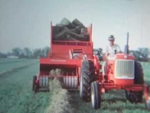

there is promo video of bailing into self un loading wagons then opening back up to unload hay by hand
Points: 5469
Post Options Post Options   Thanks (0) Thanks(0)   Quote AC720Man Quote  Post ReplyReply Direct Link To This Post Posted: 29 May 2021 at 6:48am
Well there you go, proof is in the picture. Actually a really good sales pitch, one wagon does both. Is that a D15 or a D17 pulling the baler? Looks like a series II D15 to me.

Not sure but I think that wagon has back doors that open and the apron reveres to move the bales out the back.
WF owner View Drop Down
Joined: 12 May 2013
Location: Bombay NY
Points: 5180
Post Options Post Options   Thanks (0) Thanks(0)   Quote WF owner Quote  Post ReplyReply Direct Link To This Post Posted: 30 May 2021 at 5:39am
Exactly !
We had one that we used that way. If I remember correctly, you could only kick about 60 bales into it. Again IIRC, the back tailgate hinged near the top and there were prop rods on the sides to hold it open. The lags turned backward to slide the bales to the back.
This was our first self-unloading wagon. Up till then, we has used "false-front" wagons for silage and for bales. The false front was removed and all bales were unloaded out the front.
Hay was baled by an AC baler (302 or 303) with a bale thrower powered by a 8 hp. Briggs and Stratton engine.
Dad concluded that the self unloading was too small to be beneficial and that somebody was going to get hurt using it. It was also very hard (and unsafe) to unload. It also meant that you had to have a tractor with a PTO to unload and my grandfather's WF (which I now own) had no PTO. Ours was very short lived as a bale wagon.
