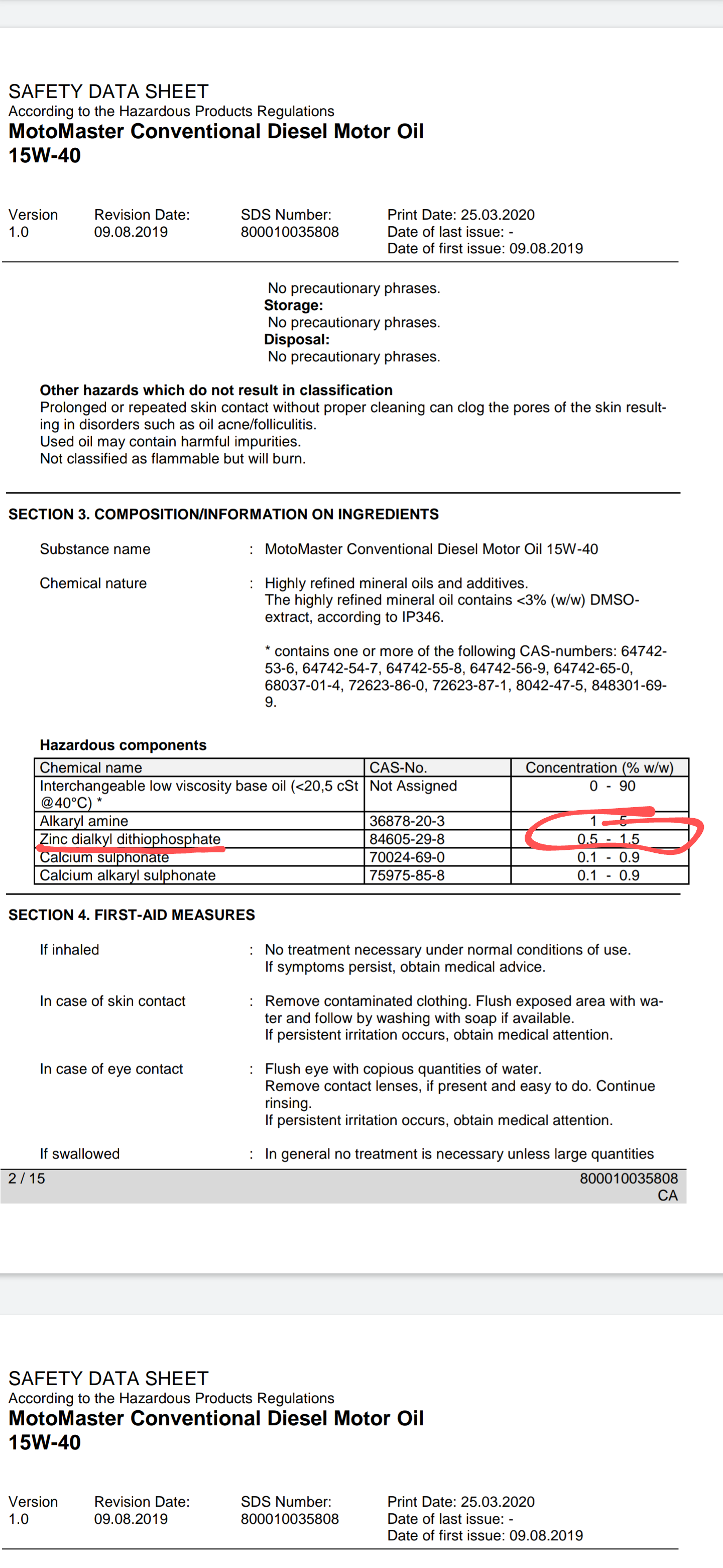

Post Options Post Options   Thanks (0) Thanks(0)   Quote Northern Hoser Quote  Post ReplyReply Direct Link To This Post Posted: 23 Mar 2022 at 9:08am
MSDS sheet has a little info:
Safety sheet lists zinc as 0.5-1.5... which is 500-1500ppm I believe
Quite a wide spectrum there
It does say it's produced by Shell
