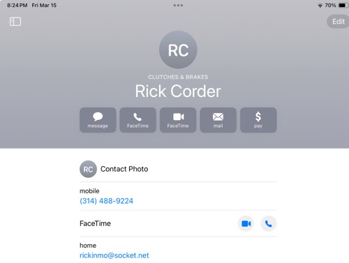

Yup! Got the answer for that! Give em' to Rick Corder. He does a fantastic job for everybody here. Look him up in the classifieds.

Post Options Post Options   Thanks (0) Thanks(0)   Quote Freewheeling Quote  Post ReplyReply Direct Link To This Post Posted: 15 Mar 2024 at 6:08pm
Can't find him...
