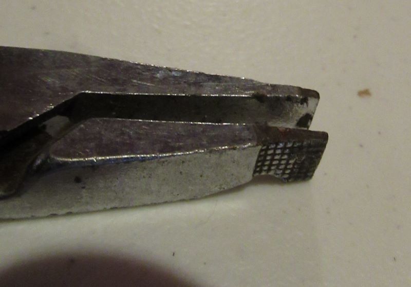

The best ones I ever used for that type of snap ring are my Snap-On pair. They have the grips like pictured above but also have a small divot on each side so it grabs the ring better if the ring has a bit of a point on each end.
