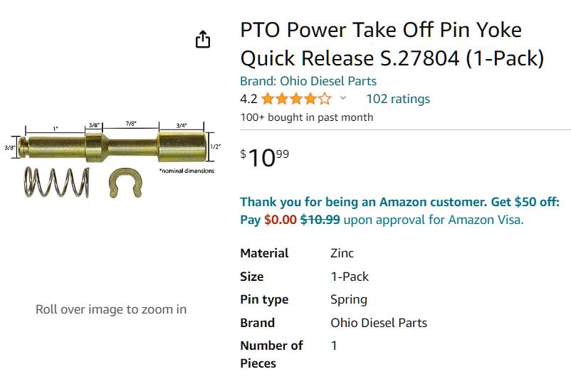

I just bought a 5 foot pole behind Allis Chalmers rotary mower. I need to put in a new PTO yoke pin. Can somebody please tell me the right size and correct one to purchase? Thank you.

Welcome to forum. Have any pictures of what you’re looking for
Points: 5469
Post Options Post Options   Thanks (0) Thanks(0)   Quote AC720Man Quote  Post ReplyReply Direct Link To This Post Posted: 20 Aug 2023 at 8:50pm
Replaced the pin in a AC sickle mower with one from Sandy Lake IMP. Pretty sure they are all the same but they can tell you for sure.
Points: 55273
Post Options Post Options   Thanks (0) Thanks(0)   Quote DiyDave Quote  Post ReplyReply Direct Link To This Post Posted: 21 Aug 2023 at 4:45am
I think there are only 3 types. If you have a TSC or somilar nearby, buy one of each, and compare to original...  Or, take the original out, and take to store, to compare on sight...LOL
Points: 90793
Post Options Post Options   Thanks (0) Thanks(0)   Quote steve(ill) Quote  Post ReplyReply Direct Link To This Post Posted: 21 Aug 2023 at 8:38am
almost all of them are 1/2 inch "STANDARD" size... there are a couple odd balls, but MOST use this pin.
Points: 8981
Post Options Post Options   Thanks (0) Thanks(0)   Quote SteveM C/IL Quote  Post ReplyReply Direct Link To This Post Posted: 21 Aug 2023 at 1:11pm
That's like the one on my Woods. It keeps breaking off at the small dia. Got tired of that so use a screwdriver to poke it....not handy.

If it is breaking off, you have a problem with telescoping part of PTO. Too long or not telescoping easy enough.                      MACK

I need to double check but I'm sure the telescoping slide has more than enough travel and I keep it greased. I shortened the drawbar a few years ago to get the geometry correct on the two front u-joints in a turn. Took a lot of hammering out of the turns. Maybe that had something to do with it. I should replace the pin and see how long it lasts.
