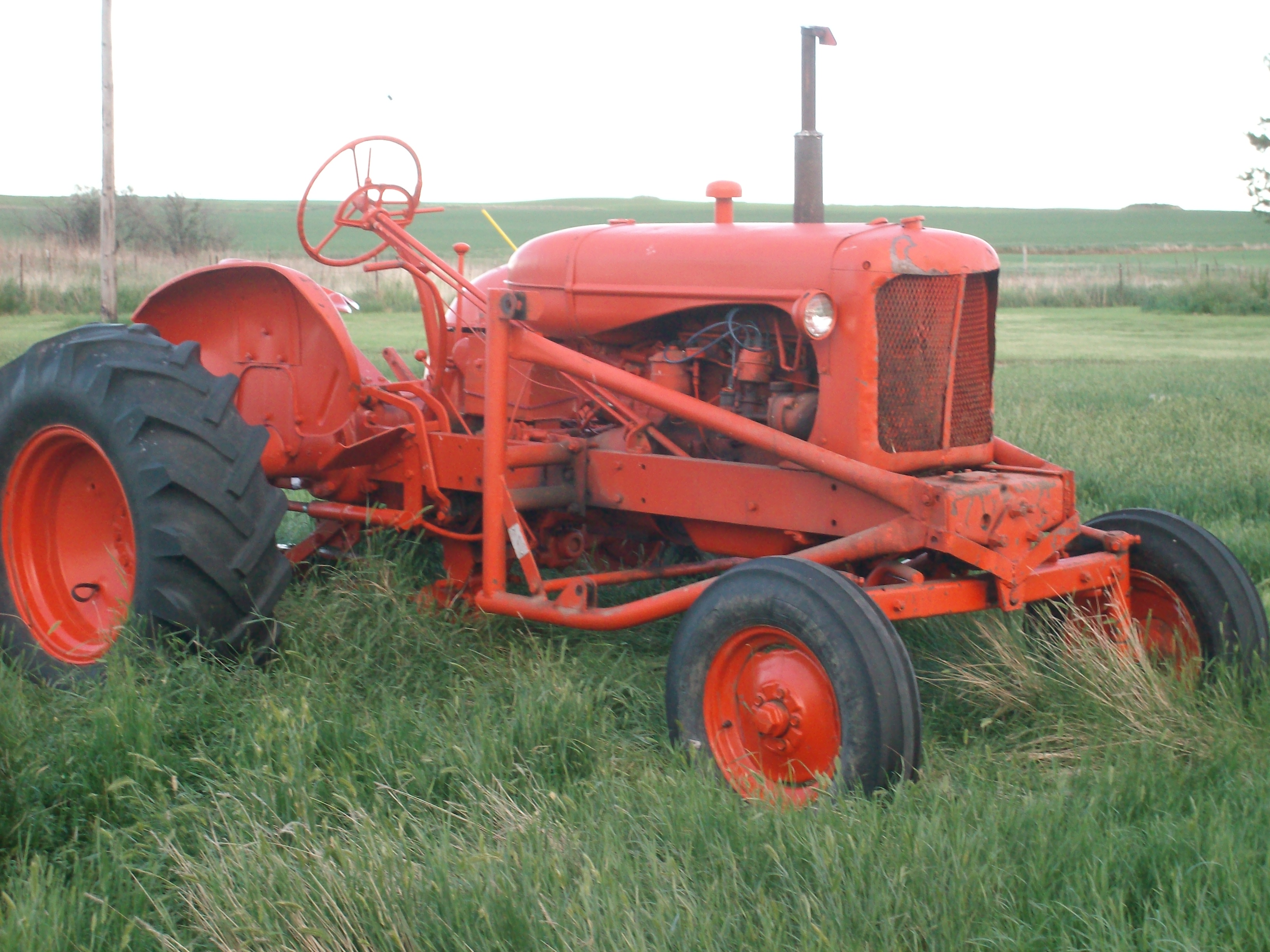

Hi Guy's, New to your forum and need your help already! Just bought my first Allis. I bought it as a 1949 wd.  I was pretty positive it wasn't a 49 ( I could see 50 and 51 dates), but to further confuse the situation, I went to pick up a loader for it today and the fellow had 6-7 wd's and wd-45's and 60 years of knowledge about them. While looking around at his piles of treasure's I started to wonder about the exact model I had purchased. The serial # on the rear end is WD47054 but the engine doesn't have the large plate on the side of the block like his WD's . Mine also has a distributor whereas his WD's were all mag's. His WD-45's looked like the exact engine, had a distributor.  How can I tell what I have? The only part I got for it so far was a starter drive which should be interchangeable...
Any help in deciphering this conundrum would be great!

WD  with an engine change.  The  45's had a gear shifter that was curved.

the curved shifter is not 100% proof.
This DOES have the straight shifter, and looks like it has the shorter head, so best guess is that this is a WD.
Get the serial number and google it online, and that will tell you for sure.
Now, looking at the oil filter canister, this also looks like it has the Leroi engine in it.
Its a little bit different than the Allis engine.
Good Luck.

You have a WD with a 201 Leroy engine in it.

Don, what gives it away as a LeRoi engine? There is a pair of them in some Bantom draglines at my local salvage yard. They look like AC's to me.

 Two of the things that tell me Leroy are the canister oil filter  and the timing cover.
This tractor has a WD45 gov and dist in it too.

Don't mean to sound like the correct police, but that loader frame is mounted about a foot too far forward.  No big deal unless you are lifting real heavy stuff or have short arms as you'll have a hard time reaching the trip lever.  Also, if thats the stock oil pressure gauge location, it's darn near worthless.  Would that engine have originally been on a power unit?

The Leroi engines have that canister oil filter, and alot of them don't have a thermostat, or even the location for a thermostat. The water manifold is just a straight shot up to the radiator hose.
There are also no markings on the block like the AC blocks have.
I had one in a WD45, and was NOT impressed with it. It had no power.
It was a 201 with the shorter head, and it did not do well on the dyno.

WD47054 is a 1949 WD, the straight shifter is always a WD. It also has had an engine swap and combine wheels put on it.

1. AC never used the engine in their tractors. As mentioned before, this tractor has had an engine swap.

Allis sold cast blocks to LeRoi. LeRoi then added other components such as head, covers, oil filter etc. At least that's the way I understand it. I have also seen the 6 cylinder version of this engine in an air compressor with two of the cylinders used as the pump for the compressor.

You will more than likely need a manual for the tractor no matter what engine it has. You won't find a manual for a WD45 with a 201cu in Leroi engine. The 45 engine was 226 cu in also

14.9-28 would be what most had. The tractor came with 4 rail power shift wheels. The rims and wheels on it now are most likely 26 inch combine wheels and don't allow for adjustments.
