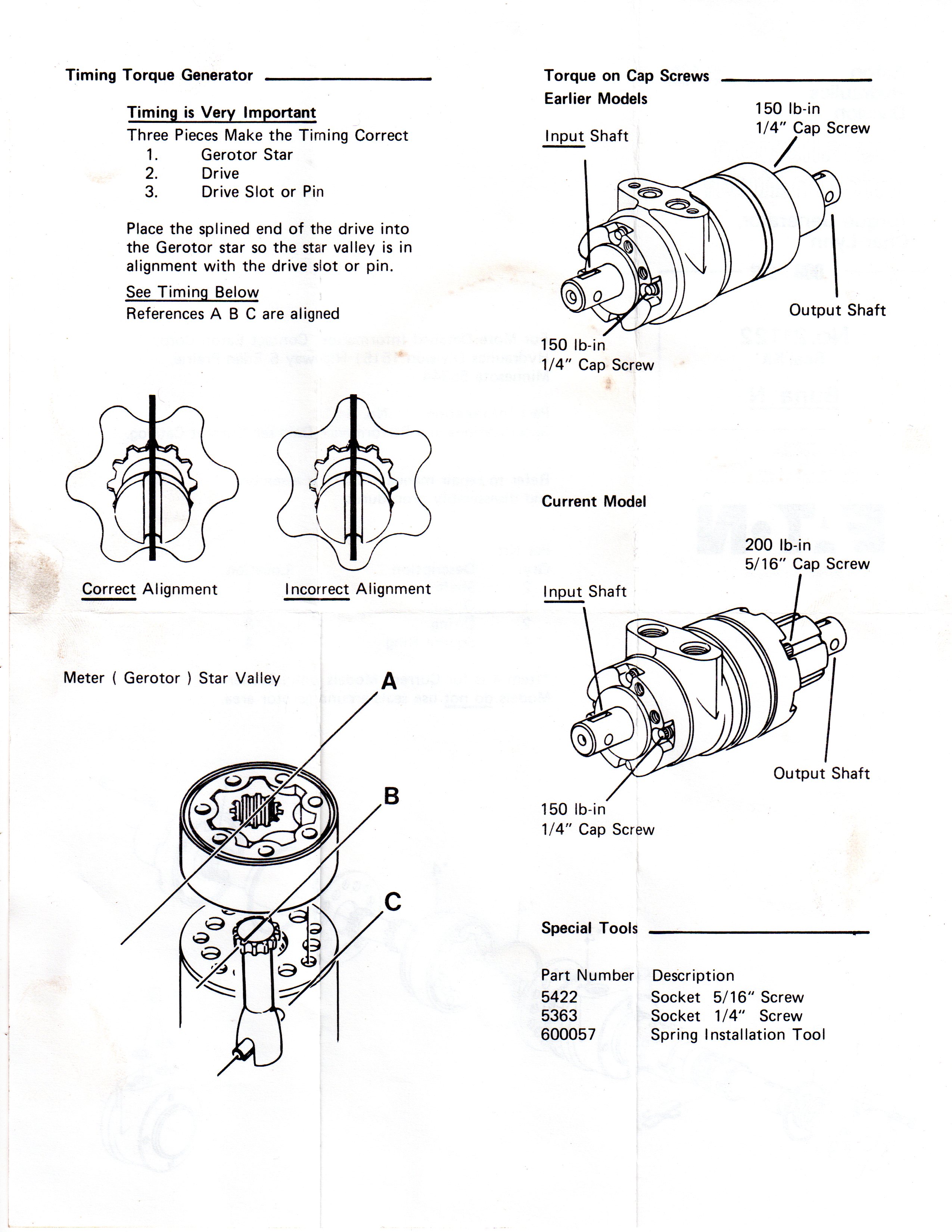

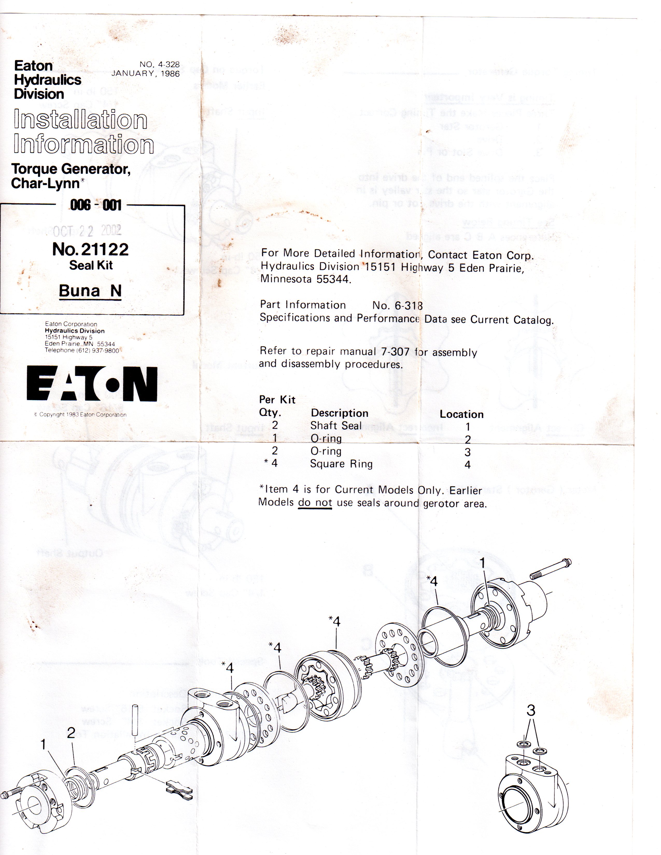

Where can I find a seal kit or someone to replace the seals in a Char Lynn torque generator for my wd45?

call Force America 1-888-993-6723. get them the number off the torque generator and they should fix you up

make sure you get these instructions an set the gearotors how they say or the torque generator becomes a motor

now ya got the part # too
