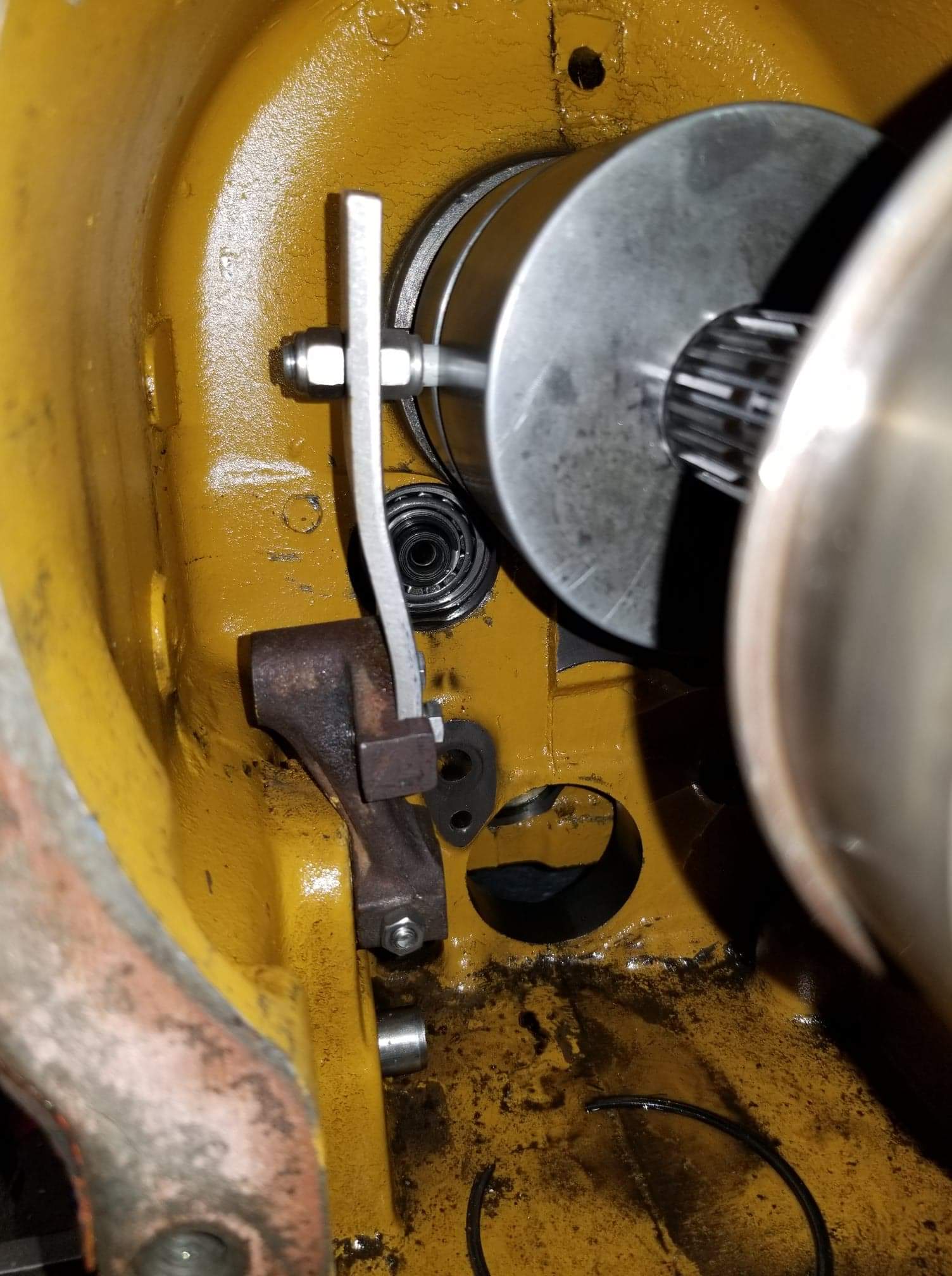

dennis at fvp has a manual shift couplers that he had made. works well thats where i got mine

i never took pictures. i can if i have it apart again. its basically the same as years ago when they would take the power director apart and use nickel rod and weld the two gears together you have to machine the outer hollow shaft tho. the ones dennis has are made out of billet. i think there are pictures on face book on the allis pullers sight. i thought i took pictures but if i did i cant find them. my buddy has been running his for a couple years now.

So can you still shift with this set up? I mean shift manually when stopped?

Post Options Post Options   Thanks (0) Thanks(0)   Quote brad durst Quote  Post ReplyReply Direct Link To This Post Posted: 21 Jan 2022 at 2:30pm
yes it is a manual shifting coupler that can only be shifted with the engine off

Like some pictures !

Post Options Post Options   Thanks (0) Thanks(0)   Quote brad durst Quote  Post ReplyReply Direct Link To This Post Posted: 22 Jan 2022 at 2:59pm
Points: 8429
Post Options Post Options   Thanks (0) Thanks(0)   Quote DougG Quote  Post ReplyReply Direct Link To This Post Posted: 23 Jan 2022 at 9:26am
Hey thats neat, thanks

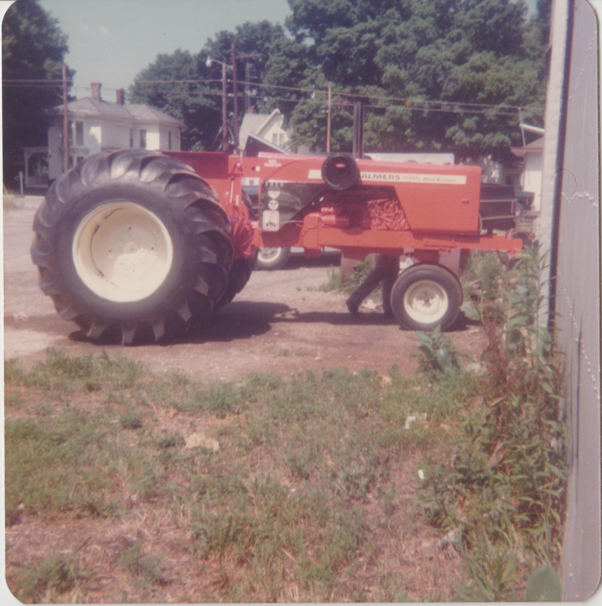

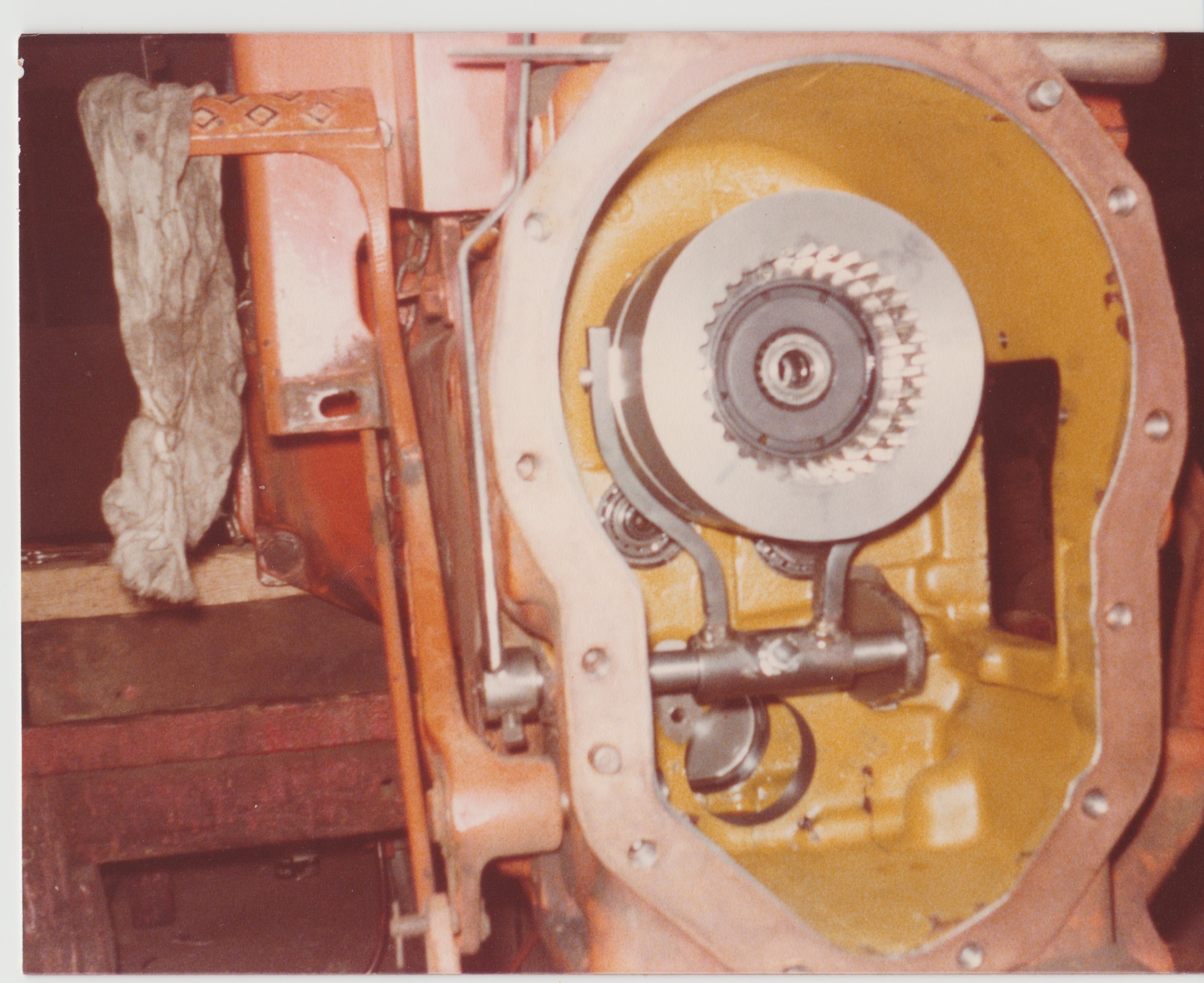

I made a power director delete back in the late '70's that worked well. Would post pictures if I new how but, I' new to this forum.

Looks great! Let's hear some history on this design!

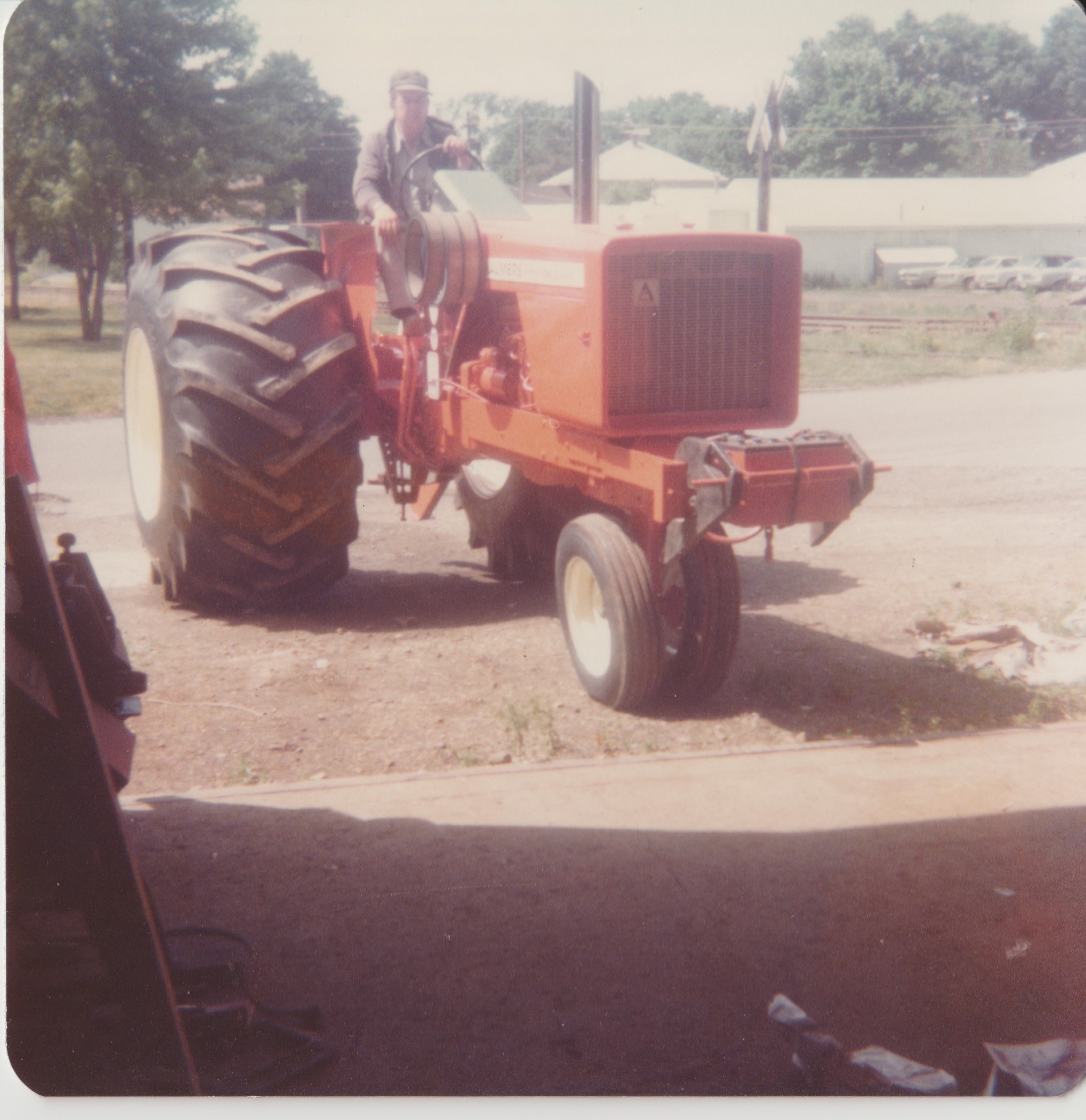

Post Options Post Options   Thanks (0) Thanks(0)   Quote estout81 Quote  Post ReplyReply Direct Link To This Post Posted: 27 Mar 2022 at 4:13pm
Doug G,
I designed and built this unit back in 1976, I think. Gettin' old and can't remember! It was an 180 that I built for a local farmer. He called it "Little Allis. Won state and national championship in I think 1978. If you look at the front end you will see a modified Oliver 60 front end. Later had to make a wide front due to rule changes. I was also the first to put a Bosch inline pump in place of the rosamaster in the stock location. The power director shifter is a sore subject for me. That's another story!
                                                     Em
Points: 8429
Post Options Post Options   Thanks (0) Thanks(0)   Quote DougG Quote  Post ReplyReply Direct Link To This Post Posted: 27 Mar 2022 at 7:14pm
Wow! Very nice! Thanks for the info! Bet that 301 was singing a nice tune!

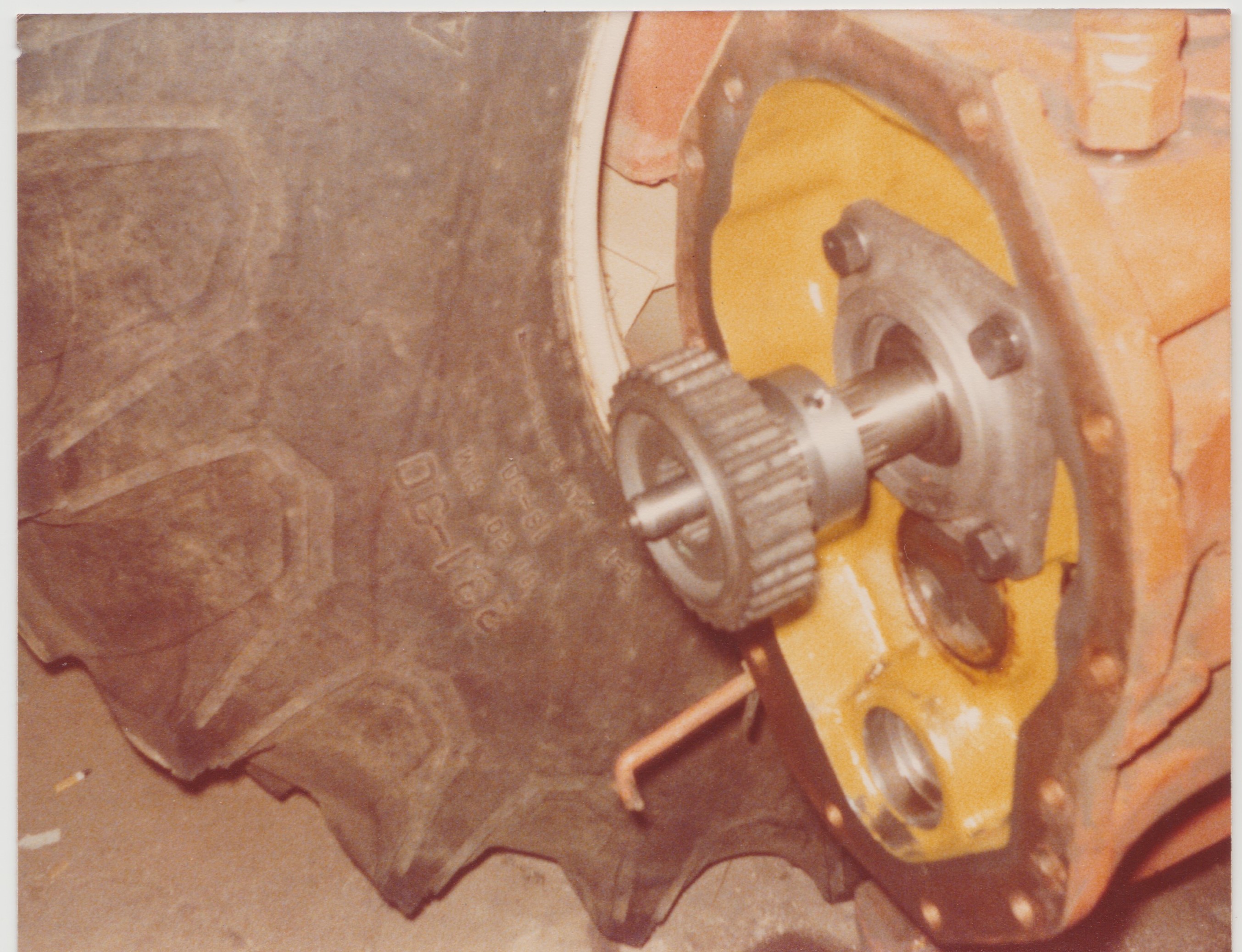

  Inside splines, nobody around here locally can do them.  Looks nice.
