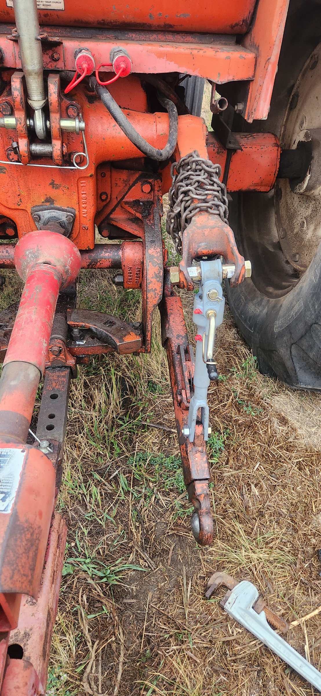

Potential 190xt leveling box
MadCow View Drop Down
Joined: 27 Aug 2023
Location: South Dakota
Points: 236
Post Options Post Options   Thanks (0) Thanks(0)   Quote MadCow Quote  Post ReplyReply Direct Link To This Post Topic: Potential 190xt leveling box
    Posted: 12 Aug 2026 at 8:16pm
So my leveling arms are frozen and I don't wanna deal with them, because I also don't like how they look like they work.
I got a Ford 1510 leveling box, it's the closest in length I could find data for.
7/8" x 6" bolt and (2) Cat 1-2 bushings on the top
5/8" bolt on the bottom, but I will drill it out to 3/4", which is the hole size in the pull arms.
It is cat 1, technically, but all my equipment is light so I'm not worried.
