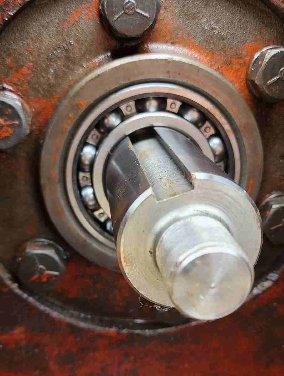

So today was the day and I finally got to start putting the new drive shaft in the grader!

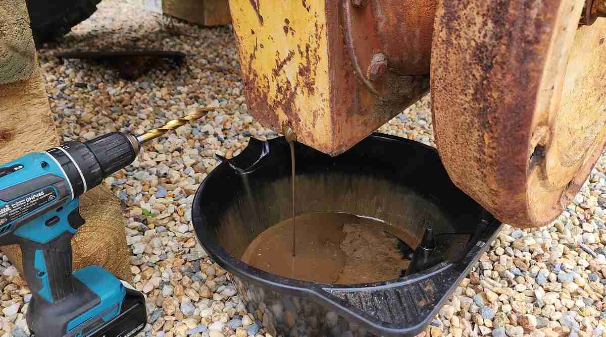

First job:drill a new drain hole at the back of the chain box because there was no way I was going to bail the remaining 15mm of oil out through the side hatch. That oil was nasty...
Drilling of a 10.8mm hole was followed by tapping and the installation of a sump plug with crush washer. Took me forever to find the right size drill bit (10.8mm - seriously? I had to buy that online couldn't find it anywhere on a shelf) 12mm (UNF I think) taps (which everyone had sold out of) and bungs to suit (which were thankfully easy enough to find), but it worked out really well - and the (horrible dirt laden) oil made the tapping pretty easy - free lubrication!
A side note here - when I was measuring up the chain box to work out where to put the drain hole it became apparent that Allis Chalmers A. weren't playing - those chain boxes are made of 12mm / half inch steel that my HS drill bits took their own sweet time getting through and B. did not care in the least how the result looked. The end plate is just slapped on there and welded in place. Alignment? Who cares? it won't matter once it's welded on!
Next step, clean out about four liters of oil, 3mm of mud, and - I kid you not - enough ball bearings, split pins, and shards of metal to make a disaster movie. Bad things happened in that chainbox somewhere in the past (yes that a little bit of foreshadowing). But it all cleaned up pretty nicely in the end - after repeated flushing with diesel (shaking the grader around to slosh the diesel was the hardest part), then lots of wiping out with cloth rags that went straight in the bin!
Looks rather nice in there now:
Next step: insert the new oil seal. I didn't have anything to press it in with, so I went for the "lump of wood hacked into a workable shape" option. It worked. I don't think that the seal suffered any real damage.

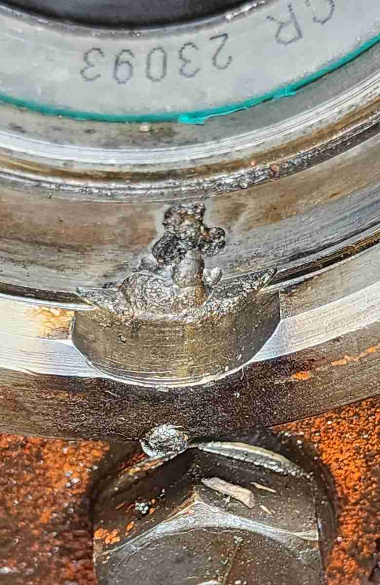

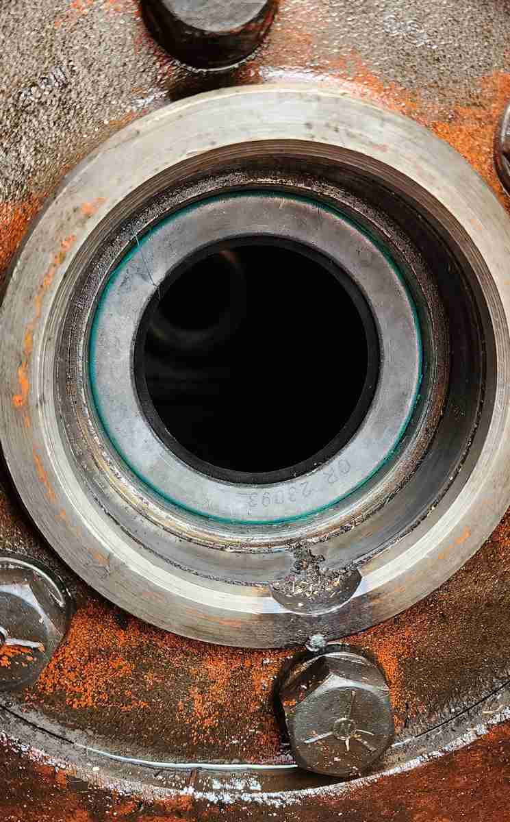

The eagle eyed among you will notice that something bad happened to the bearing seat in the photo above. Here's a better view:
I have no idea what, but I'm guessing that it was involved in the installation of the scrap bin of metal parts and shards in the bottom of the chain box some time ago. Still, I think it just looks nasty and shouldn't effect anything. And yes I did clean out the bearing and snap ring seat before I proceeded.

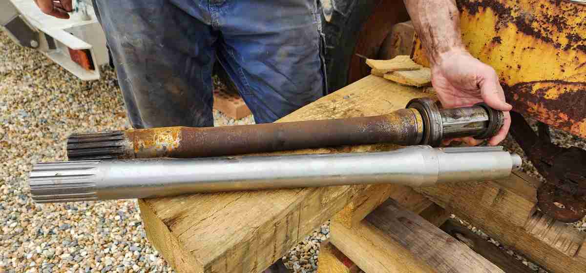

Then it was time to pull out the new driveshaft:
Don't ask me how but the (phone) camera makes these two *identical* shafts look vastly different lengths. Thankfully they aren't and I have other photos to prove it - but look at that shiny new metal! Mmmmm... shiny.
Shaft went in nicely, then I pressed the bearing in.  Thankfully while firm, it wasn't nearly as tight a fit as the oil seal, so I managed to slowly, gently tap it in, again with appropriately hacked wood. I got it in flush with the housing, but ran out of time to shape another piece of wood to let me push it in further. But it's in place at least!
So, having run out of time I buttoned everything back up to keep the water out and called it a day.
I'll be back to it on Sunday hopefully. Get that bearing finished, install the snap ring (I have a bad feeling that is going to be a fight), install the centre sprocket, reinstall the chains, fill with oil, make up new gaskets for all of the chain box ports, then bolt the ports down.
Then I have to go de-sludge the other side... (at least I get to use my expensive, weird drill bit and expensive, rare taps again).
So more photos and narration will follow!

Good progress and thanks for the update. I've seen all kinds of bearing bores destroyed over the years and that one won't hurt anything as the outer bearing race is tight to the bore.
Before you button it up, I would get some oil into that bearing whether it be a thing gear oil, or even a thin bearing grease. Reason being is that even though that is a lubricated bearing, it has none upon initial startup. It is perhaps submerged in oil and if the case then no pre lube is required but I always grease them upon installation as the grease will disolve into the lubricating oil but dry startup is never a good thing with roller bearings.
That's All Folks!
Points: 89281
Post Options Post Options   Thanks (0) Thanks(0)   Quote steve(ill) Quote  Post ReplyReply Direct Link To This Post Posted: 25 Jan 2024 at 8:21am
Those SPOTS where the bearing sets actually look like caused by an arc welder ?  Im wondering if they could not get the race out and welded on it to shrink it... Dont know how they got that deep, but look like local hot spots / points from a weld stick..
I have used a welder to WELD on the race.. This actually looks like they were trying to BURN the race in half.. Carbon arc.. or HIGH AMPS on that stick.
Edited by steve(ill) - 25 Jan 2024 at 8:22am

That was my thought too with attempting to remove a former race. I've never had to split one in it's bore but have welded a plate to the inner side to pull with a slide hammer a couple of times when the backside was not accessible.

Yup, I have welded bearing races to shrink them, if you get it right they just fall out

Welding out a race was my first though too for the missing material.
Lots of loose parts... Don't you wish these things could tell us their stories sometimes?

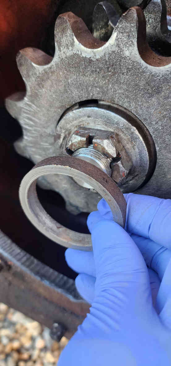

I got back to do some more work today. Got the bearing seated properly and the snap ring in place. Then I put the double gear on the new shaft. Was going well until I figured out that I had forgotten one thing…
The spacer that is meant to go between the bearing and the gear…
Oh well. Have to take a trip to town and buy a gear puller tomorrow, pull it off, install the spacer, then put it back on again. I live and learn, but making progress.

I think we've all done that, (or similar) a time or two over the years. Good you caught it now rather than finding it under a bench remembering, "I remember dropping that" and never retrieving prior to the next task and then forgetting all about it.....

Codger - oh yes - definitely better to catch it now! And it has the rather important job of maintaining a gap between the bearing and the drive gear - which allows oil from the chain box to circulate to the bearing.  So missing that would have been BAD.
