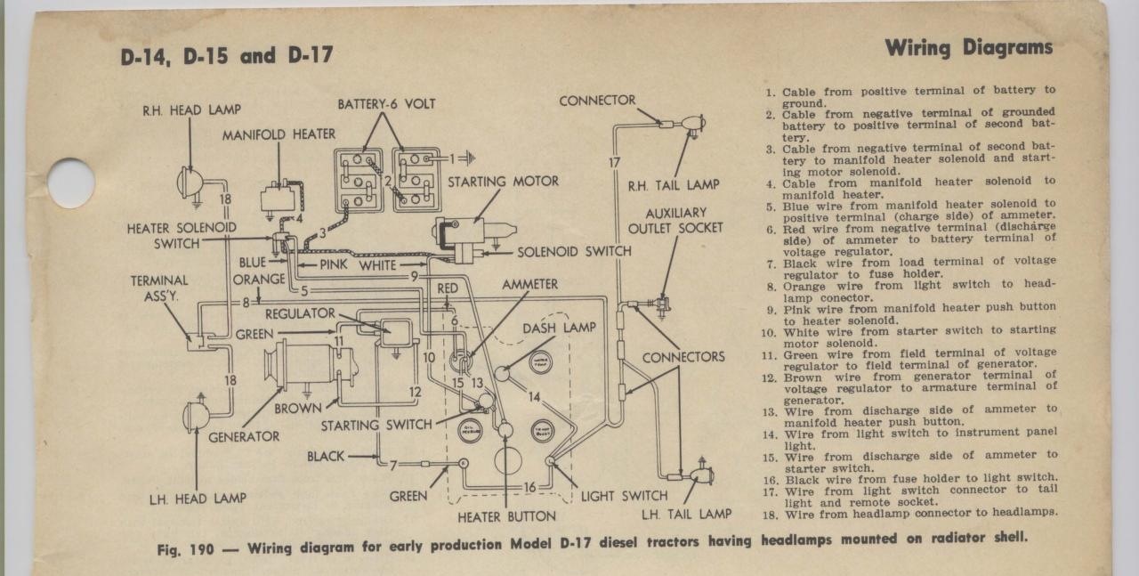

My D17 has starting / electrical issues.
The tractor is wired negative ground, and, when it works, the tractor starts fine. To me this implies it must have been set to run negative ground, else the starter would spin the wrong way, yes?
I'd like to fix the wiring, but I'm not sure how things should be wired if it's negative ground. I also see a manifold heater mentioned in the wiring diagram in the I&T. Is that on all diesels, or was it an option?
Thanks in advance.

The starter doesn't care which polarity. Manifold heater is only available on the diesel. Generally speaking it doesn't matter which polarity your tractor is configured for, but negative ground has become the standard. It's hard to find a 12 volt add-on accessory that isn't negative ground.

And the regulator is OK?
I should say that the wiring is a bit of a dogs dinner, so I want to go thru it all with my meter, I just wasn't sure how things like the starter, regulator, and so on work with reversed polarity, I knew the lights would be fine, what about the temp gauge?
Being diesel, with no solenoid fuel shutoff, once it's running, it doesn't need electrical power, which is good as it doesn't generate any just now

you should have a 12 volt regulator.. some were OK for pos or neg ground... it might be printed inside the cover... You need to "polarize" the charging system once to tell the system how you have it connected... Normally taking a jumper wire and flashing the B and G terminals for 1 second will do that.

Unless someone has changed it to electric, it has a mechanical temperature gauge as indicated on the wiring diagram you posted. The ammeter should be the only electrical gauge on the tractor.

This being the advantage of negative ground. If you ever need to replace a gauge, electric gauges are more readily available. Most are negative ground.

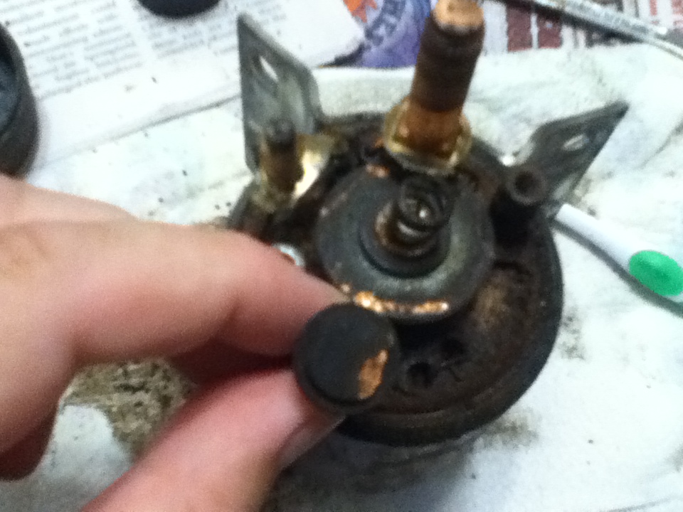

I'd like to get mine working, mainly because I don't have power in my storage shed. To that end I tried polarizing the generator today, 12V to the A terminal, still don't get any voltage on the A or B terminals wrt ground. I didn't try unhooking the connections as I recall maybe generators shouldn't be run unloaded?
My starting issue however isn't electrical, it's electromechanical, the solenoid on the starter always engages, but doesn't always connect the battery to the motor. Tried cleaning the exterior part with brake cleaner and WD-40, but it looks like I may need to pull the starter to get to it.

I don't know what is "loose" on your starter solenoid... There should be a small and large wire on the back that are TIGHT on the terminals, and a strap that connects the solenoid to the starter... all studs should be TIGHT.... if there is a cover on the other end that is loose, that may or may not be a problem.

Where is the regulator located?
The jiggly doo-dad is from the solenoid on the starter to like a cam switch of some kind, which has a slot in it and the end of the solenoid but is loose in the cam slot, it's the opposite end from the terminals. I'd expect it to engage the gear for the starter, and that always clicks, but sometimes it doesn't connect 12V across the solenoid, so the motor don't spin.
This is the diesel D17, a 1957 if it helps. I can snap a pic of it tomorrow, no light in the shed. How do those starters come out? 1,2,3 or 4 bolts?
Sorry, I'm faultfinding both the charging and starting at the same time, hence the unrelated questions.

Don’t overlook a failty ammeter. All the charging current flows through it.

You description sounds like the lever that moves the starter drive to engage the ring gear is exposed on that starter. If that is the case that lever will have some play. When you turn the key to start the solenoid should receive power to turn it into a magnet. It should pull the plunger inside it forward, causing a plate inside the solenoid to make contact between the large solenoid terminals, supplying power to turn the starter motor. At the same time the solenoid should pull the lever with it moving the starter drive into mesh with the ring gear. If all the connections are good, you are sure it is not loosing voltage or ground when you engage it, and the solenoid is clicking; you may need to pull the starter with the solenoid on it and have them gone through or replace them. Find your starter at the AGCO parts books on line and it will help you identify the "jiggly doo-dad", for others.
I don't know about a D17 but on a D14 the voltage regulator is behind the panel on the left side of the tractor, under the fuel tank.

Thanks Jim, I figured it (doo-dad) was meant to be exposed, as it was painted orange.
Yes, best I can tell I always get the click of the gear engaging, but my 12V rarely appears on the other large terminal, it's solid on the lower one, but the upper one only sometimes happens.

The lower terminal I have to assume is the one on the solenoid with the positive battery cable hooked to it, as you say 12 volts is solid there. Check all the battery cables and connections again. A bad ground may loose connection when power is applied to the starter. Check the terminals and lug fittings on the cables closely. If it is not already, connect the ground cable to one of the starter mounting bolts or other bolt on the engine block. If the solenoid has two small wires as well as the two large ones, one should be a ground. Make sure the wire is good and well grounded. Make sure the tractor is in neutral and try using a jumper wire to energize the solenoid (jump between the large battery positive cable on the solenoid and the terminal that has the small wire from the switch connected to it) to bypass the start switch/button. If that makes it works you likely have bad start contacts in your switch or starter button. Once you are sure the cables and connections are good and you have tried bypassing the start switch and the solenoid still only clicked, it indicates at least the solenoid is bad. At that point you should consider removing it and taking the starter, with solenoid on it, to a good electrical shop to be checked out and repaired or getting a replacement unit.

I'm gonna go out on a limb here, and say I found the problem.
That center washer is the contact point (I reckon), when the solenoid energizes, it gets pushed agains the contact points of the two bolts. Given that it, and the bolt bottoms are black with crud, I'm going to say that's where I've been losing the connection, the two shiny points must be my intermittent.
A few minutes with a dremel, and everything is nice and shiny again, and a bit of epoxy seals the crack in the case for now. We'll see if it works, and if it lasts. It's too wet right now to go out and fit it all back in the tractor.
Worst case scenario, a new one is $20 on eBay.

Lots of wear on the bolt you are holding. Turn it 180 when you re-install it. Yup, that could do it. If it does it again just give it a toss. That one looks like it's gone beyond its design life. Copper oxidizes. A silver plated one wouldn't. At least silver oxidation still conducts.

Yeah, I'd have been more tempted to take it apart if it didn't have a weird 5-pointed screw holding it together. I just cleaned it and the bolts up with a dremel, sealed the crack in the plastic cap, and put it all back together.
So far, it's started everytime.
