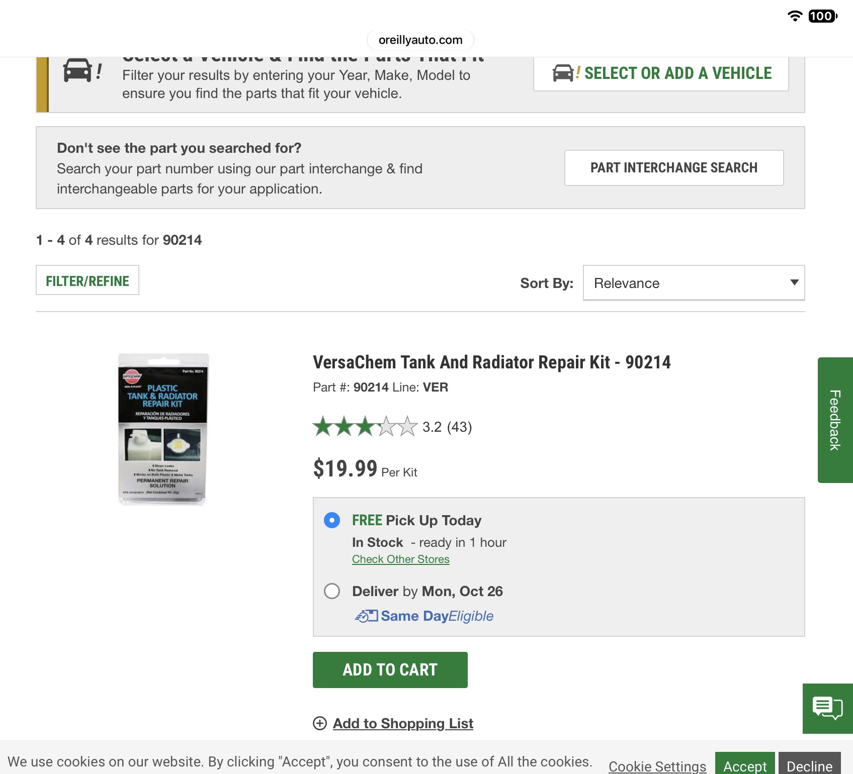

Iused this on my daughters Kia 3-4 years ago for a crack, still holding

I will check this out, it’s on the radiator itself, not the overflow tank.
