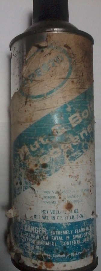

Seems we discussed the best penetrant oil issue before but I don't find it in search. And here is my dilemma, I bought a box of stuff at an auction a few years back and there was an old can of PRESTO - NUT AND BOLT LOOSENER in the mess..,. I have used it  lot and seemed almost like magic to get things loose tho there were some things that ended up getting twisted off but most of the time it was fantastic stuff.  I can not find it in google search or amazon or ebay... did find a one google search from germany but sure did not look like my old can... 19 OZ of the stuff. Here is a pic of my can, does anyone remember this stuff? label is pretty faded and frayed.
back side says something like something... Chemical Company,    ???YWOOD ??  ?1605
Did some search on best penetrant oil and got this...
   At $25.82 for 16.5 OZ. OUCH!

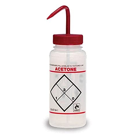

this came up when doing a search for NUT AND BOLT LOOSENER;
(might be the same product as PRESTO; it may have been bought by TERAND)
I think the price of $130 is for a case of 12 which doesn't sound too bad, but if you order it, make darn sure.
I've used the 50/50 mix of Acetone and ATF for quite a while with good results.
If you keep it in a plastic dispenser bottle with a thin spout, the acetone doesn't evaporate out.
sample;
https://www.walmart.com/ip/Unique-Bargains-Lab-Right-Angle-Tip-Plastic-Liquid-Storage-Squeeze-Bottle-Dispenser-250mL-3-Pcs/881892438
Edited by Gatz in NE - 22 Jun 2020 at 5:38pm

If you put acetone in a plastic bottle, it won't evaporate; it will eat right through the plastic bottle.
Gatz in NE View Drop Down
Location: Lincoln, NE
Points: 1063
Post Options Post Options   Thanks (0) Thanks(0)   Quote Gatz in NE Quote  Post ReplyReply Direct Link To This Post Posted: 22 Jun 2020 at 10:14pm
Curt,
the mix has been in a plastic bottle for over 2 years; no problems

Definitely NOT true. We've had a squeeze bottle of pure Acetone in the lab for 10 years now. SOME plastics, probably, Styrofoam DEFINITELY (in seconds), but it surely can be done.

Another option is to get an all-metal squirt can with a flexible metal tip.  I have been using them around the farm for years without a problem.  One of them is for holding my 50/50 acetone/ATF mix.
I bought the cans I use at Tractor Supply, but they are probably available at lots of other places.

I had to go to 'metal can' with my acetone and auto tranny fluid.  wouldn't even last a year!   best thing i found for stuck pistons in hydrogen peroxide!  cheap, readily available and it's worked better then anything for me!
