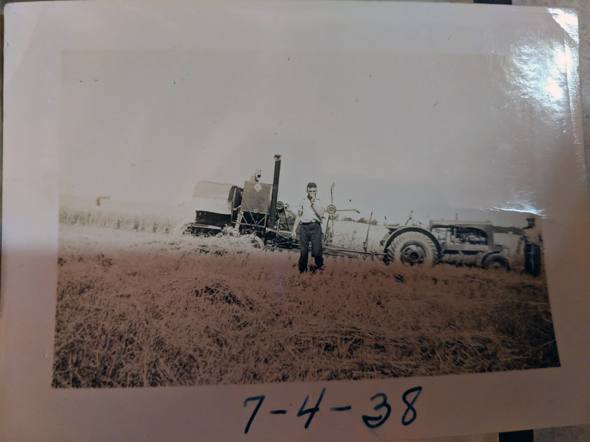

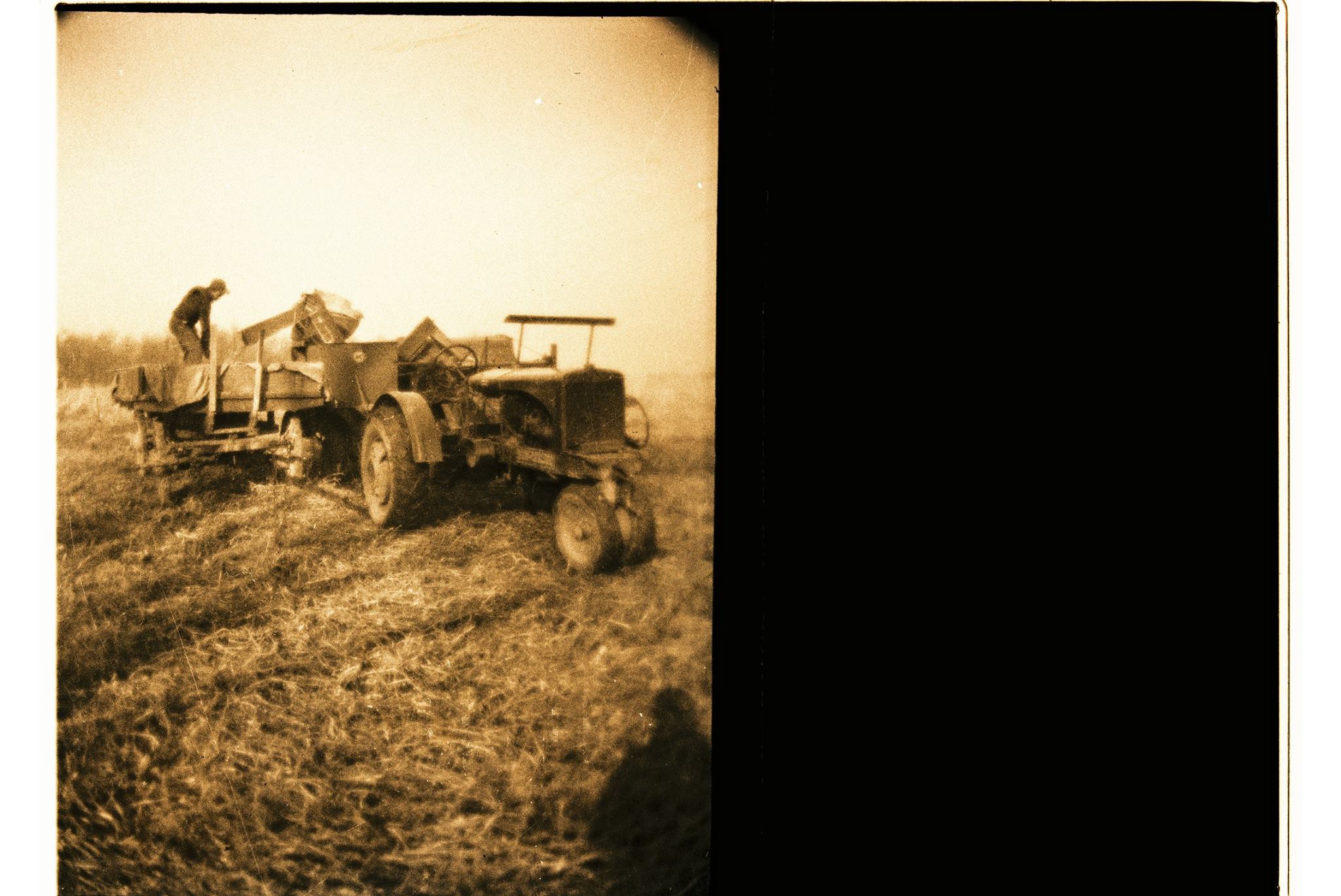

This is a picture of my grandpa with one.  Story was he bought a WC and All-Crop in 1936.  I know form family pictures that by July of 1938 he what looks like a regular model 60.  I will try to post the picture of it too!
