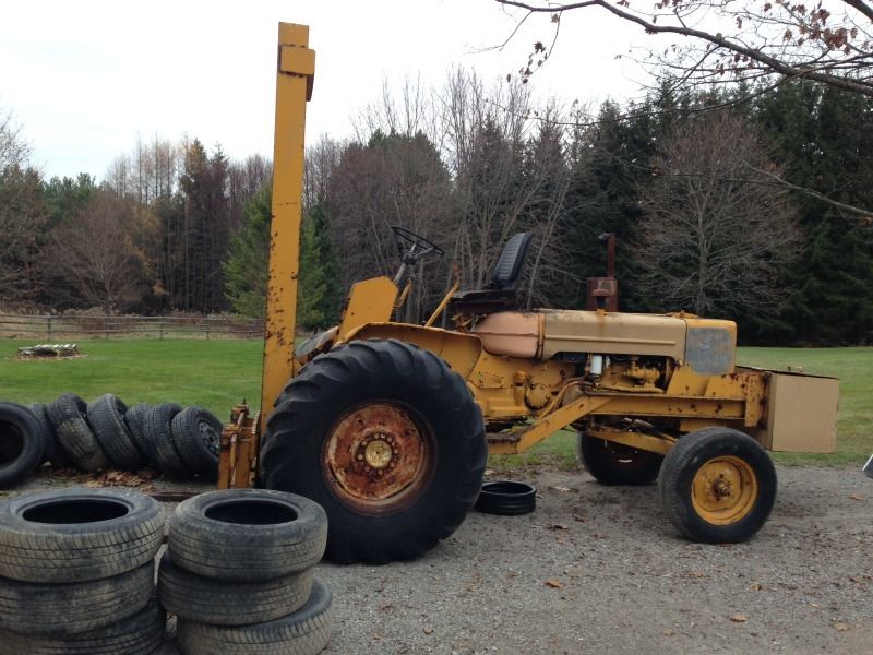

Hello, I am new to the site. Just picked up an old allis chalmers fork lift and am looking for some info on it. I think it is a I-60 but am not sure. Just want to findout a few things to give it some TLC like what hydraulic oil to use for the lifting. It has shuttle shift, and everything seems to work decent, needs some new roller bearings and the chains oiled but seems to work. Any help on this would be great.

I bought one just like it last summer, great tractor to have around. I just run regular hydraulic fluid in mine.

Looks like I 600, series 2 muffler, and a hard nose radiator shell, although it could be a johnny cash put-together!

if you mean mast rollers typically the bearings are not replacable separate from the roller. you may be able to get them from a bearing supplier but i'm not sure. a good forklift dealer should be able to help

Yhea i meant mast rollers. That's probably what i will have to do is take one off for measurement and see what I can get.  I hope to give the old girl a little love. the rollers on it have some flat spots, the mast still goes up and down but the rollers don't roll. I tested picking up an old chevy caviler, it got it up off the ground but didnt want to much higher than a few feet, it would tilt in and out with no problem but didnt want to g any further, could tell it it was just the rollers binding. I picked the thing up for 1500 and the guy had just put a new alternator on it and had the carb rebuilt. I am going to change the hydraulic fluid, seems a little thick and want to make sure it's clean. Not sure what to use though. It's a little tough to steer when it's below 20 deg.

If it wasn't binding I think the only reason would be lack of oil because if it lifts the entire car off the ground a foot it should lift it all the way up. It takes a lot of oil to fill the lift cylinder and I'm not sure how much extra is in the reservoir, if it's a little low that might do it.

I've seen rusted chains stop them  dead. we even had a rep from mit/cat forklift tel us the only true way to lube the chains is to take them off and soak them

The mast rollers may be something that you could find if you do a search for "Cam Follower". It's a common industry style of bearing that's intended just for the purpose of following a rail... very handy.

I did find the serial number right after I had made the first post. So I went over things again and did another test lift, and yup it seems that its the rollers that are keeping it from lifting anything heavy very high. So new rollers is top priority. I will look at napa, I also went to an old school tractor store that use to be an allis dealer years ago. He says he could get them but that they wernt cheap, a 2-3 hundred each roller. I hope i can find them for less than that. i was thinking of around $50 each, $100 tops. See if i can come up with anything this week. But boy is it a hooot to play around on.

Well I have been making some good head way on the rollers. I went into to a load lifter dealer 15 min from my place and they knew all about what I was looking for. He is just going to give me a newer trolley to be able to put newer style bearings on, because the ones i took off just had a brass bushing.  Had another quick question, does anybody know what the machine weight is? I am not totally sure and don't want to overload the trailer.

A diesel d-15 II weighs about 4200 #, so add the weight of the mast, and counterweighting, and you prolly have a tractor that weighs in the neighborhood of 6-7K #.

looks like an old KD brand Forklift made in Waco Texas. now owned by Manatou in Waco still has parts.
