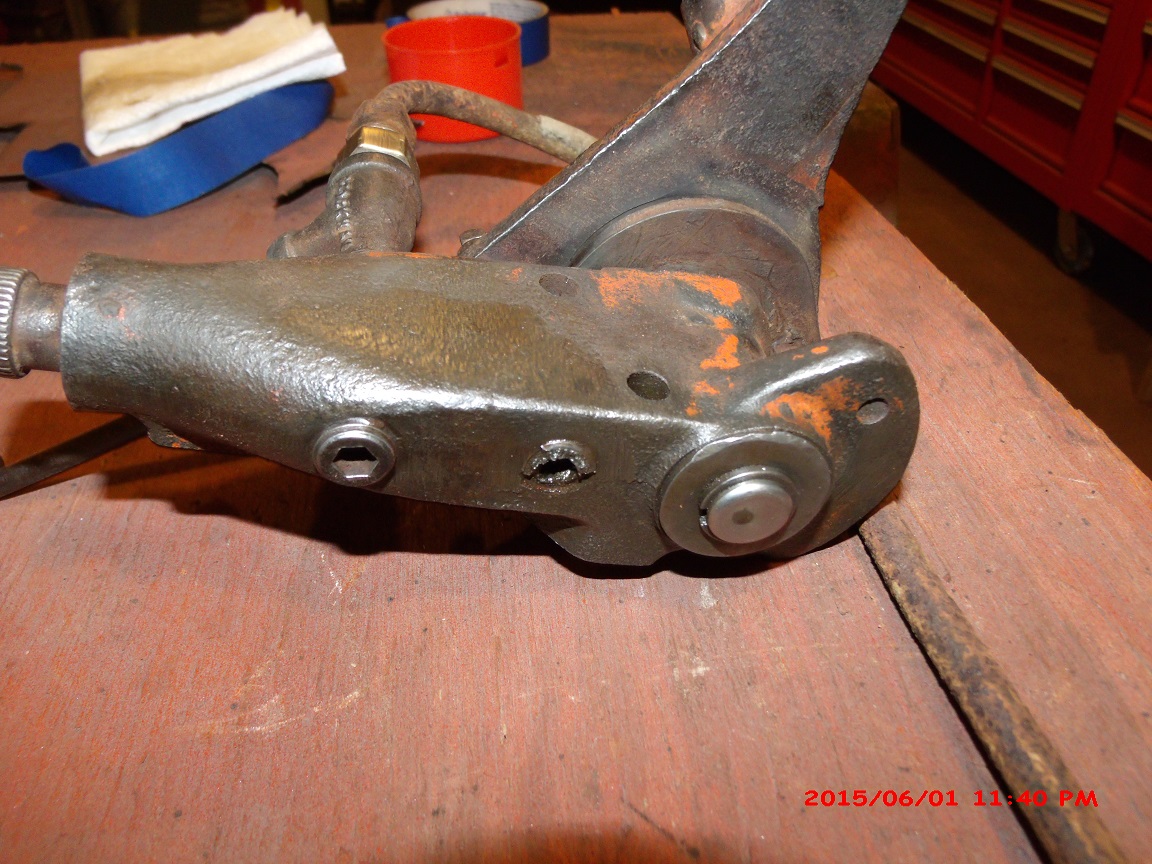

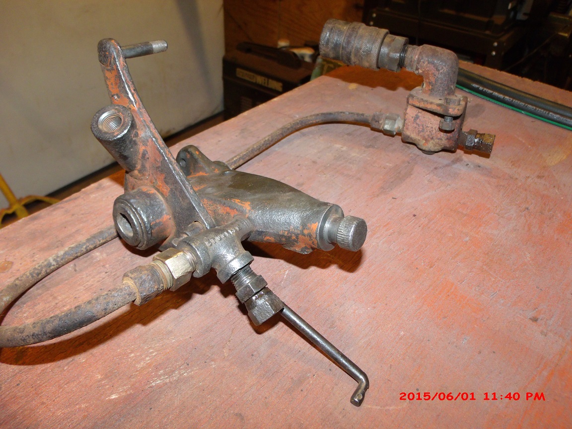

I have 3 cylinders on my CA. I'm in the middle of a restoration so I apologize for the disassembly. The rear cylinders hook up to the fittings facing to the right in the HYD2 picture and the forward cylinder screws into the port in HYD2. You can see in the HYD2 picture the fitting broke off and I have to coax it out. We never used a belly mower but this hookup worked great with the cultivators. Changed setting on the control for traction boost when pulling the disk or plow. It's been a few years so I may be a little foggy on how the settings work. I'm new here and I'm still trying to get the picture sizes right...

Post Options Post Options   Thanks (0) Thanks(0)   Quote MrHDC Quote  Post ReplyReply Direct Link To This Post Posted: 02 Jun 2015 at 12:05am
Please disregard the picture numbers. I got them wrong anyway but I think the pictures speak for themselves.
