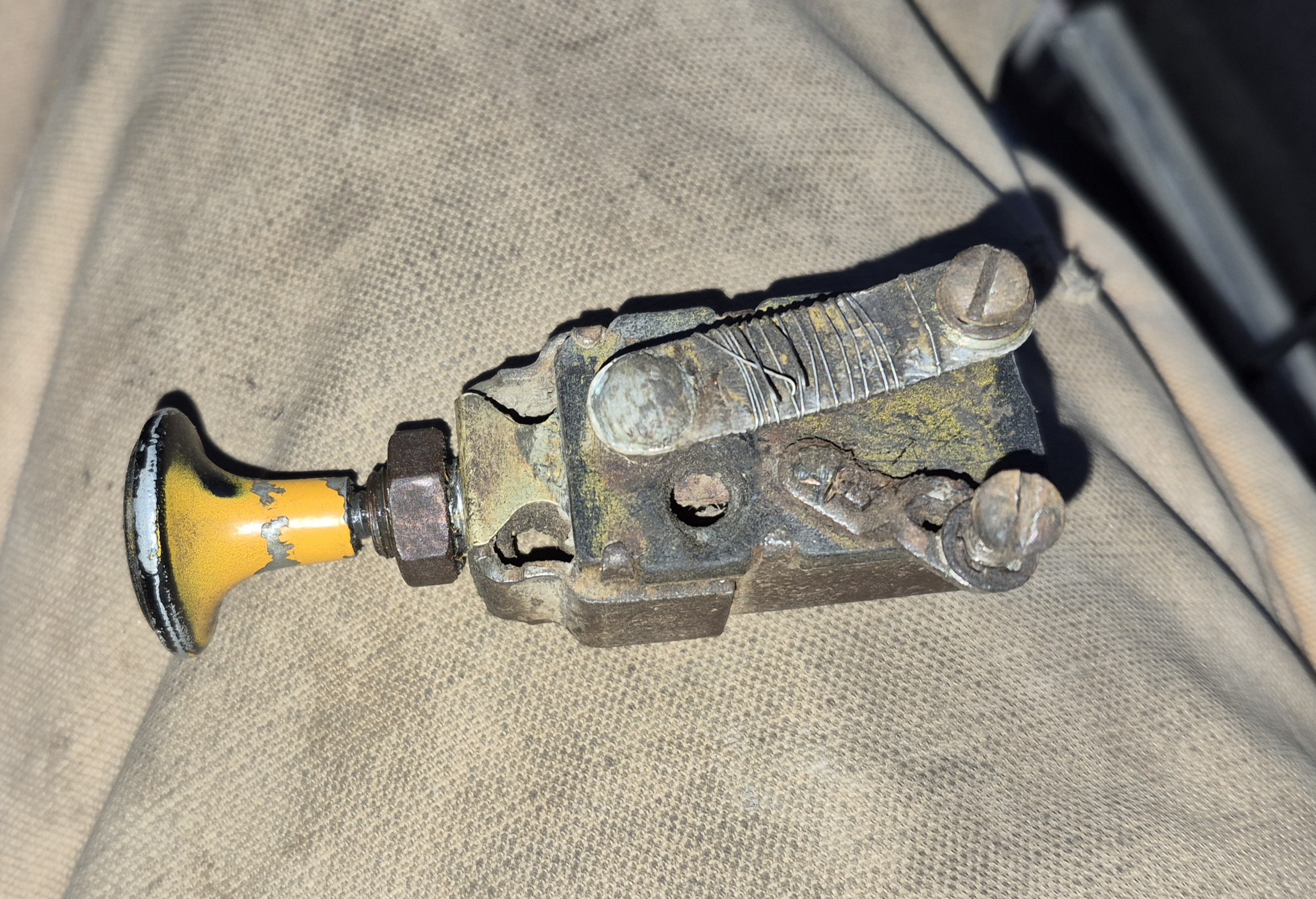

I need some help figuring out the correct way to wire the light switch up. When I bought the tractor the original switch was missing one wire,seized up and broken at one terminal. Its a 3 position push/pull switch with built in resistor very similar to what a WD-WD45 uses to control the charging system. Actually the aftermarket POS Chinese switch is the same between the 2. Anyways the wire frome the resistor was missing on the original switch, one terminal went to the fuse/lights the other to the voltage regulator. Should the wire from the resistor go to the load side of the amp gauge? There is no wiring diagram in the operators, parts or repair manual for this tractor and I can't find anything online. There's online diagrams for the gas tractors but they use a completely different style of switch as that switch also controls the ignition system.

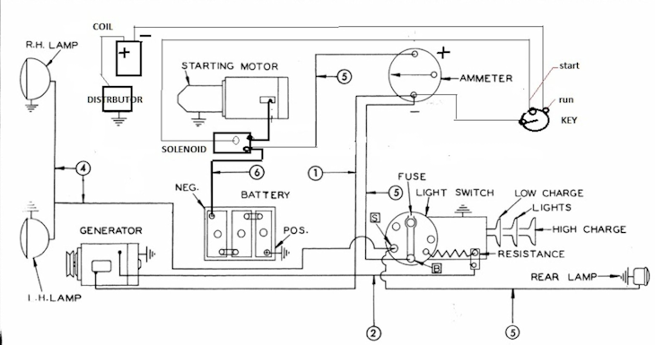

I have never so much as touched any M-M.
The Allis system uses the resistor to apply either a Full-ground to the generator field (High  Charge), or a Partial-ground through the resistor (Low Charge). The resistor is not connected to the ammeter or any other power source.

Post Options Post Options   Thanks (0) Thanks(0)   Quote Les Kerf Quote  Post ReplyReply Direct Link To This Post Posted: 12 hours 21 minutes ago at 9:54am
Wiring diagram for a typical AC Model CA

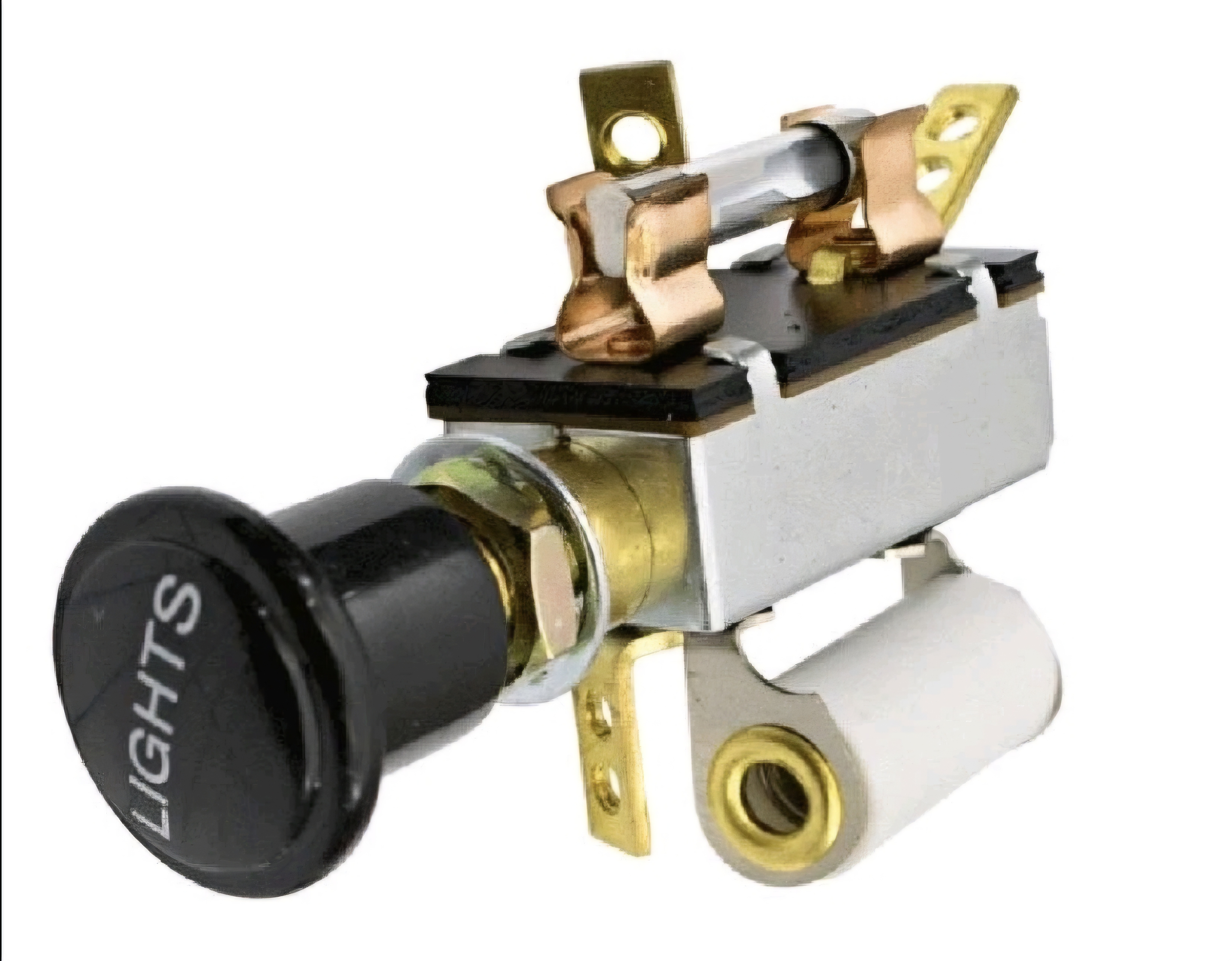

Post Options Post Options   Thanks (0) Thanks(0)   Quote grinder220 Quote  Post ReplyReply Direct Link To This Post Posted: 11 hours 11 minutes ago at 11:04am
It is a factory 12v system. Here is a picture of the new switch and the original for comparison. The charging system was not functioning when i bought it. The regulator was shot,not sure on generator condition yet. So the lights should be connected to the resistor terminal then? What wire goes to the fuse on the switch then? Original has a fuse on the dash like a hundred series allis uses. Does the regulator break connection on its own then the generator stops spinning?

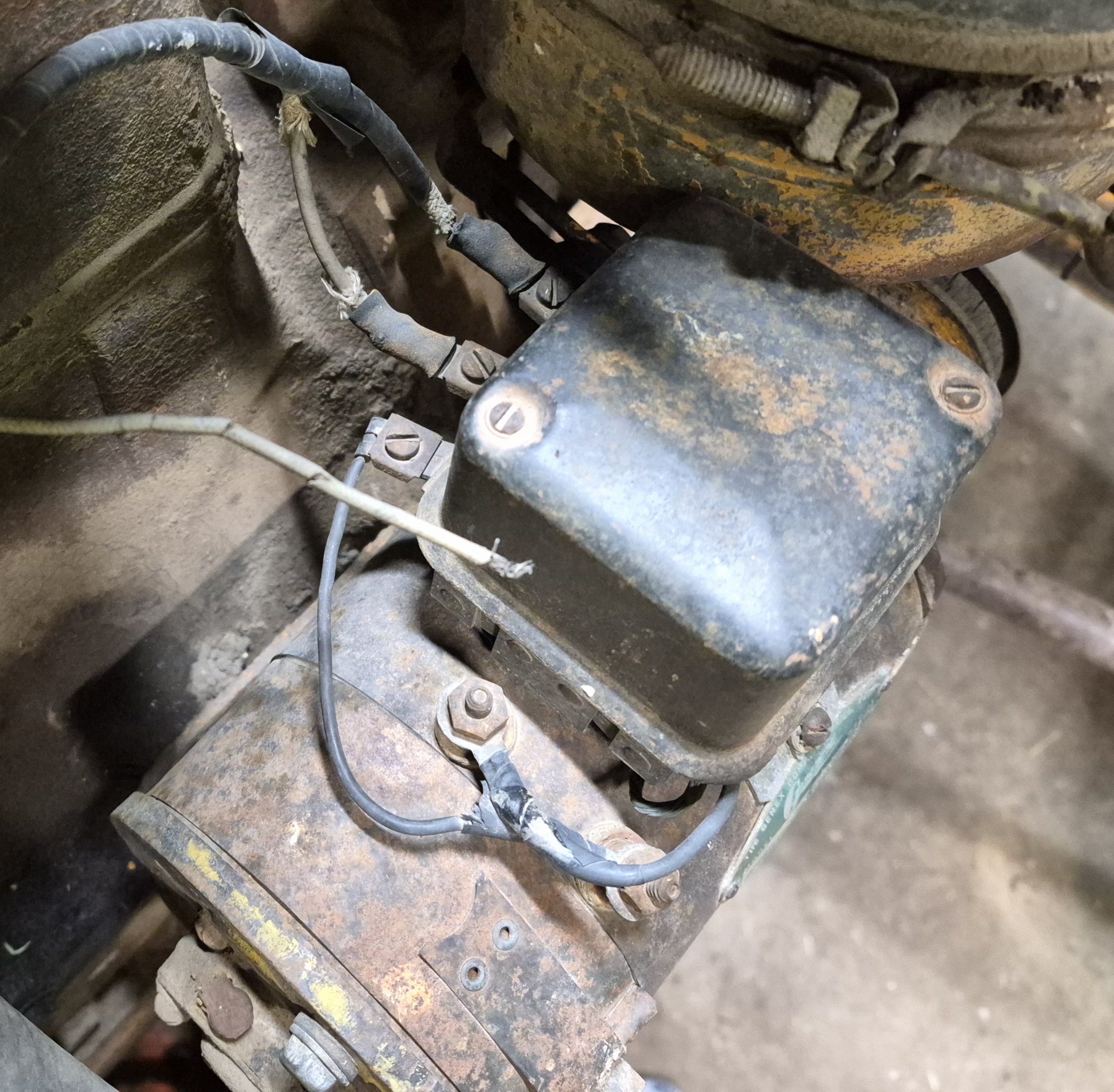

Post Options Post Options   Thanks (0) Thanks(0)   Quote grinder220 Quote  Post ReplyReply Direct Link To This Post Posted: 8 hours 39 minutes ago at 1:36pm
It's a regulator not a cut-out,the broken wire shown is for the front right headlight

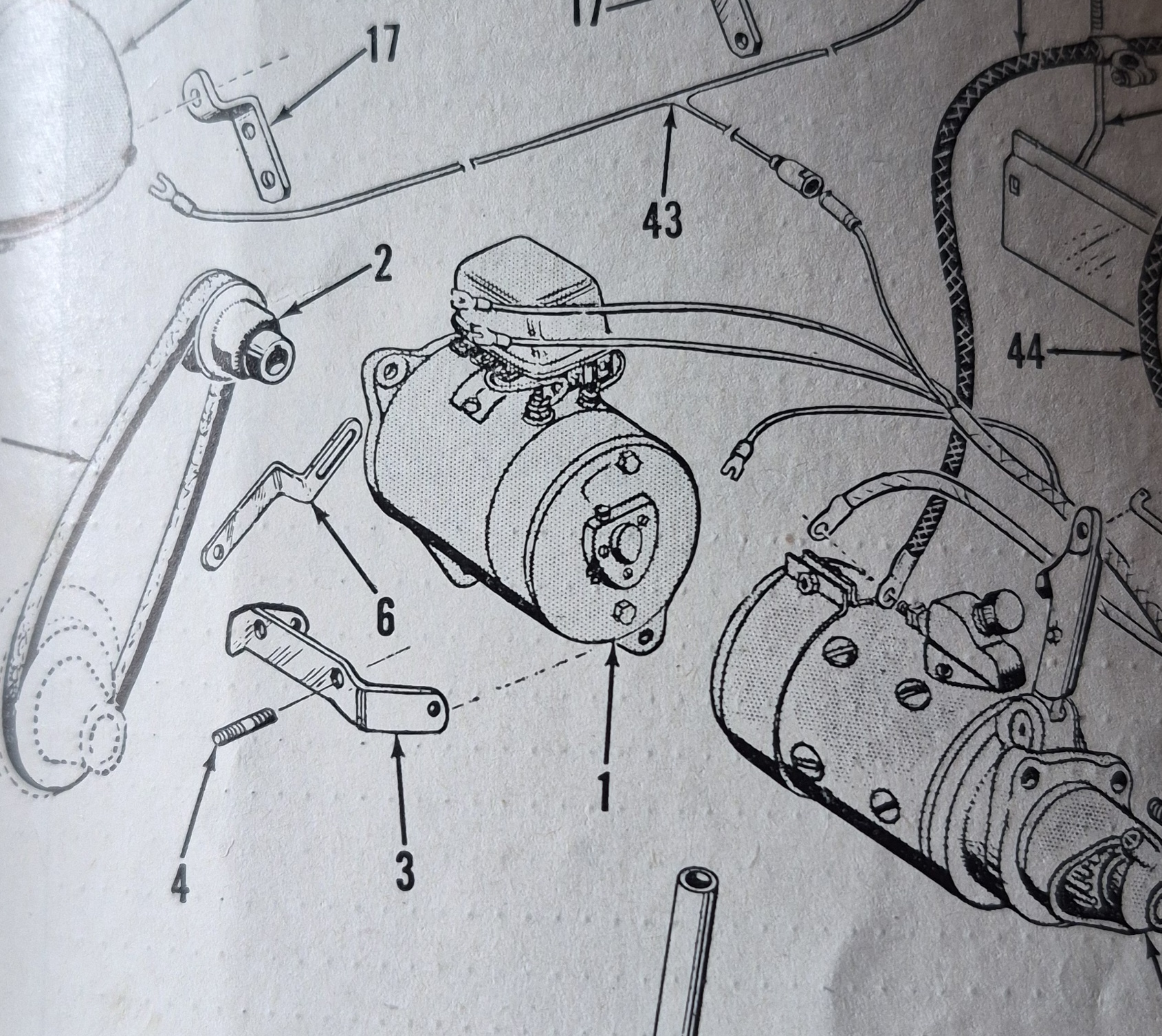

Post Options Post Options   Thanks (0) Thanks(0)   Quote grinder220 Quote  Post ReplyReply Direct Link To This Post Posted: 8 hours 32 minutes ago at 1:43pm
Here's a picture from the parts book, doesn't state regulator or cutout
Points: 1658
Post Options Post Options   Thanks (0) Thanks(0)   Quote Les Kerf Quote  Post ReplyReply Direct Link To This Post Posted: 6 hours 33 minutes ago at 3:42pm
Originally posted by grinder220 grinder220 wrote:
Here's a picture from the parts book, doesn't state regulator or cutout...
It has multiple wires going to it so it is must be a regulator rather than a cutout.
With an actual regulator you definitely do NOT want that resistor connected to anything involving the charging system.
As far as dimming your lights, I would leave that alone until you can get it charging properly.

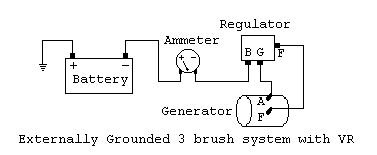

Post Options Post Options   Thanks (0) Thanks(0)   Quote steve(ill) Quote  Post ReplyReply Direct Link To This Post Posted: 6 hours 10 minutes ago at 4:05pm
Agree... with a voltage regulator, the ONLY THING a resistor on the light switch could be used for would be to Dim the Lights..
if your regulator has 3 terminals ( none on the bottom) then it wires like this.. If the regulator is 20 years old or more, it probably is causing problems with charge..
If you have a 4 terminal regulator ( one on the bottom)... then the "L" terminal on the side can be used to feed the LIGHTS..

Post Options Post Options   Thanks (0) Thanks(0)   Quote grinder220 Quote  Post ReplyReply Direct Link To This Post Posted: 6 hours 4 minutes ago at 4:11pm
Ok, I want to make sure I hook up the switch correctly. The terminal with the fuse would go to the amp gauge,the resistor to the lights and the other to the regulator then, is that correct?

Points: 1658
Post Options Post Options   Thanks (0) Thanks(0)   Quote Les Kerf Quote  Post ReplyReply Direct Link To This Post Posted: 5 hours 20 minutes ago at 4:55pm
You want to make sure that the NEW SWITCH does not GROUND the RESISTOR outlet side to the SWITCH CASE.... thats what MOST of them do when used with the 6V generator.
Yup.
If that new switch is indeed identical to an Allis-Chalmers style light switch then the resistor will apply ground and you will let the smoke out of something that you would rather retain un-smoked.
I would NOT connect that resistor to ANYTHING for now.
Points: 90994
Post Options Post Options   Thanks (0) Thanks(0)   Quote steve(ill) Quote  Post ReplyReply Direct Link To This Post Posted: 4 hours 11 minutes ago at 6:04pm
Agree... the resistor is Useless.. Forget it... You can use the switch to turn the lights ON and OFF... thats all you need on that end.. For the CHARGE system, follow the drawing above for the regulator / generator..
