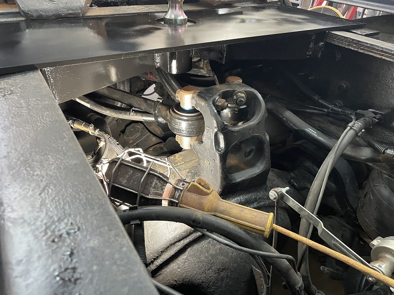

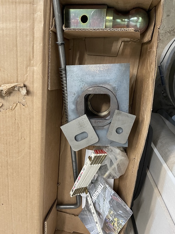

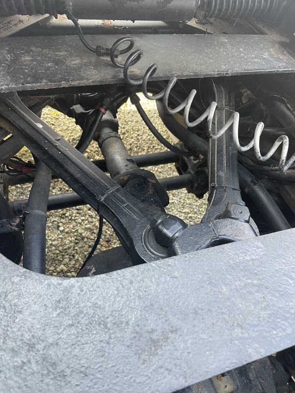

Package arrived last night, Well made and substantial material construction.  Plate to install should be here latest by Monday or Tuesday.
In NOT using on a Pickup or ton flatbed will be modifying the Release lever mechanism for 1: access and 2: functionality.

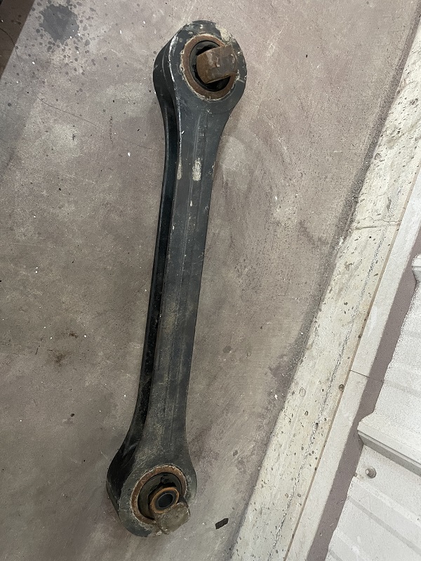

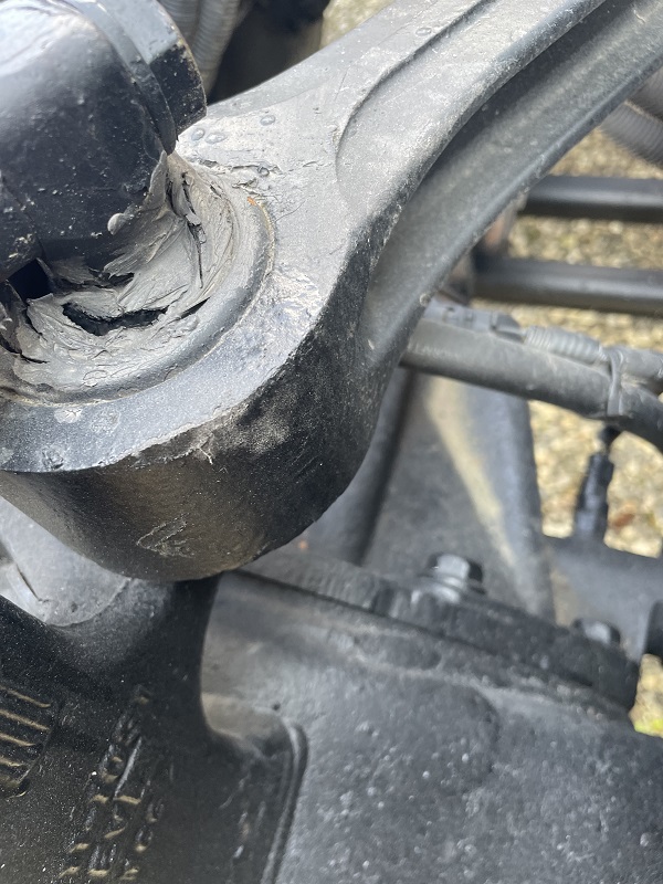

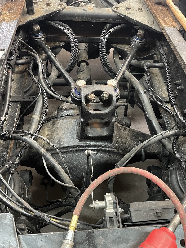

While aligning to install this noted had three bad torque arm bushing, Age Dry rotted. Called KW and was shocked the Old Style arms bushings are NLA, they are now installing a Aftermarket Type from ATRO Mfg.  KW still sells the Big Aluminum Forged arms however are substantially Higher than the aftermarket and have to be Ordered as no longer a Stocked Item.   New arms are Steel with Urethane Bushings as opposed to Rubber.  Will be replacing ALL four as a Matching Set.
The replacements also aid in Space to install that Flip Over style ball hitch.

Nothing wrong with ATRO bushings. My preferred install and they will outwear the originals by about 3:1. Not that it matters in a hobby truck I know but the cost offset isn't that bad for the service provided.

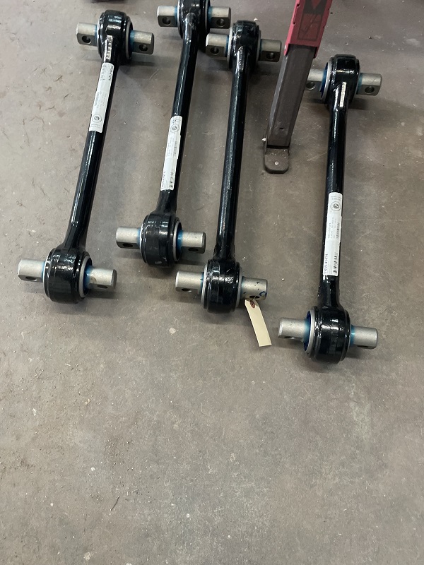

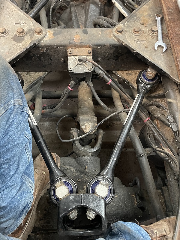

Started as early as usual this morning.  Cleaned up and organized shop for the work.  Start for real at 10, pulled fifth wheel two bolts broke, several not look so good so ordered replacements with Washers and New Lock Nuts, then set to swapping torque arms.  Photos to follow.
All four done by 2pm, Bolts appeared excellent shape, reused all.  Managed to get all the Zip Ties restored then de-scabbed rust on Frame Flanges and fifth wheel mount angles, painted with the Encapsulating paint used on the Ford.  Have two angles still here was going to use to Set fifth wheel rearward, should work fine for Goose Ball plate that is also here.  So working on Goose hitch tomorrow.

Pics

I like ATRO too, they make a fine product, just remember this important detail that ATRO will NOT tell you: Rubber absorbs vibrations, poly TRANSMITS it. Whatever driveline vibrations the OEM rubber bushing absorbed are now being transmitted to other parts of the truck. Any rubber bushing left on the truck will now have to pick up the void left from the OEM bushings being gone. Poly outlasts rubber 3-1 partly because its not doing the job the rubber bushings did, its just passing it along.......

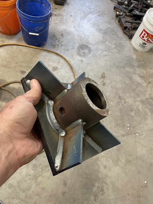

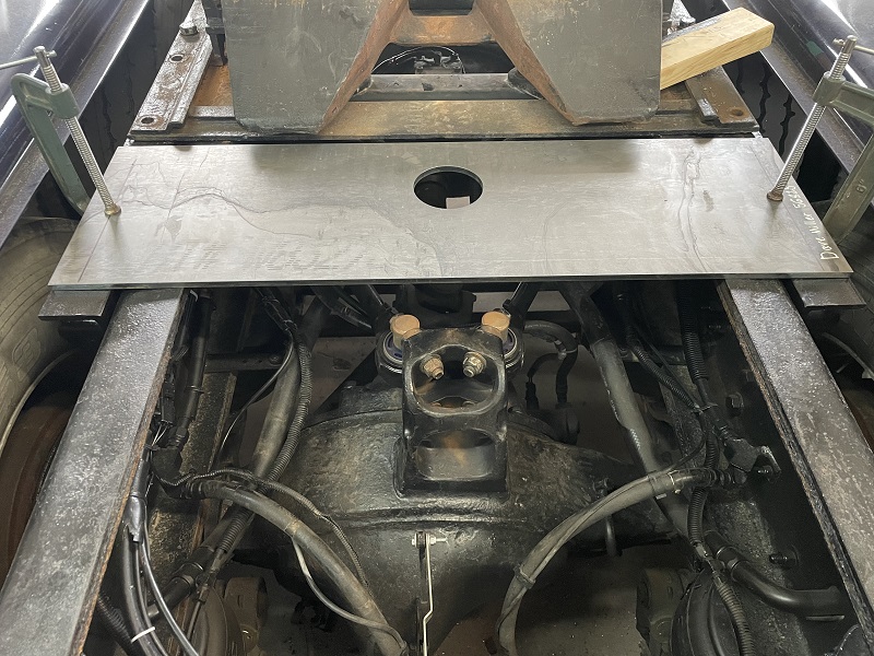

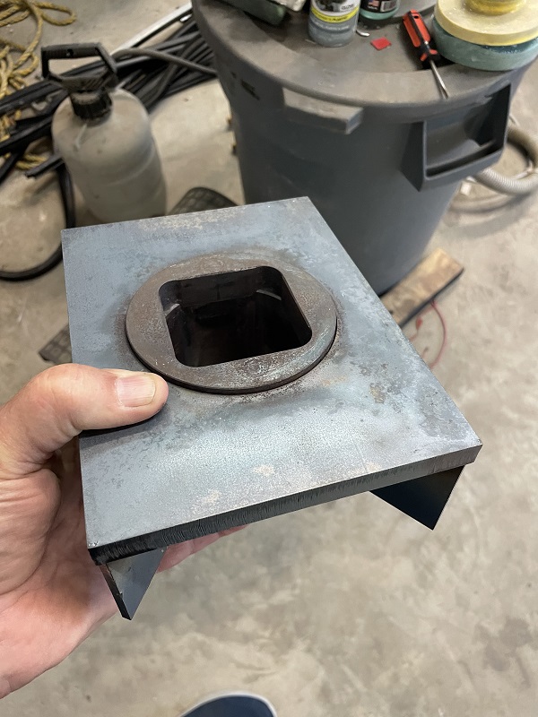

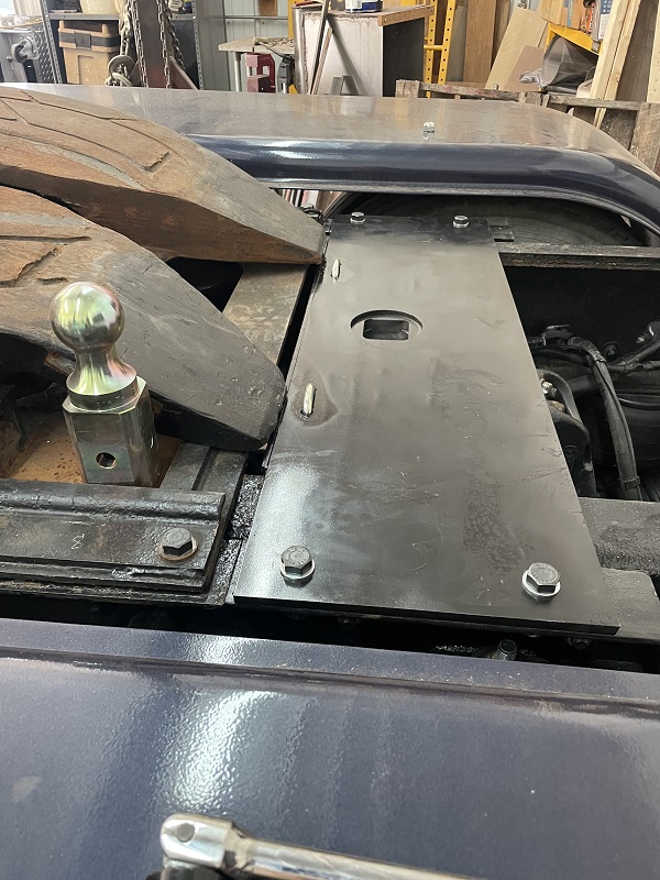

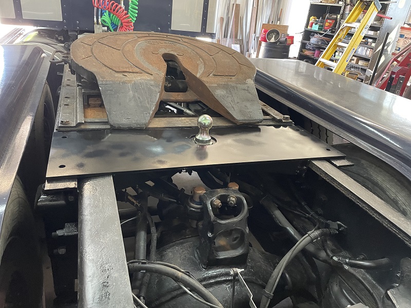

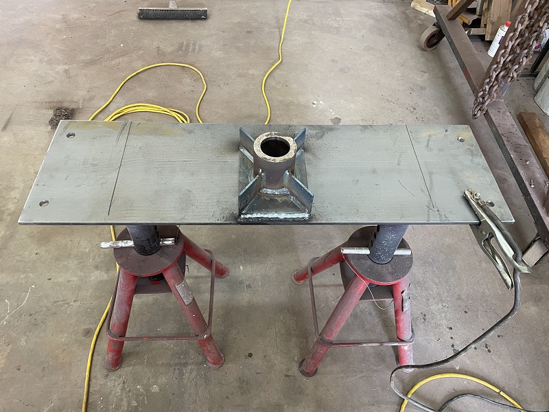

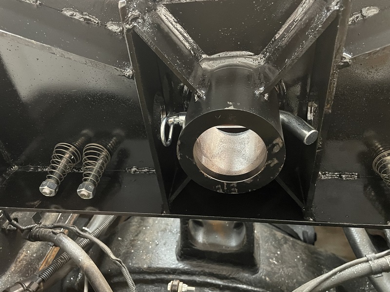

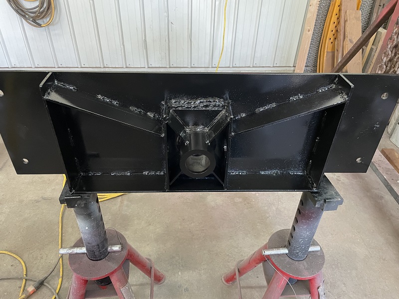

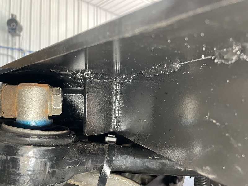

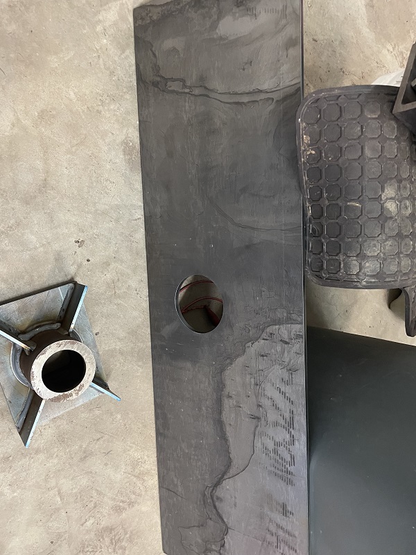

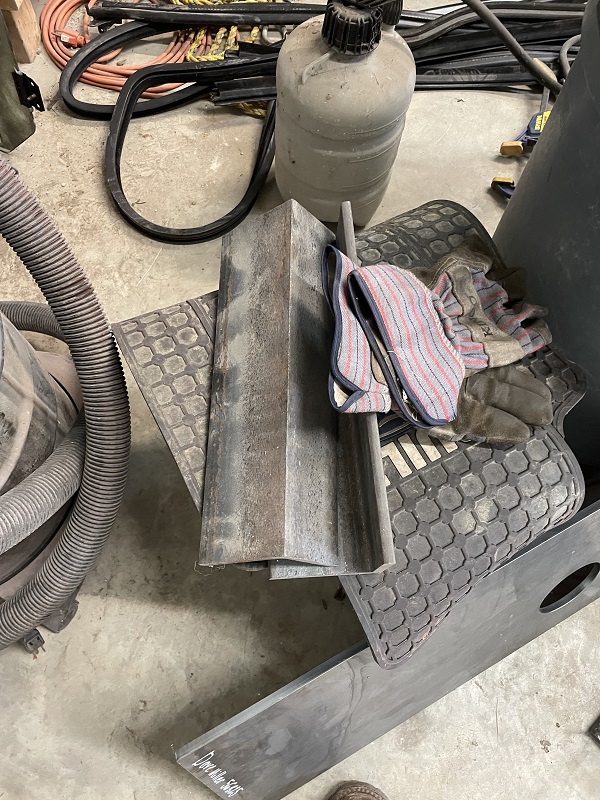

Rains put me off work today so worked on Hitch, down to awaiting on bolts have ordered.
As progressed
Angles installed yesterday and plate drilled on truck to 5/8", side note, the drillings are set to the same repeat pattern of 4" and 8" stagger on the fifth wheel table, that is in keeping with original intent to set fifth wheel rearward just at 12" when bought those angle irons.  Plate was ordered 40" width for the installed Angle Iron dimensions.
Next was fabricate the hitch
Are 2" diameter holes on each side brace against new hitch pocket, was trying to determine how to use the supplied release, then decided a Conventional Cat4 hitch Pin was the ticket as not intending to swap the ball a lot and pin area is relatively accessible for truck rear so no need for the Under Bed release as on flatbeds.
Top of hitch is still devoid of Chain Loops, ran out of steam today
The reason for ball location toward front edge is clearance to the Torque Rod attachment on third member, the air suspension on the truck has a Dump Feature and that comes up pretty close as reaches axle stop blocks.
Is still one foot further rearward to center of ball than center of Fifth Wheel pin at full rear stops.
Edited by DMiller - 29 Jul 2024 at 7:19pm
Points: 33642
Post Options Post Options   Thanks (0) Thanks(0)   Quote DMiller Quote  Post ReplyReply Direct Link To This Post Posted: 04 Aug 2024 at 12:13pm
As of this morning, All is Complete.  Hitch and Bolting for Fifth Wheel all done.  Ride height is a Tad High, 43", can decrease bag height by 1/2" and trailers on Torflex axles have Dexter Sponsored 2" Risers possible so would be back to around 41 1/2" of Goose setting.  Fifth Wheel still functional and suspension at full dump does Not interfere on New Hitch.
Ball retention has been settled to a Reese Hitch Pin.  Seems to Semi Lock the pin inside the bore as must be swiveled Up on angle bent end to remove.
