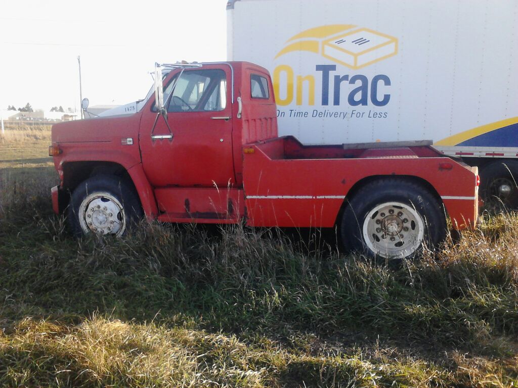

Got myself a new trailer puller. '86 GMC c7000. Goodwrench 366 with low miles. 6 good tires. $1000!
Problem is a couple of the brakes lock up.
Previous owner had already replaced the master cylinder and one rear caliper and hose.
Not sure if the problem is the caliper or bad hose. After brake locks up, I crack the bleeder and it releases easily.   Thinking if that caliper was bad it wouldn't release easily. That leads me to believe that the problem is the hose. I can get calipers from O'Reilly's for $78, so cost isn't bad. But don't want to spend the money if not necessary. Just wondering what your thoughts are on this.

that's a cool looking truck! old wrecker?

Yep, it used to be a wrecker. May have to remove a couple of springs from the rear, because I don't plan on pulling that big of load with it. I will save the springs just in case I ever do need them. Been set up as a trailer puller. Already has electric and vacuum trailer brakes set up. Heavy duty gooseneck plate already installed.
Only a couple brakes lock up, so not the master cylinder. Figure I'll start with replacing hoses first, because they're cheap when doing process of elimination. Hate to spend $80 a caliper if they're not the problem.

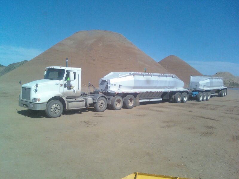

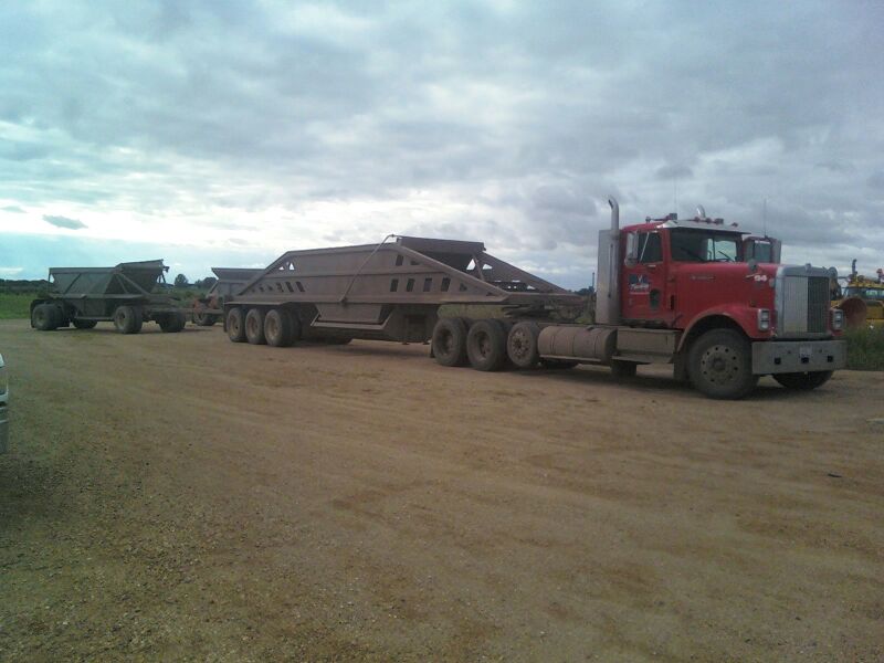

Don't worry, I want all the brakes working properly. I used to pull oversized loads. Double trailers, #142,000, 112' long,for 7 yrs so,yeah, I know how important brakes are. I also learned not to depend on brakes, downshifting is you friend.
truckerfarmer View Drop Down
Joined: 26 Jan 2013
Location: Watertown, SD
Points: 3292
Post Options Post Options   Thanks (0) Thanks(0)   Quote truckerfarmer Quote  Post ReplyReply Direct Link To This Post Posted: 07 Nov 2016 at 6:38am
Couple of the trucks I used to drive just so you fellas know I understand the importance of brakes. I did the brake jobs on most of the fleet.
Actually I wish my new toy had air brakes. I can do most of them with my eyes closed.
