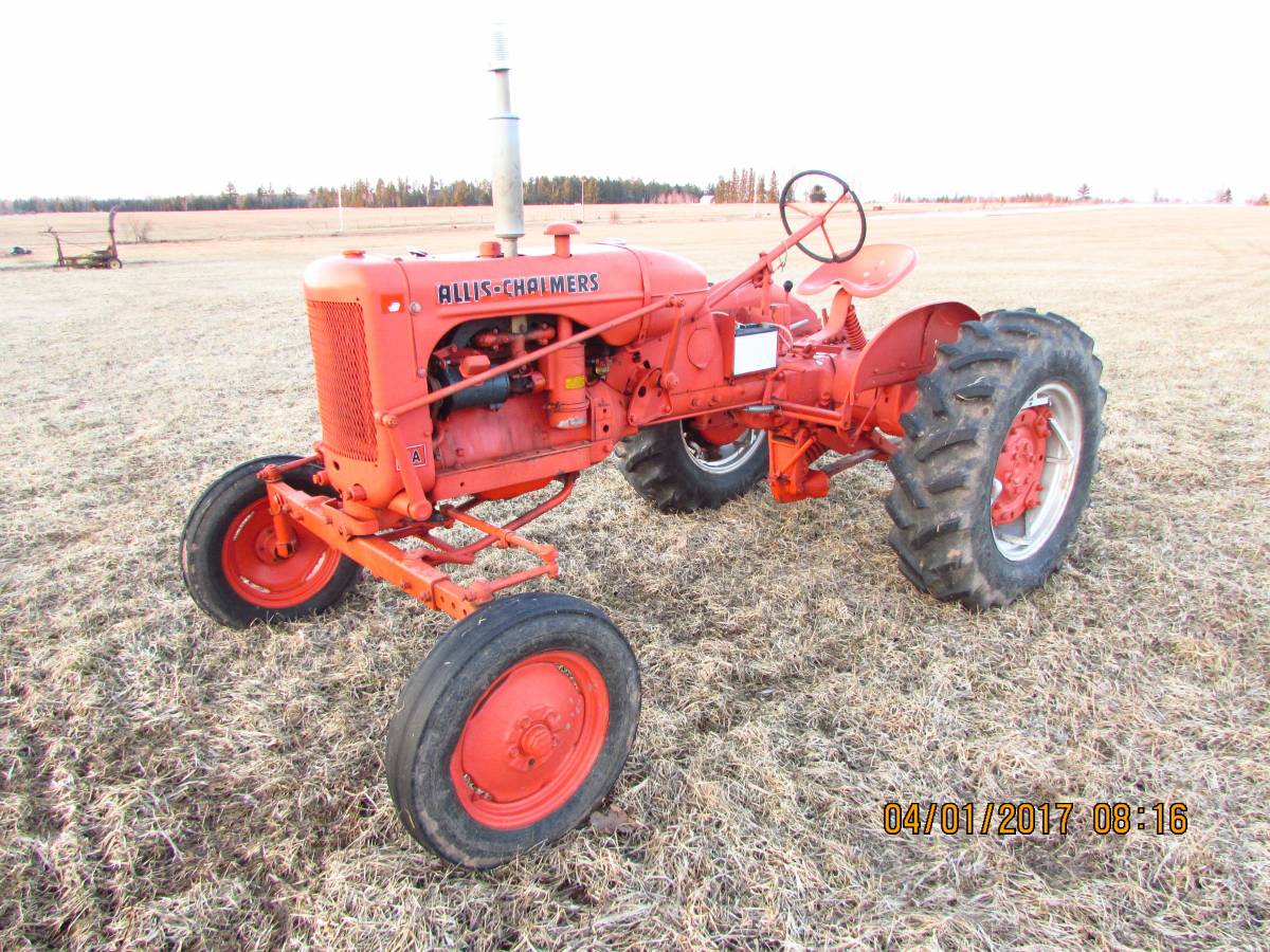

Asking is 1800. New tires. Current owner has used it for 4 years for haying and general use. All pics show good body and paint

$1800 is on the high side for a CA. For that price, it should be in excellent condition with everything working.

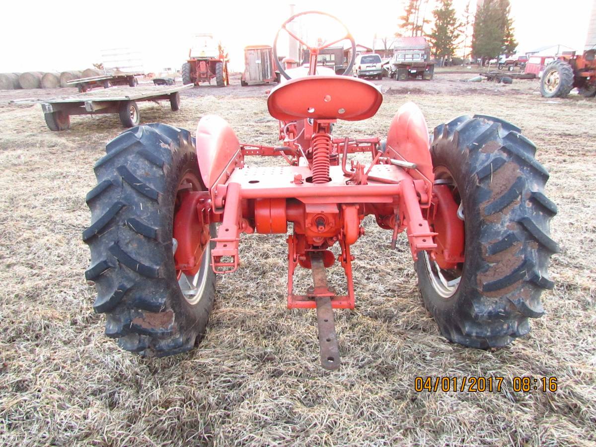

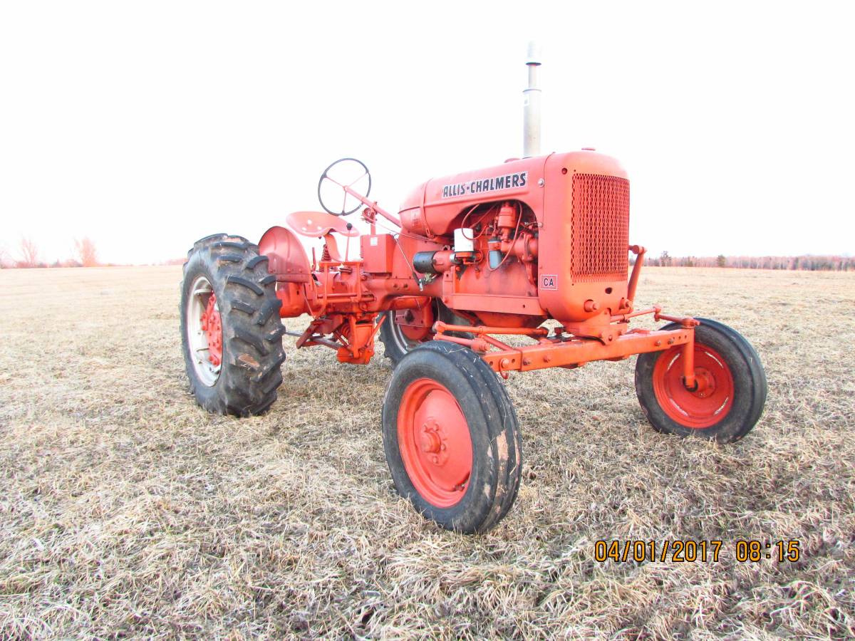

Post Options Post Options   Thanks (0) Thanks(0)   Quote bramdad Quote  Post ReplyReply Direct Link To This Post Posted: 11 May 2017 at 2:37pm

Post Options Post Options   Thanks (0) Thanks(0)   Quote GregLawlerMinn Quote  Post ReplyReply Direct Link To This Post Posted: 11 May 2017 at 3:34pm
Looks like a decent CA for 1800. A good CA is a great tractor that will work all day on 5 gallons of fuel. Remember to turn on the pto to check the hydraulics (the lever thru the floor pan under the seat on the left side). You can purchase a 3 point adaptor from several of the vendors on this site; great folks who will help you out. I have welded ears to the rockshaft for the top link; Just be sure they are up fully when attaching them so they don't hit the seat.

Post Options Post Options   Thanks (0) Thanks(0)   Quote WF owner Quote  Post ReplyReply Direct Link To This Post Posted: 11 May 2017 at 3:51pm
The hand clutch lever is missing.

Post Options Post Options   Thanks (0) Thanks(0)   Quote jaybmiller Quote  Post ReplyReply Direct Link To This Post Posted: 11 May 2017 at 5:03pm
It looks like a nice CA( yeah, I had one,sniff..) but I don't like the spray paint on the distributor cap,wires and rad. If she starts and runs good ,1800 is kinda high. I'd try $1300, secure seal at say $1500.as no working hydraulics.
Rebuilding the pump is easy, just have a CLEAN, well lit workbench ! I spent couple hours looking for one of them itty bitty check balls( ball bearing) that kind fell onto my concrete floor. I do remember needing to clean a 4th ball int he 'front' side of the pump, after that,she worked like new. Cleaning out 50 years of sludge from the sump probably helped too !!

Post Options Post Options   Thanks (0) Thanks(0)   Quote Dave(inMA) Quote  Post ReplyReply Direct Link To This Post Posted: 11 May 2017 at 9:04pm
As noted, it's missing the hand clutch lever. Likely means that the hand clutch is inoperative - which means that you can't stop the tractor's motion without pushing in the foot clutch and thus also stopping the pto. Which could be an issue if you are brush hogging with it. Would not be an $1800 tractor for me - maybe half that? But value is in the eye of the buyer. LOL

Post Options Post Options   Thanks (0) Thanks(0)   Quote LeonR2013 Quote  Post ReplyReply Direct Link To This Post Posted: 11 May 2017 at 9:44pm
Looking around at his other equipment he doesn't spend a lot of money on maintenance but the little tractor could still be basically sound. Oil pressure good, no rattles or knocks,no smoke at start up, doesn't jump out of any gears, steering is tight, brakes good. Just look at as if you were buying and old car for your daughter to drive to school. I did notice the broken lug bolt on the left front, no headlights, and the shutters are  missing if originally equipment, both lift latches are missing their springs and the top half is gone on the RH one. Go to an Allis swap meet. The guys there will surprise with what they have. At the meet at Booneville I saw several pumps there for the CA. The condition of rear tires are a big plus. But agree with the others the price is quit a bit too high and if he won't move very much, leave your name and # and move on. There are others out there. They truly are an amazing little tractor. At their size there are none better.

Post Options Post Options   Thanks (0) Thanks(0)   Quote Dakota Dave Quote  Post ReplyReply Direct Link To This Post Posted: 11 May 2017 at 10:16pm
Looks good in the pictures. A little grim on the engine is good means it's wasn't pressure cleaned just for sale. Has new tires. A $1300 CA wil need $ 1500 in tires to be a good tractor. The hyd pump is very easy to work on and has very little to go wrong. Drain the rear pull 4 bolts an a couple cotter pins and take it to your bench. The hand clutch missing isn't a big loss for me. I rarely use mine and think it was a bad design .three point ad peters are easy to come by but anything heavy will make the front uncomfortably light. My CA only sees morning duty. At one time it did every thing except mow. I still have the loader mounts installed they make a great step for climbing on and off. But the last time the loader was installed was several years ago. I needed two loaders to lift a 16' selfpropelled swather sideways on to my trailer.

Post Options Post Options   Thanks (0) Thanks(0)   Quote Brian Jasper co. Ia Quote  Post ReplyReply Direct Link To This Post Posted: 12 May 2017 at 12:22pm
$1800 isn't out of line for a nice CA. There's nearly $1K in new tires on that one. Those definitely are not 11.2's. Looks like 13.6's as tall as they are.
