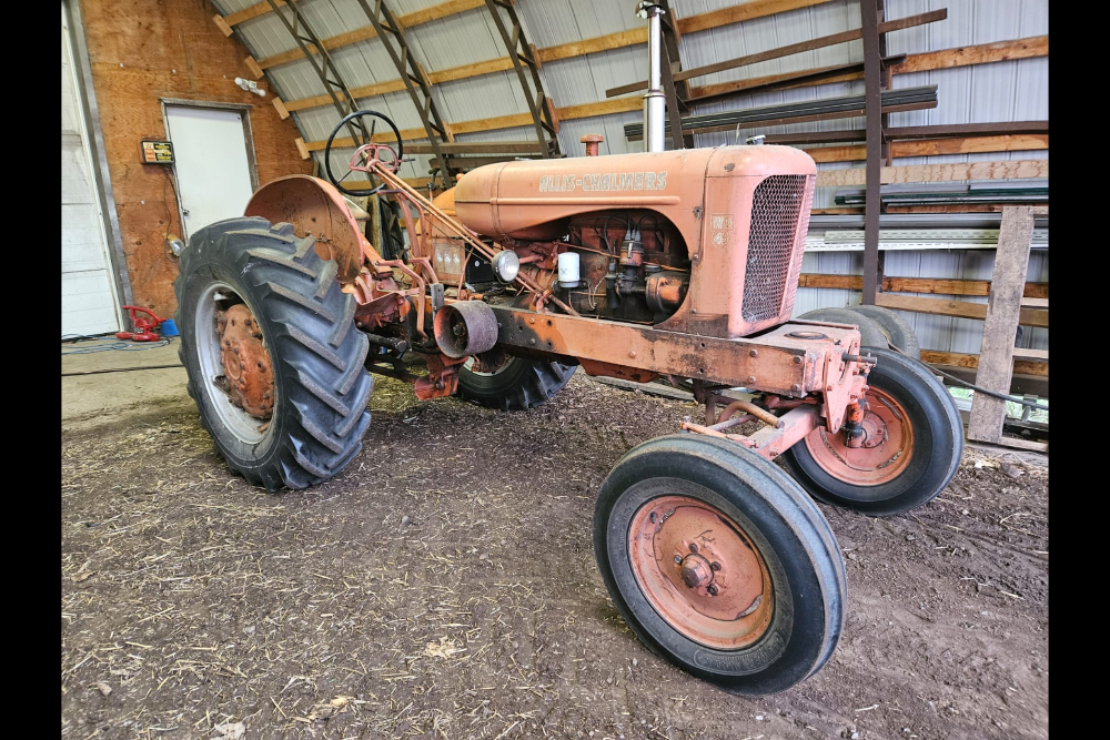

Hello everyone. I am new to the forum and this is my first Allis. I have had a couple Farmall B's and have had a lot of other things with engines that were a lot of fun.
So, I purchased a 1955 WD45 from a friend. I have a few questions.
It comes with a front end loader as well. I have plans to build a 3 point hitch for it. Mostly this thing will be cultivating sweet corn in central Alberta
Most everything works well on it, as long as the battery is charged, it fires up really, really well. Albeit it does turn over a little slow.
How do I test if my generator or regulator are bad? If it isn't too much work to fix and too expensive then I plan to leave it 6 volts instead of converting it to 12 volts.

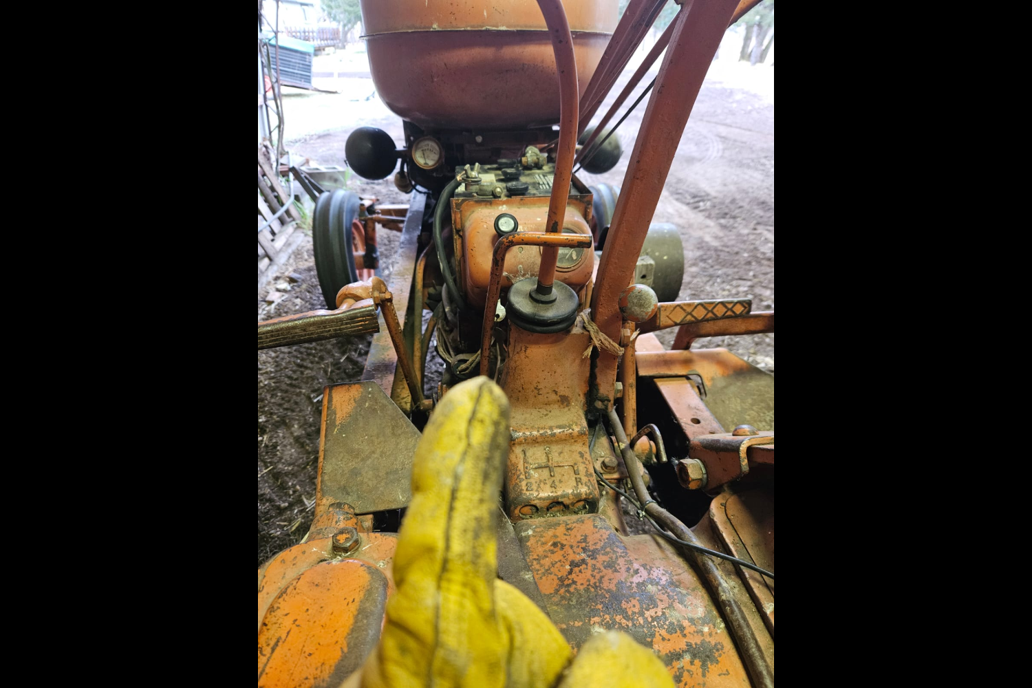

Also, there is a small lever right behind the gear shift, what is that lever for?

Push on that lever and it disconnects your snap coupler hitch underneath. Look at the bell shaped thing that the drawbar pushes into. Take out the 2 side pins on the drawbar, push bar ahead a bit, push on that lever and drawbar falls on the ground.

Round knob just to right of steering support is the pto engage/disengage.

Are you talking the lever to the right of the gear shift?  Has a bend in it about 90 degrees?
  If so, that is for putting the brake lock on.  When you push the brake pedals down, you pull up on that lever and it locks the brakes in place.  To disengage, just step on the brakes again and then push down on that lever to disconnect.  HTHs

That's a nice straight original 45 !! This forum can answer any questions you have. You will love that tractor! That ground cable looks big enough but the end connection looks looks poor. That won't help cranking. 6 volt systems are slower sounding than 12V even when all is good.

Welcome to the forum! Like SteveM said, that's a good looking 45. Ted is correct on the brake lock lever.

Thank you all for your help. Last night I went out and figured out that the lever I was referring to was to unhitch the drawbar. But thank you all for answering.
I do still need to figure out how to engage the side pulley. I am debating of running a hydraulic pump off of that to run the front end loader and add remotes.

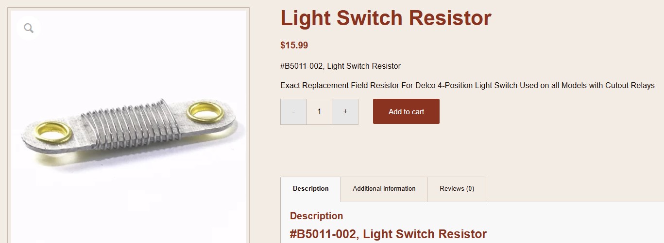

So, I have a 2 wire which means it would be a cutoff switch. Can I replace the light switch with a simple push pull switch from the local parts store? Does it need to be a 3 position?
WF owner View Drop Down
Joined: 12 May 2013
Location: Bombay NY
Points: 5147
Post Options Post Options   Thanks (0) Thanks(0)   Quote WF owner Quote  Post ReplyReply Direct Link To This Post Posted: 01 Nov 2024 at 11:08am
The short answer is no.
The original light switch has a part (I believe it's a resistor) that can vary the rate of charge the generator is putting out. If you put in a regular push/pull switch, it would not charge at all. If you hooked it direct, there would be nothing to stop the generator from overcharging the battery.
Replacing the cutout with a voltage regulator solves that problem and isn't very expensive. It also saves the operator from having to remember to set the switch in the proper position.
Click on this link to see what the original switch looks like:

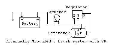

The CUT OUT is just an ON - OFF switch that closes when the engine starts to let the generator charge the battery.. The swith OPENS when the generator stops turning / engine off..... You have no REGULATOR for the system.. So they put a 3 OHM resistor on thel ight switch.. When the lights are OFF, the "F" wire of the generator goes thru the resistor to GROUND and the generator puts out about 3 amps... When you turn on the LIGHTS, you bypass the resistor and the "F" wire goes straight to GROUND and you get about  8 amp charge.... You "COULD" just buy a 3 ohm resistor (BIG) and connect the "F" wire to it and ground it and that would work...
If you buy a VOLTAGE REGULATOR, it has a CURRENT REGULATOR inside.. it will have 3 terminals  "F" ,  "G" ( generator ammature), and "B" for charge... This eliminates the LIGHT SWITCH and you can then use a TOGGLE switch for the lights..

this will be on the back of your original light switch... you can use it, or buy seperate if you want to eliminate the light switch and keep the CUTOUT.
