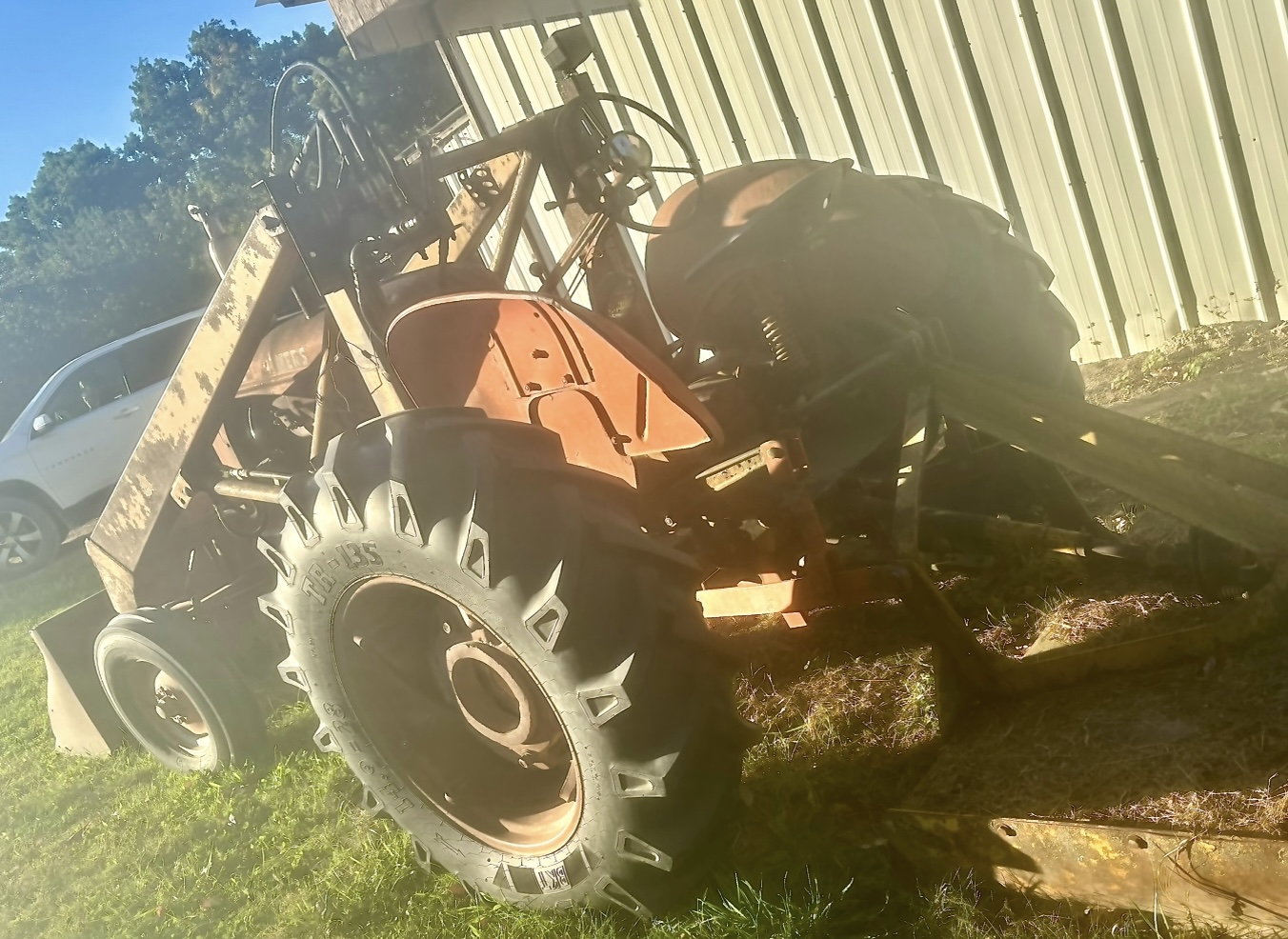

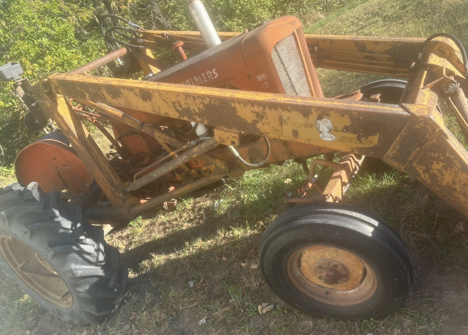

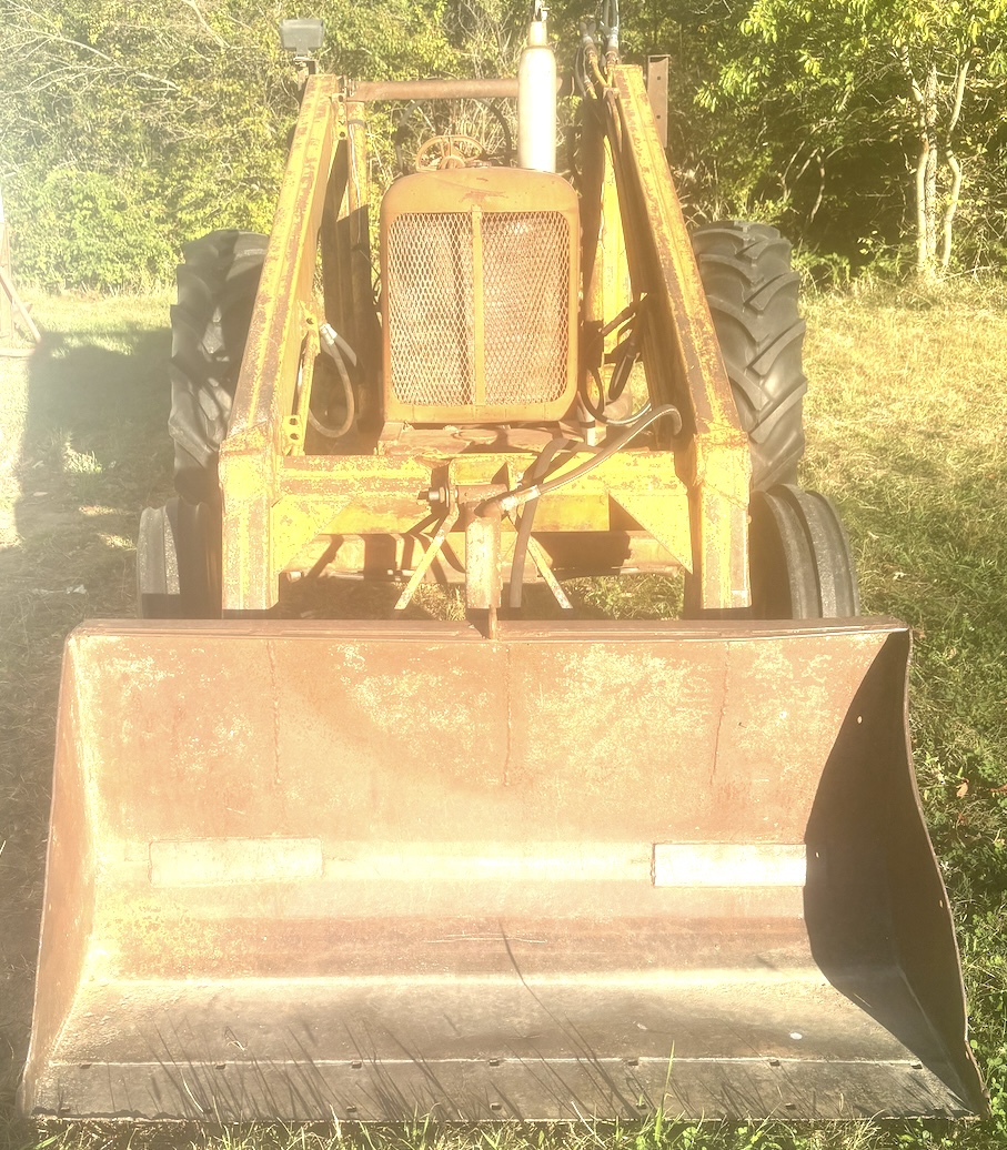

Best I have right now.
There is an alternator conversion.
Rear tires at new maybe a year old. Fronts have some mild cracking but are in decent shape.
Thanks for the info on the fluids.
The rear 3 point lift : black knob below steering wheel operates PTO, left handle above steering wheel is the lift for PTO.
I’m going to talk to the owner today and try to make a deal. The plan currently is to try to drive it the 15 miles home because I can’t find anyone with a trailer wide enough that is available.   I’ll check all the fluids before I leave and will disconnect the mower for the drive. It’s all back highways and it’s harvest time so people around here are used to tractors on the roads and shoulders. I’ll be able to take gravel for about 1/2 of the drive. I’m actually looking forward to it.     I’ll get more pictures the next time I’m out there.

roading 15 miles to get equipment home... Been there , done that, no problem !! Thumbs Up
jvin248 View Drop Down
Joined: 17 Jan 2022
Location: Detroit
Points: 500
Post Options Post Options   Thanks (0) Thanks(0)   Quote jvin248 Quote  Post ReplyReply Direct Link To This Post Posted: 09 Oct 2024 at 12:58pm
Those rear tires greatly increase the value of that tractor.
Drive with the bucket low to keep your center of gravity low for high road speeds.
Get a slow moving vehicle sign mounted visibly. Chase vehicle with blinkers is good too.
See if the seller has any other old iron in the weeds/woods like plow disk cultivator planter that fit the tractor and strap it on the mower deck. Anything may help next spring. Old carb etc on shed shelf can help later. A lot of these trinkets get junked in that kind of move and you can use them. Worth asking.
