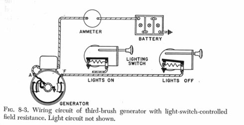

i am trying to replace the generator, cut out, and control switch on a B 6 volt positive ground system.  all above items I have but there are no old wires to go by. can anyone help with a diagram ?  thank you for any help.

I found this diagram helpful and then did a search for third brush or three wire generators and found lots of information in the antique cars sites too.
My wiring was correct but it turned out the alternator had a bad winding and was cheap to repair at a good shop.
