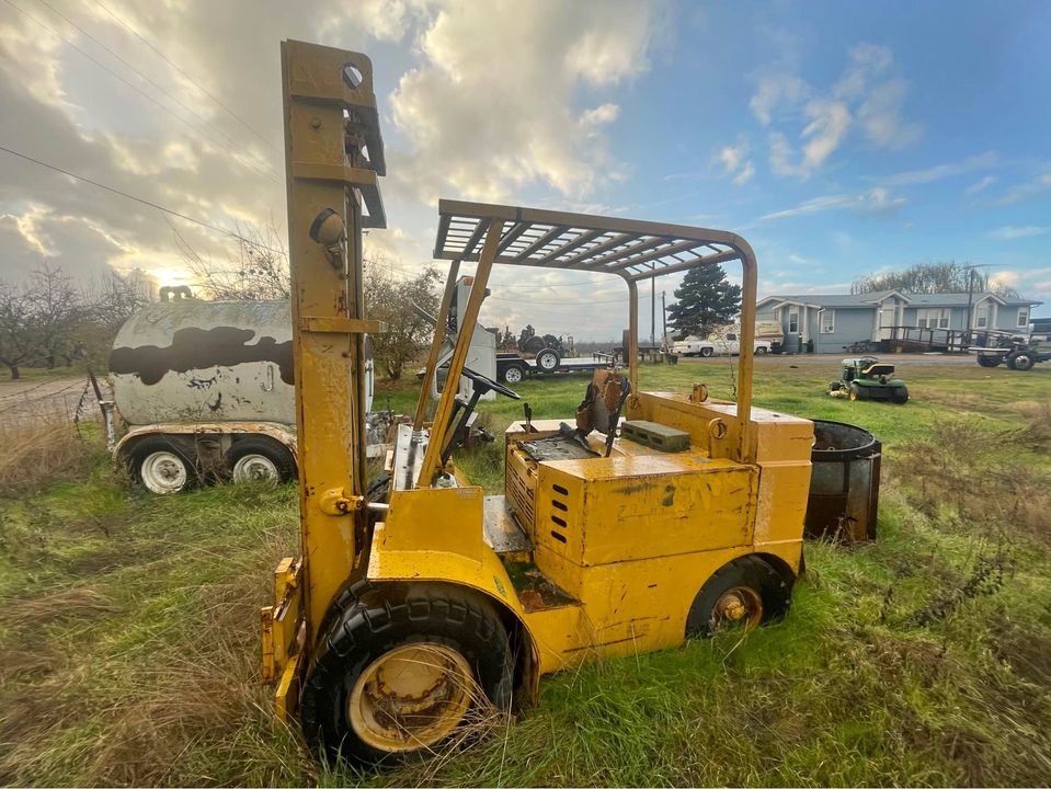

Hi,
Someone took my carburetor off my forklift.
It's on the ranch, I believe it is an ACP 60.
What is a good carburetor that doesn't cost an arm and a leg

Roger.... i may be all wet, but i thought the 60 had a Continental 6 cylinder F244 engine... Here are a couple carburetor numbers that were used on that engine..Maybe that will be a start to find something... Do you have a 6 cylinder Continental ??

was it a down draft carburetor --- looks like this ?? ................. or does it have the updraft manifold with a different carb ?

If this unit has the Continental F -226 or F-244 or F-245 -  a Zenith Model 62 carburetor and will be an updraft carb.

I believe the Continental is a 227

It has a downdraft

I think Steve has it covered then.  I have a Zentih Model 62 carburetor that is fitted to an old Continental F-244. Its an updraft carb.
The F-227 is not very different than the F-244 - slightly smaller bore.  You should be able to compensate on the load demand with the load and idle screws.
