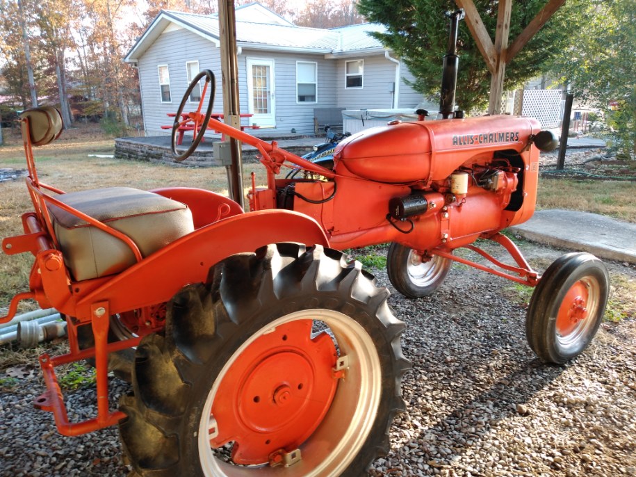

This is a picture I posted in my inaugural thread last year. It should show clearly the starter as it came with the tractor.
Points: 88422
Post Options Post Options   Thanks (0) Thanks(0)   Quote steve(ill) Quote  Post ReplyReply Direct Link To This Post Posted: 06 Nov 2020 at 6:07pm
YEP... with that starter, rear wheel rims, seat, backrest and drawbar..... there has been a lot of "modification" going on before you ............ NICE LOOKING TRACTOR !
What is the deal with the rims and bolts to the hub.... hard to see details in that photo.
Make sure the trans is in NEUTRAL when you push that starter button  !!!  Double check and check again !
Edited by steve(ill) - 06 Nov 2020 at 6:09pm
yes, even though I know it is, I always check that shifter stick. The tractor looks nicer now, than it did then, with a clean head, cleaned up thermostat housing and cleaned up magneto case.
I should just go all in, but right now I want to get it back to starting reliably. I think I have some magneto work to do, it does not want to start after installing the new starter. My neighbor and I checked spark on each cylinder.... barely registering any at all.  I put new points and a condensor in, but still no spark. It is timed correctly, using this guide:
