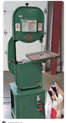

What band saws do you guys use?
Like the price point but have seen some negative reviews to it being China Built
More money but probably a little better quality
What do you guys think?
