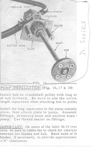

   Hey Guys,,,Lookin ahead some,,,I posted an ad in the classifieds some time back but didn't find what I wanted, so I'm wonderin if anybody has done this.
   On my D14, the splines on the 13" driveshaft that drives the front mounted pump were wallowed out at the 4 bolt flange on the crankshaft end. I looked everywhere and never could find a replacement of the right size, either new or used.
Has anybody used one of the 3 jaw style Lovejoy couplings on their tractors,,?? There just ain't much room there for a very big anything other than the original or maybe this Lovejoy style,,,????
Thanks for any and all help.

Joe stiners sells an adaptor which will bolt right onto your crank shaft pullie and take the six spline shaft from the Ford tractor.   Just call them with the spacing between the bolts then buy the Ford shaft and either extend it yourself or have a machine shop extend it. That is what I did with my d17 and d15.   No one around here wanted to cut the splines but they where happy to cut the shaft put it in a lathe and add a section to make it longer.
Those love joy couplers won't work for anything more then about 12 hp on the front of your tractor it will run the hydraulic pump for about 6 weeks before it falls apart... you need the spline shaft on the crank end to allow the motor to rock and the shaft to slide in and out just a little and the double roller chain on the front to take the force and fit in the space infront of the tractor between the motor and the pump. Surpluse center has the roller chain setup but you have to be careful to buy the really small one or it won't fit.

http://www.steinertractor.com/ABC1809-front-hydraulic-pump-drive-hub-adapter?CID=ABC1809&gclid=CJe66-DF1MoCFYEfHwod_TQAfQ
Joe you want one of these but make sure you check the centerline spacing between the bolts. They have the right one to match your d14 j just don't remember the bolt spacing.

Is this what you are looking for ?
I have these links saved in my 'favourites'
Gary
Hub:
Shaft
http://www.steinertractor.com/ABC1814-front-hydraulic-pump-drive-shaft?&TF=8EF74A6D4D48

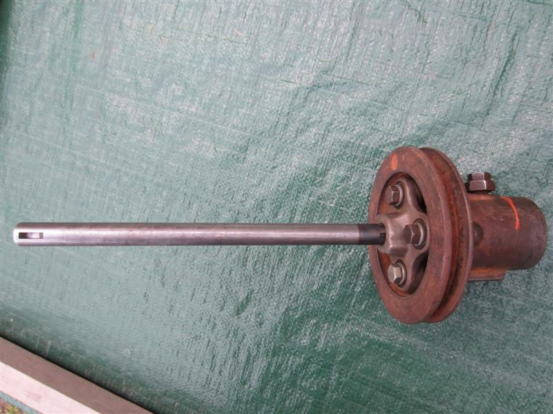

crank pullie
front pump drive hub
shaft
That is the set you want but the shaft is too short. It was cheaper for me to buy the short shaft and have it extended don't know why but no one I talked to a few years wanted to cut the splines.

I bought the 13" X 3/4" shaft which had 6 splines on one end and a keyway on the other along with the crankshaft adapter from e-bay about 3 years ago for my D-17.
The holes are  7/16" and the spacing is 2-3/4" which is a direct bolt-on to the D-17 crankshaft pulley. Both items together cost me $66.04 including S & H.

DANG,,,lots of great info ,,,,The shaft on this tractor is 1",,,13" long with a 1/4" keyway and a sprocket at pump end. The crankshaft end is a 4 bolt hub that is 4" OD and bolt spacing at 2 3/4" with 3/8" bolts (7/16" bore),,,and according to one of the Guys is same as a D17,,,???
   If I switch to the 3/4" shaft,,I will have to buy the hub, shaft and a new 3/4" sprocket,and prolly the dang chain as well!!!,,,,may have to but I'm still lookin,,,,,,
In lookin at the Baum Industrial catalog that Brian mentioned,, there is a weld-on spline bore,,,but the OD is too big and would get into the bolt holes of the hub,,,,CHIT,,,,,there is also a square bore weld-on that might be promising but I could not find the chart that listed the dimensions,,,,,
I'm also thinkin,,, and let me throw this out there for the GURUs,,,,,How bout I machine out the splines in the hub and make a short "stub shaft" with 4 flats and weld this into the hub,,,,,then,,,machine 4 flats on the shaft,,,and make a rigid coupler bout 4" long with 4 allens at each end,,,,??? TEN FOUR,,,????

Joe why not buy the shaft setup I showed and then when you have it extended just weld on the end you need to match you current double roller chain? It was the only option I could find about 3 years ago. And yes the same setup from crank pullie out with different lengths of the shaft are on my d15 with a 160 engine and the d17 with a 226 not sure if the 149 is the same or not.
